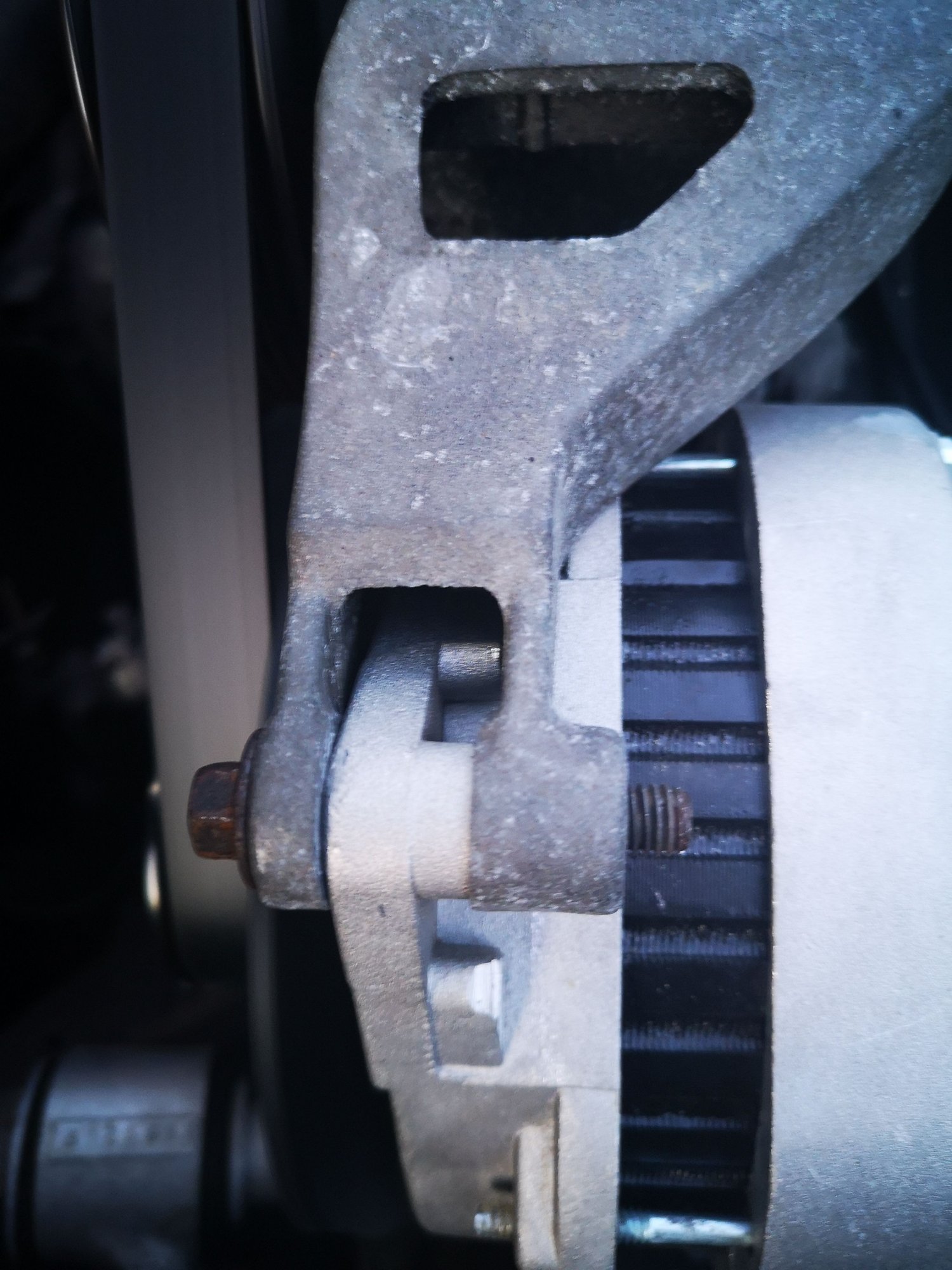

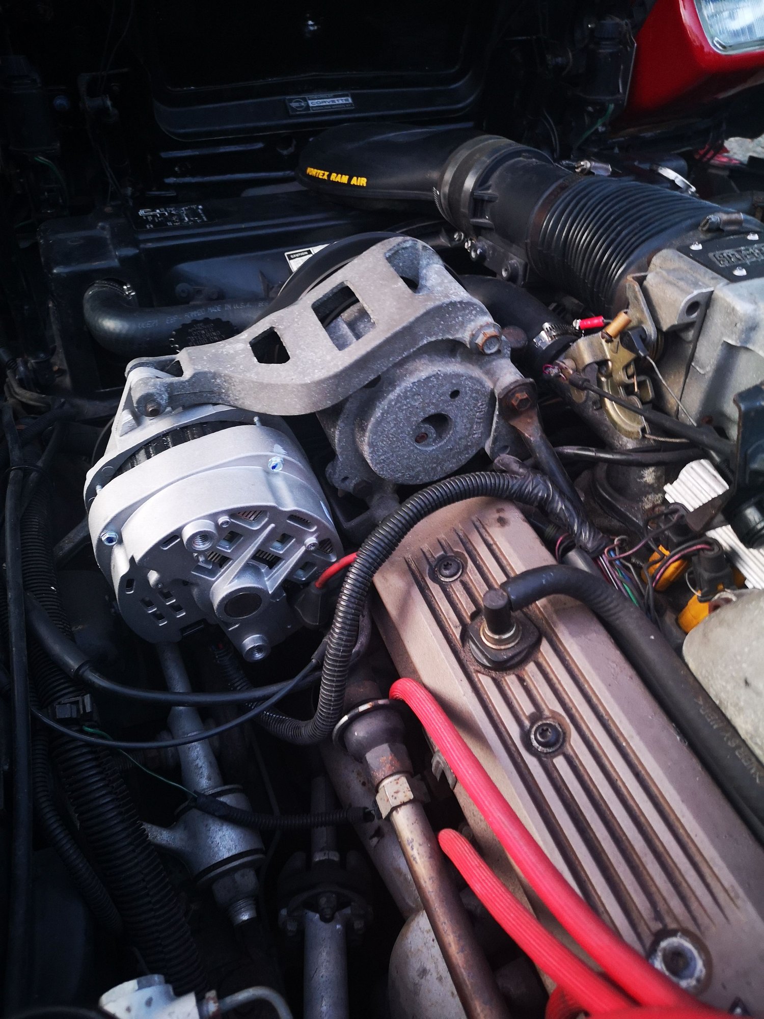

check out the conversion to the CS144 alternator instead of CS130, i fitted one to my 89 Coupe and it has eliminated all of the low voltage issues, apart from filing down one of the upper mounting lugs to fit the bracket on the 89, it is a drop in replacement, went for one for an 1997 LT1 Camaro got it from Rock Auto.
Here are some photos of the new installation

That CS-144 alternator needs a rear brace...
