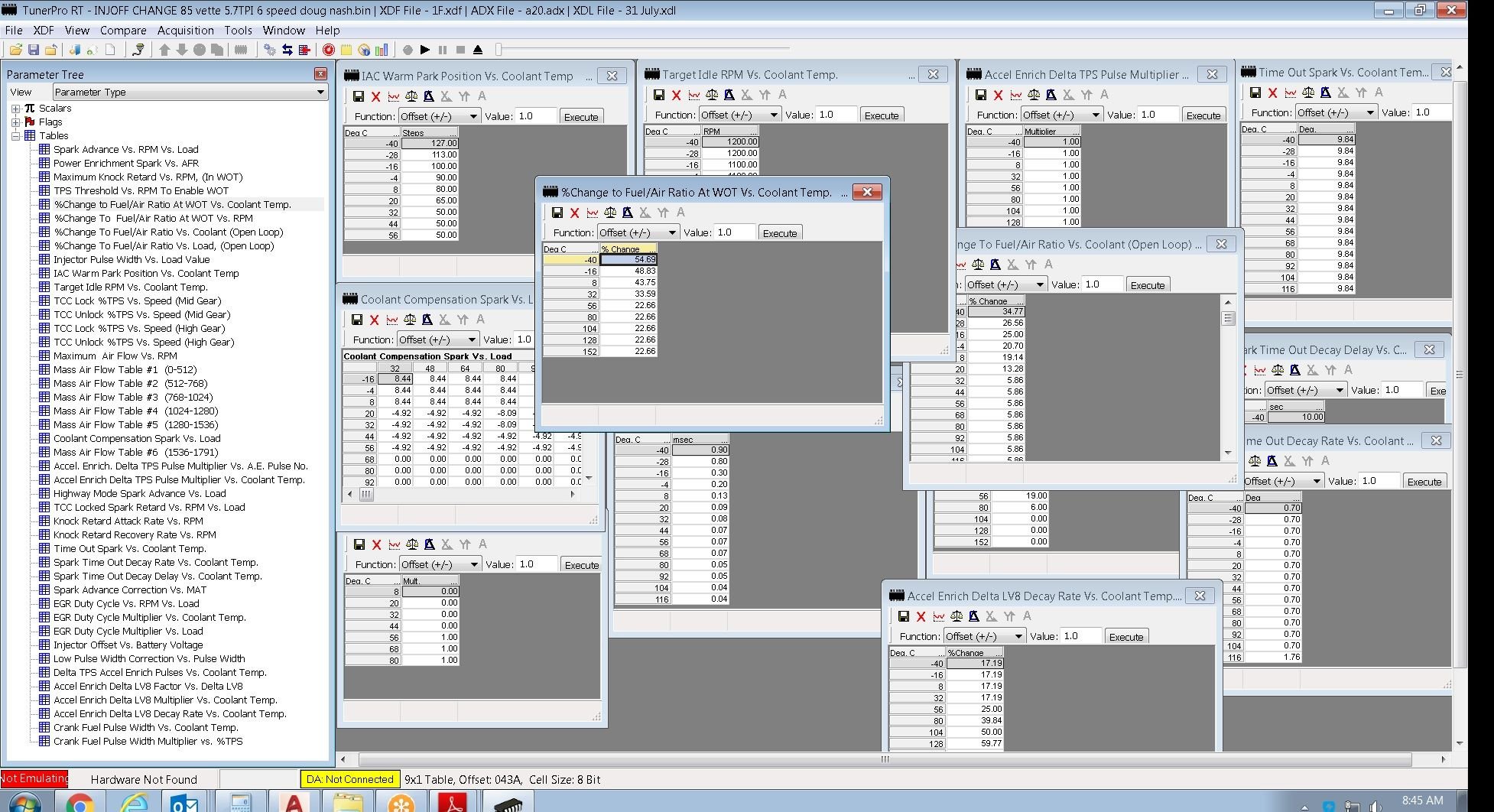

I believe you and @ctmccloskey are both correct just talking about different things. You are correct about the CSI, but it is only powered during cranking. However, many portions of the .bin have tables that are affected by the CTS. In fact there is even a table for Crank Pulse width versus Coolant Temp since the CSI is only used at low temps during cranking. Just for reference, here is all the tables in the .bin that compensate based off the CTS for an 85:
The CTS affects fuel, spark, and engine speed including adjusting the target AFR based off temp. So, if the engine is actually at 180*F but the CTS is saying its 50*F, you will be running rich in any condition, not just at cranking.
