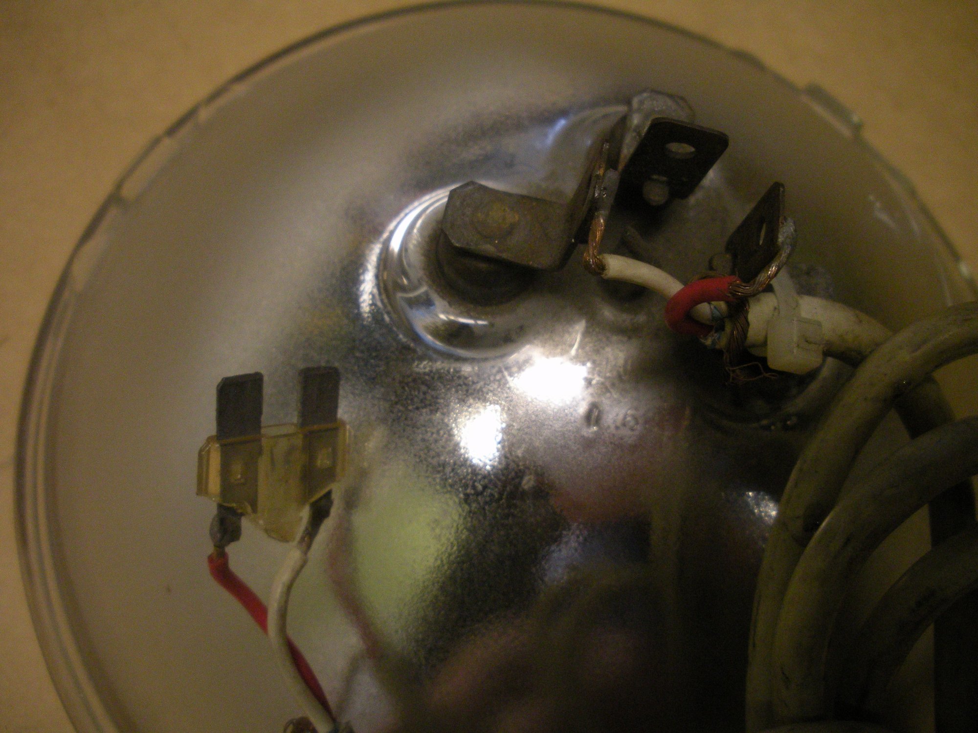

Short circuits can be frustrating to chase down. You want the power on, but that blows the fuse before you can learn anything!
Here's my little trick: Use a headlight bulb wired to a burned out fuse. With this gadget plugged into the offending fuse location, the light will shine when you have a short, but nothing will smoke! You can disconnect things on that circuit until the light goes out.
To 89 vett electrical
