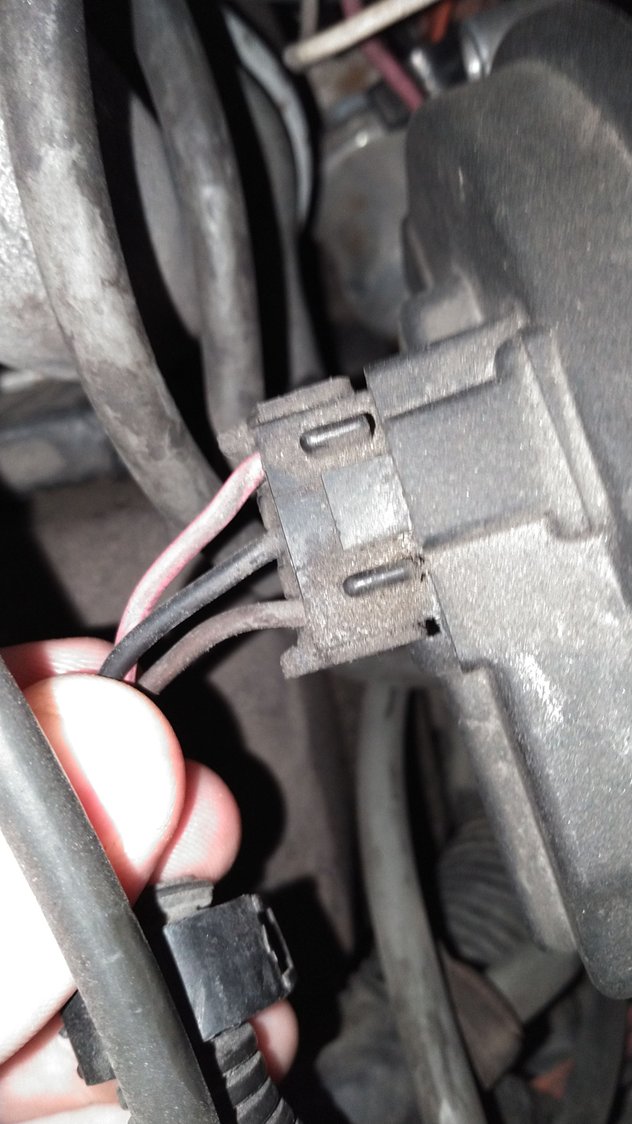

I'm at my wit's end trying to figure out what's wrong with my wipers. I have a 1988 coupe that I got a little while ago, and for some unholy reason the wipers refuse to work right. Whenever I try to use them, they only go up by a few inches and refuse to budge past that. I've replaced the wiper switch in the door, replaced the motor, and even the control board that goes on the motor, and it's still doing the same thing. Has anyone ever encountered this before? I guess it's something to do with the wiring but I have no idea what wires could be causing it, and I'm not the best at reading schematics.

Yeah, I tested the linkage and made sure everything was moving. I think it's related to the park switch in the motor somehow. I was able to get the wipers working on high only when I took that part out, but with the switch in the motor only works on low and pulse, it just refuses to move more than an inch or two.

Check to make sure you have the connector at the bottom hooked up.

Is the motor grounded by the screw? I thought it had a ground on the bottom.
All three connectors are in solid.

So I was checking the wire diagram, does the motor have two separate grounds? I know the black wires are ground, does the control module get a separate ground from the motor? The motor seems to work mechanically, it's the switch that's having an issue. Would a bad ground in the module prevent the park switch from working right?

Alright, I did as thorough a check as I could on the motor and such. Ground has no resistance, goes back to negative fine. I did a test on the wires going into the park switch and got no response, so there might be a break in there, it's the only thing I can think of. I tore into that corner of the engine bay to check the wires, got as far as the ECU harness but I wasn't ablt to actually disconnect the plug, it's way too tight. I didn't see any breaks along the wire bundle, though. Next weekend I'm going to try digging into the door or under the dash for the wires and see if I can fine out where they are. Does anyone know how the wire harness runs for the wipers? Does it go under the dash at all, or straight to the door?
