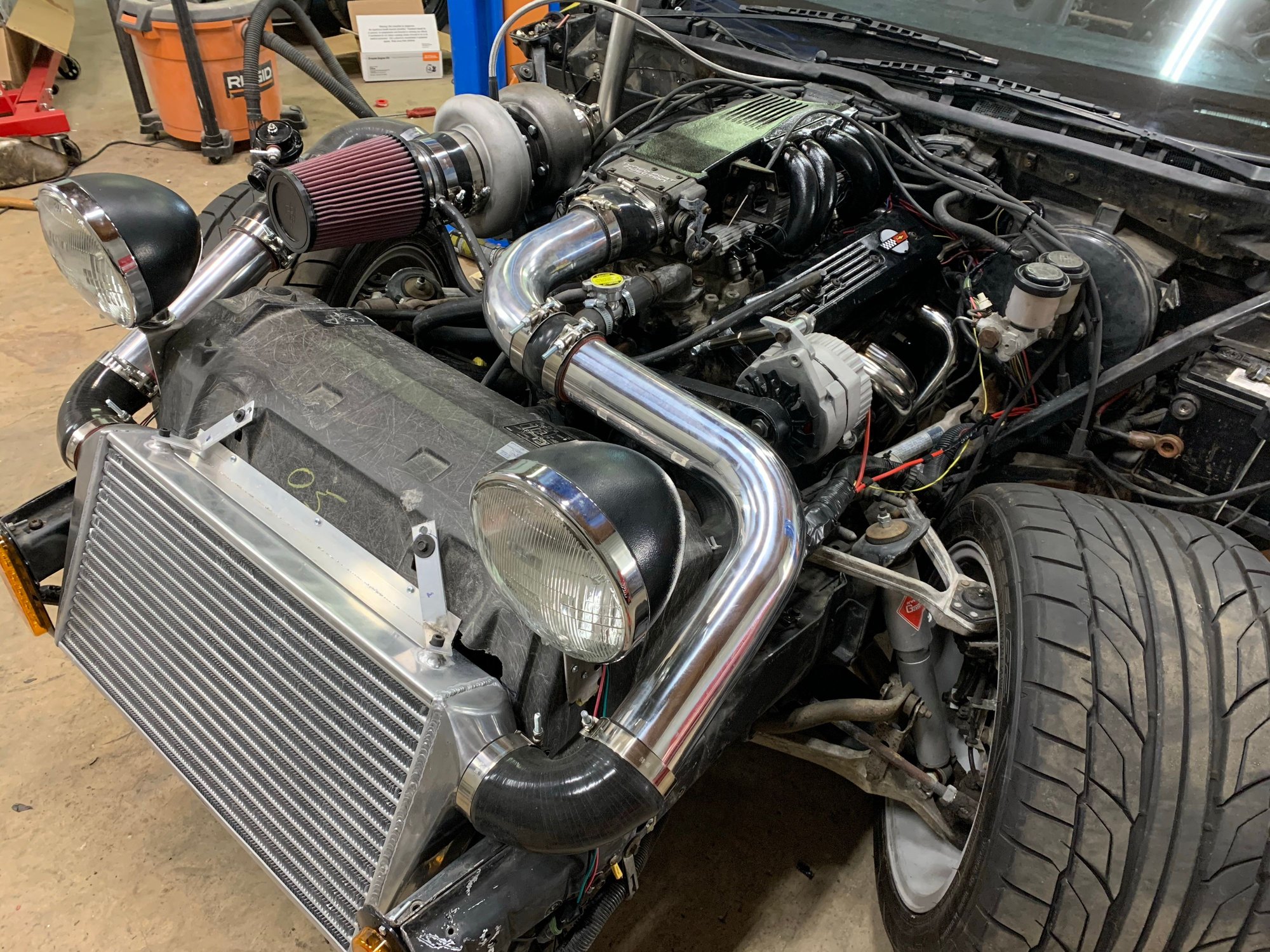

I’m running a bone stock (internally) 1990 L98 in my vette with a single GT45 turbo at 11psi making 360rwhp and 550ftlbs. It’s fun. It’s tuned very conservatively on a microsquirt EFI with good cooling and I expect it to last indefinitely in this form
fk yeah now youre talking!! Got any pics or build links?

Sure, here ya go! It’s great fun. Does burnouts at freeway speeds with stock 2.59 gearing.
