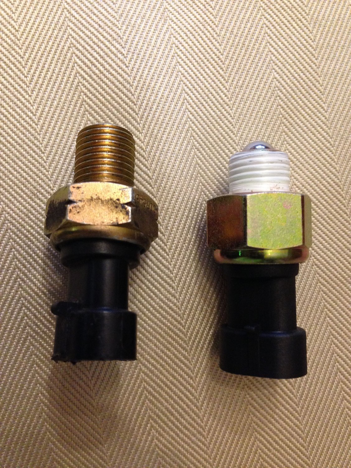

Hey guys I finally got back on getting this back up light switch fixed. I work slow. 1996 LT4 6 speed manual. So I confirmed it was the switch, ordered a new switch from Corvette Mods . Today I get the old one out and compare to the new one (see picture) and they are different. I checked my order to see if I ordered the right one and I believe I ordered the correct one. Not sure if they sent me the right one but maybe they did. If you look at the 2 switches the old switch has a 3/4" shaft whereas the new one has a 1/2 " shaft. So something is wrong. Could the wrong switch been in the car? Not sure if it means anything but I have had the car for 2 years and its always been a hard shift into reverse.
Anyway can anyone tell me what switch is the right switch?
Thanks
Dave
Switch that came out of car on left. New switch is on right (with teflon tape).

One on the left is correct.
Do NOT buy anything from Corvette Mods, they are the very worst Corvette vendor on the planet - do a search on this forum if you're not convinced.
The correct switch (it now has a pigtail, but the connector at the end of the pigtail is correct) is available from Zip Corvettes and Eckler's and maybe some others.

Thanks ram_g. I don't think there is any way the one I bought will work. Corvette Mods said it was for a 1988 to 1996 6 speed manual but not sure what its for. The electrical connector looked like the one that was on the car so I ordered that one. I'll go with one of the places you suggest and get the one with the pigtail.
I appreciate the help as I had no idea what the deal was.
