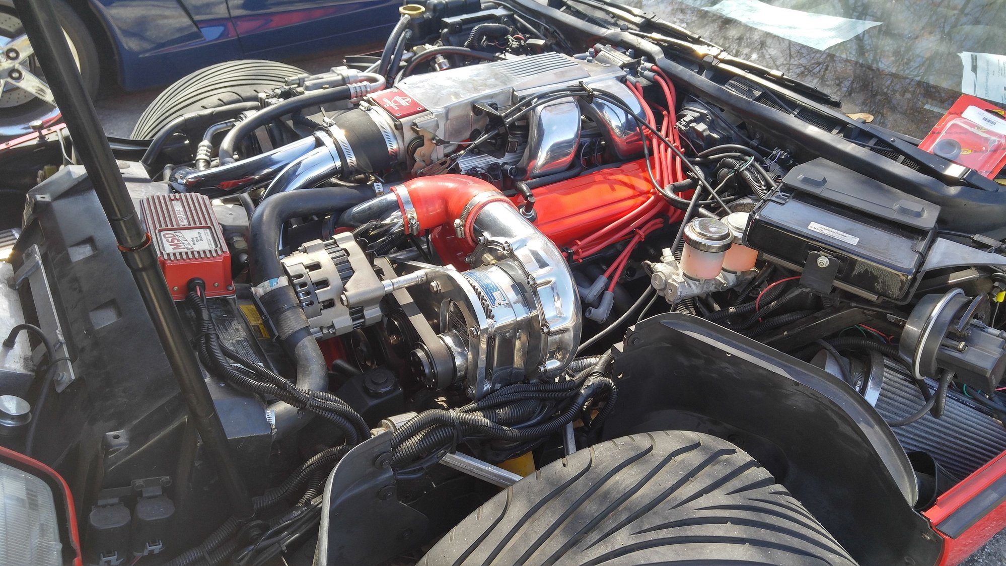

I have a modded C4 1990 383 Stroker with Pro-charger with dual inter-cooler, designed and tuned by Greg Caroll. 405 RWD HP 505 RWD torque.
I am having trouble with my 700R4 tranny (again) and I had a friend recommend a 4L80 to swap out as an upgrade. I have a tranny guy saying he can make my 700R4 bullet proof, but for $1000 more I can go wit the 4L80.
Is it worth the extra money?

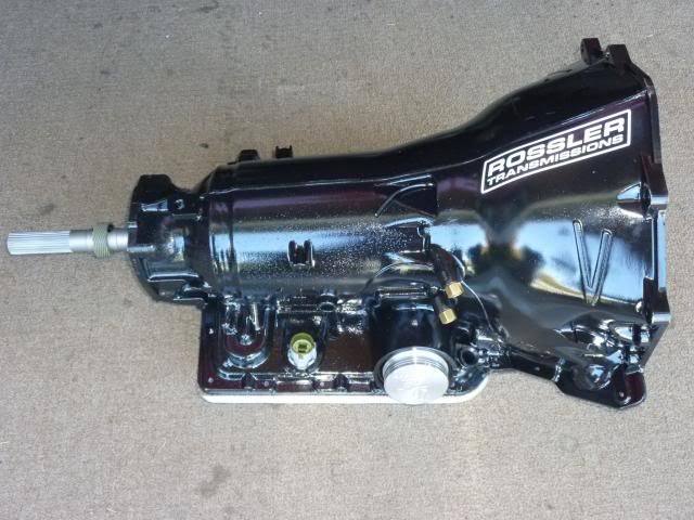

I've gone through a number of 700R4s and 4l60es. 7 years ago Carl Rossler built a 4l60e that I have had over a thousand low 10 second runs on. I did break a hardened input shaft initially. That was replaced by a billet input shaft and the transmission has been performing flawlessly ever since.

At the time I had a list of upgrades that Rossler performed on the tranny. Not sure that exists now. A lot of what he does is custom built for the application. I know his clutch packs and bands are custom sized while I'm sure other parts are over the counter. Rossler has a great reputation in the drag racing world. I know a 4l80 e can be built much stronger than a 700r4/ 4l60e but for my application, the 4l60e works well without the weight penalty.
