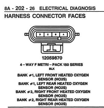

Yeah, that's kind of a sketchy listing since it only shows one part number but two different connectors. That is not accurate. The Factory Service Manual confirms that all four heated O2 sensors have the same connector:
