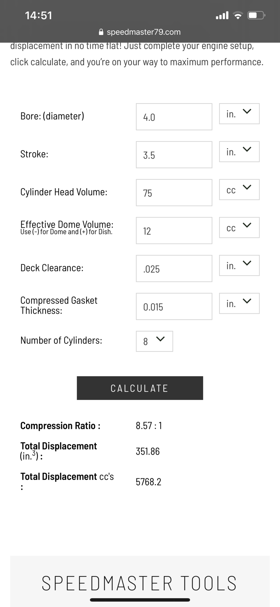

Here’s what I’d be looking at with my stock 350 if I went with the AFR 195 75cc comp port heads. Please let me know if anything looks wrong on this calculator. Had to do some digging for the proper specs.
Honestly the 8.5 compression ratio seems pretty low for now but I know it’ll work and be fine. Just curious about yalls thoughts on that. I know ideal is normally 10.5:1 or so. I know the same setup with the 396 as planned would roughly be 10.5:1 which is a great setup for the future.
Maybe I'm missing something, but I think that's crazy. You know the stock 1996 LT1 came with 10.4:1 CR, and the LT4 was 10.8? Why would anyone voluntarily go with way less than that for a n/a engine?! And you won't be gaining two full points of CR when you go from 350 to 396: more like 1.2 increase. So you'll end up with a 396 that's got less than 10:1 CR. If I were you I'd be aiming for 11:1.
Also, I feel like the online CR calculators are all over the place on results. I know that previous owner of my car, MSR, was not able to get 11:1 on the 396 build even with (well ported) stock LT4 heads. They went from a measured 58cc down a few CC by cutting the decks (maybe as low as 52cc), and he still had to source special head gaskets that had a short compressed thickness. Granted that was with custom 13cc-dished pistions. But even with flat tops you'll have a few cc for valve reliefs. I think you're way out in left field looking at heads with 75cc chambers. At the very most, you should be looking at 65cc chambers with flat-top pistons, and you'll still be below 11:1 on the 396 with any normal head gasket.
A 396 with flat tops, (5cc of dish roughly) and 65 cc chambers with total quench around. 045 will be 11.4 to 1.. roughly. Its just math... as long as the numbers are right comp ratio is a open to compressed ratio... initial volume over final volume... running the numbers you provided and assuming a .025 gasket yours should be 11.9. Unless I've missed something... Granted actual ratio is never that but still. I don't know. Its a number that actually doesn't mean much

Red89'-L98's Avatar
Red89'-L98
Joined: Mar 2012
Posts: 769
Likes: 22
From: California
FL Events Coordinator
St. Jude Donor'13
So basically go with the 65 cc chambers. Sounds like the 75 cc’d will lower the ratio too much to be efficient, even with the 396. The car is NA and currently I have no plans for forced induction but who’s to say I won’t get bored and throw nitrous in it lol probably not but who knows.
I plugged those numbers in two online CR calculators and both gave me 10.4 if you add .045 quench and .025 gasket height, or 11.05 if you just use the .045 quench height (.020 deck clearance + .025 gasket thickness). By definition the latter is the correct way, I believe, as quench height is defined by the distance from the flat top of the piston to the head's deck surface. If the block is .030 over, then it jumps to 11.2. Regardless, 11.2:1 is not too much for any typical cam spec and premium pump gas, and if you want to drop it a couple tenths you can play with gasket height and/or piston deck clearance. OTOH, going to 75cc chambers drops it to 9.9:1, which is going to be hard to make up without ugly domes.
I think you are correct. Strange how results vary wildly. So you are not a .03 over. Most 396s ive seen are that so thats where I based my math off. It makes a substantial difference despite only a little visual...
