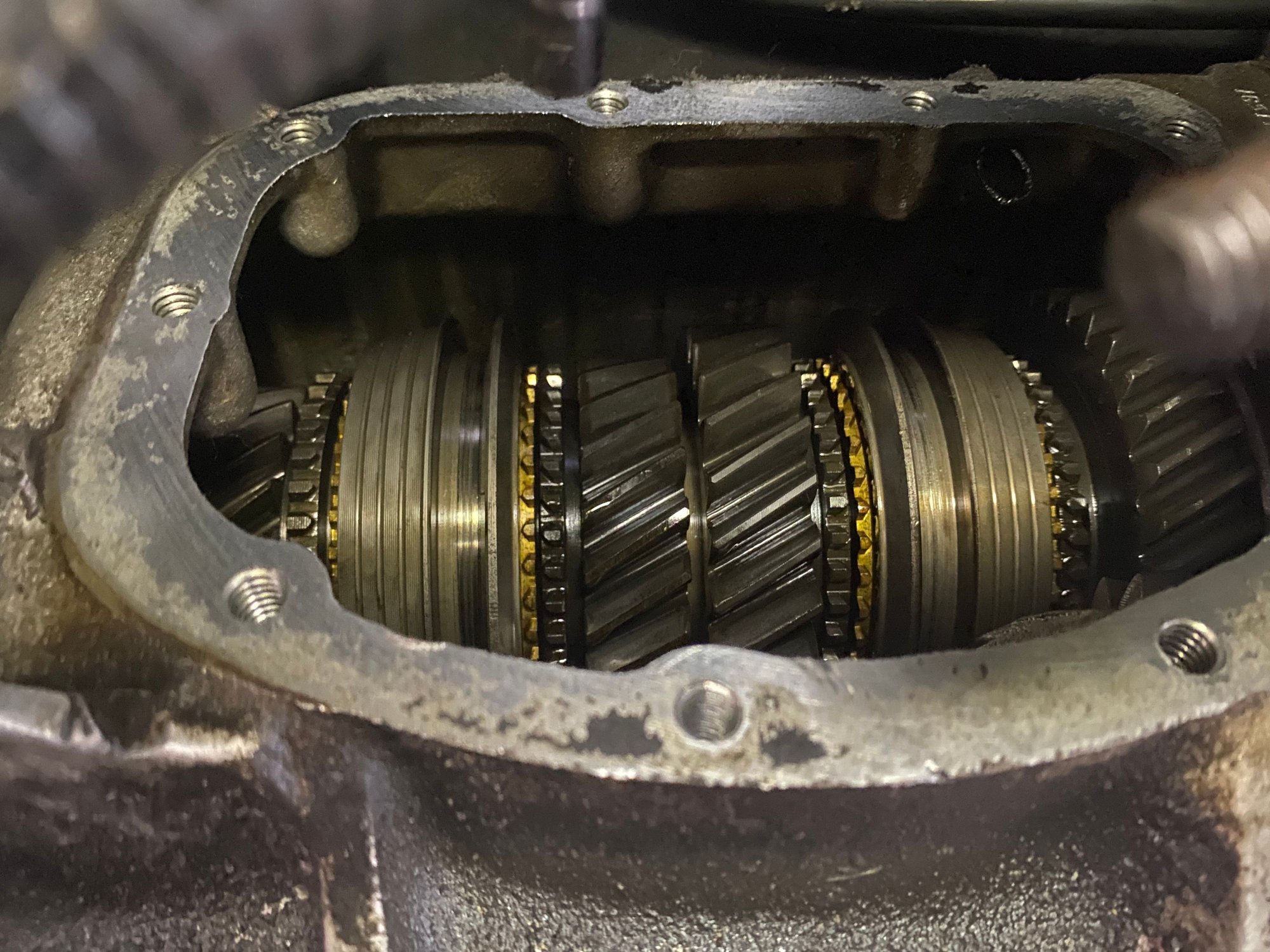

Thanks for the response! I got up underneath of it today and moved the forwards to 12 and the reverse to 7 and still had no luck freeing it up. I drained the gear oil, which looked good, and removed the side cover. Everything looks fine. I’m at a loss. I would have to pull the transmission if I don’t have to. The engine starts fine and before messing with it, it ran through all gears as smooth as normal (with the clutch in). Do you have any other ideas? You’re the only person who I’ve got any information from INCLUDING local dealers!lol so I thank you again for your time and response!

Thanks for the reply. It was in neutral before taking the cover off. I accidentally moved that selector lever when taking it off. I had both forwards at the 12 o’clock position. Inspecting it, everything looks fine. I literally have no idea where to go next. Could it be something in the overdrive unit?

Okay I got you now.

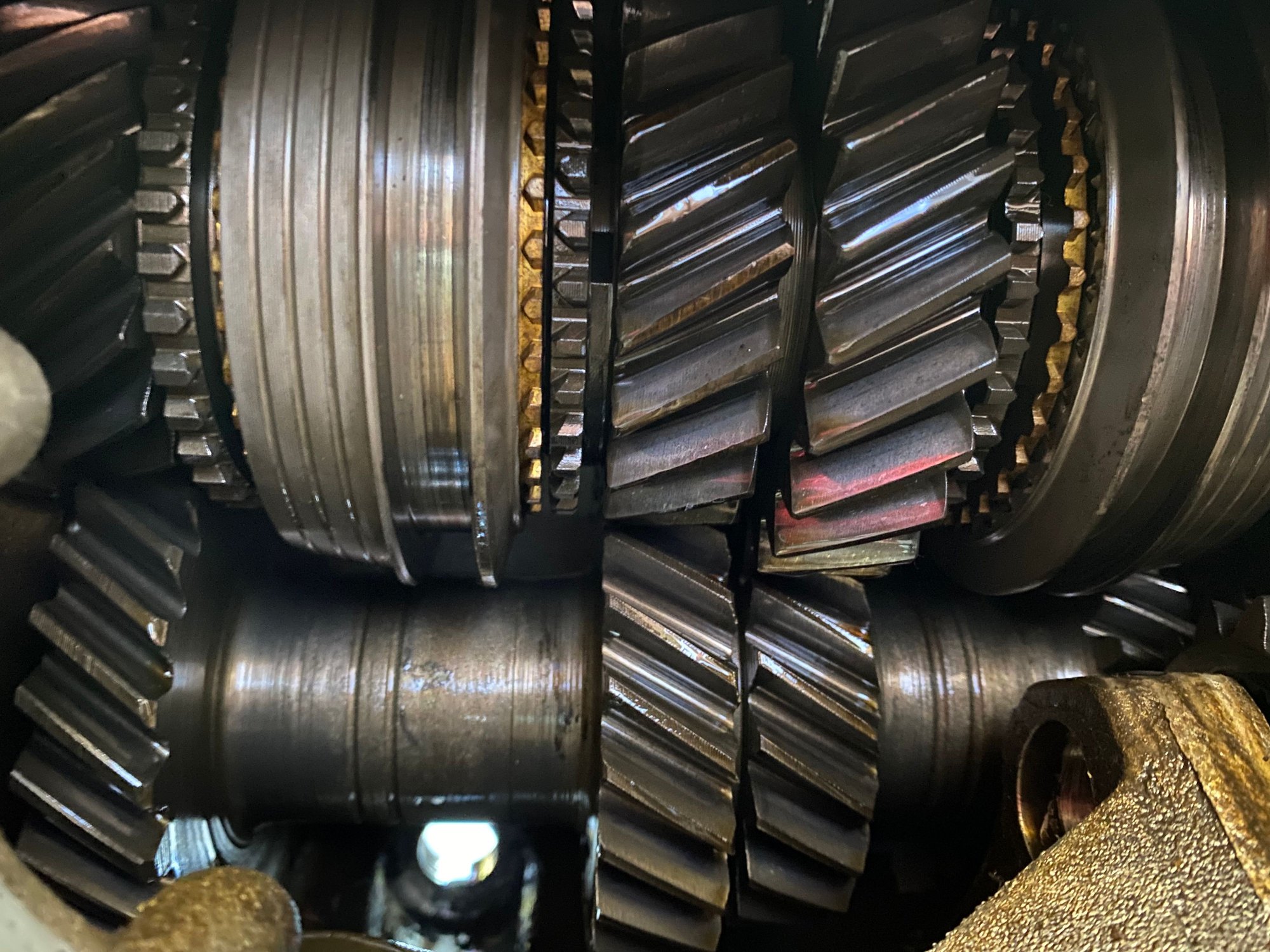

Like this? All four golden rings are now visible. If so, I still cannot get it to rotate.

I can see al least 1 chip out of a gear shouldn't be enough to lock up, with all the Brass's showing it should move. Try playing with the reverse and I'm sure that's a redundant statement.
Now I'm sure the next step is a trans pull so once you get the drive shaft pulled we can rule out if the rear is whats locked up

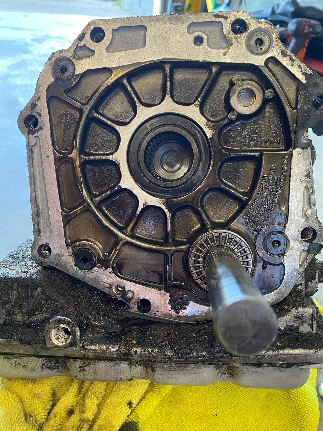

Thanks for the response to all you. So there was plenty of gear oil. There was a tad bit of metal dust that I collected with a magnet. I mean just a very small portion. However, sitting on the bottom of the gear case was a full sized washer. It wasn’t torn, beaten or broken. A full size washer about 3/4 inch in diameter. It blows my mind how it got there unbroken or not chewed up lol I pulled the transmission today and is in neutral. The gears spin perfectly while turning the input shaft. However, the output shaft is completely locked up. It has to be an issue with the overdrive unit. I bought the car a couple of months ago and the overdrive never worked. I wasn’t too concerned as I just planned on short distant drives. I wish I would’ve inspected it more thoroughly in hindsight. Could a failed overdrive unit literally lock the transmission up that you know of?

I guess a if a piece of reckage could find its way into the pump case and that would stop the shaft dead, but on the other side the power of the driver line would shatter the pump.
Since the trans is on the ground separating the Box from the OD is not a big deal.

Originally Posted by IHBD
I'm guessing that if the output shaft is locked, the overdrive has suffered some kind of catastrophic event that is probably not repairable because parts made of unobtanium have been destroyed or damaged. Likely not fixable. Start looking for a replacement.
Is the output shaft locked in both directions, or only one? If the sprag "flipped" (it happens in TH400s and sometimes 4L60) the output may lock, but I'm not exactly sure, It's been 35 years since I saw the internals of one of these on the bench. It may be fixable, but seems unlikely to me.
When you get the overdrive separated from the 4-speed, post a couple of pics of the front seal, front adapter plate, and the input shaft. There are several "clues" to what may be wrong internally just from looking at these components from the outside.
thanks for the info. I’m having a hard time finding a replacement overdrive. There is one full trans on eBay but it will be about 2k with shipping. I’m in a bit of a pinch financially and 2k is a bit out of my price rang. Does anyone know where I could find one? Here are a couple of pics of the case separated. I really don’t have any knowledge as of what my next step should be. Any info is greatly appreciated. (Whether or not it’s repairable). The picture with the washer is what I found sitting on the bottom of the gear case. I’m curious if anyone knows just what it is. Thanks in advance
