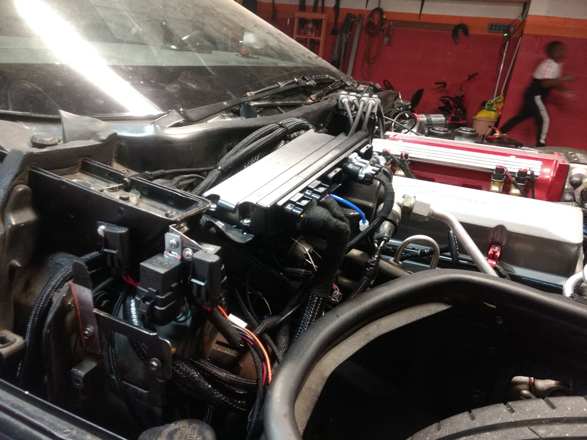

Holley Terminator X Max installed and now to drive and tune.

Just curious, how hard was the install or was it actually closer to plug n play?’Also do your gauges and stuff still work? Or does it get rid of the factory gauges?

This Holley Terminator kit ( PN 550-942) was 99% plug n play. I had to order adaptor plugs for the IAC, TPS, oil pressure sending unit, and for my dual sync distributor. The Holley terminator wire harness is built with LS style plugs except for the fuel injector plugs. They are plug n play to the C4. I didn't use my HEI distributor, because I had a F.A.S.T. Dual Sync distributor from the F.A.S.T. ecu that was already on my car. If you use your HEI distributor, you would need an adaptor to plug the HEI into the Holley Terminator wire harness. I got all the adaptors from Holley's website.
As for my gauges, Speedometer, Tachometer, fuel level, Oil Pressure Oil Temp, and Coolant Temp still works. The gauges that no longer work is the miles per gallon and instant fuel avg. gauge. This ecu doesn't come with a mounting bracket, so you would have to fab your own bracket once you decide where to mount it.
