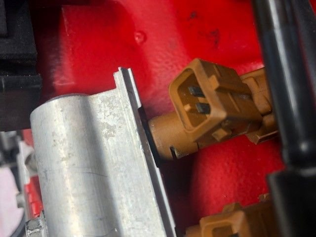

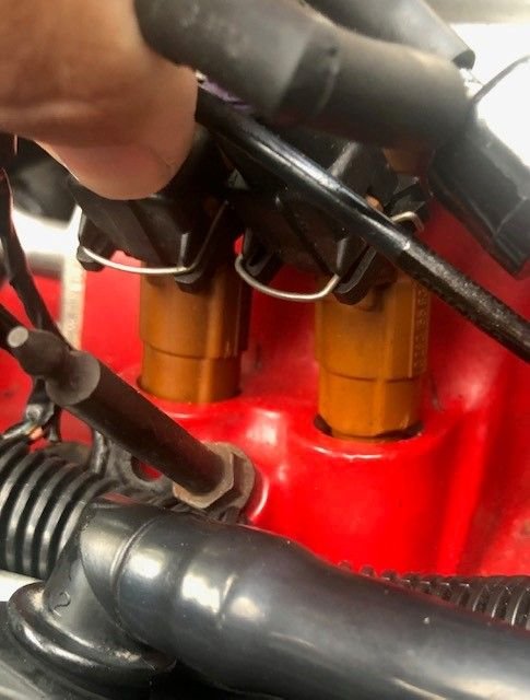

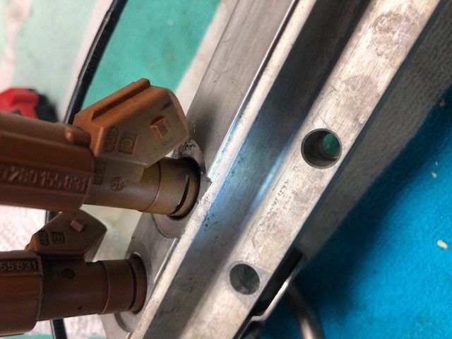

I have installed Bosch injectors in my LT4 intake. The new injectors have slots for a clip but it doesn't go all the way around the injector. So the stock clips wont work.
Without the clips the injectors slide down. You can see in the pic the one on the left is down into the hole more than the one on the right. The one on the right is up into the fuel rail properly.
I thought about using a o-ring around the body of the injector so it wont let it slide down against the intake. Not sure if this a good option.
Any ideas??

where did you get those.? The way they are installed is a fire hazard. you also know they are a 30lb call me I will tell you what to do to make them work. Jon

I had to double my O-Rings in my L98 and no clips.

I have the double orings but they slipped down.
Yes this is a big hazard. The car is off until I can figure this out. FIC I will be calling.
