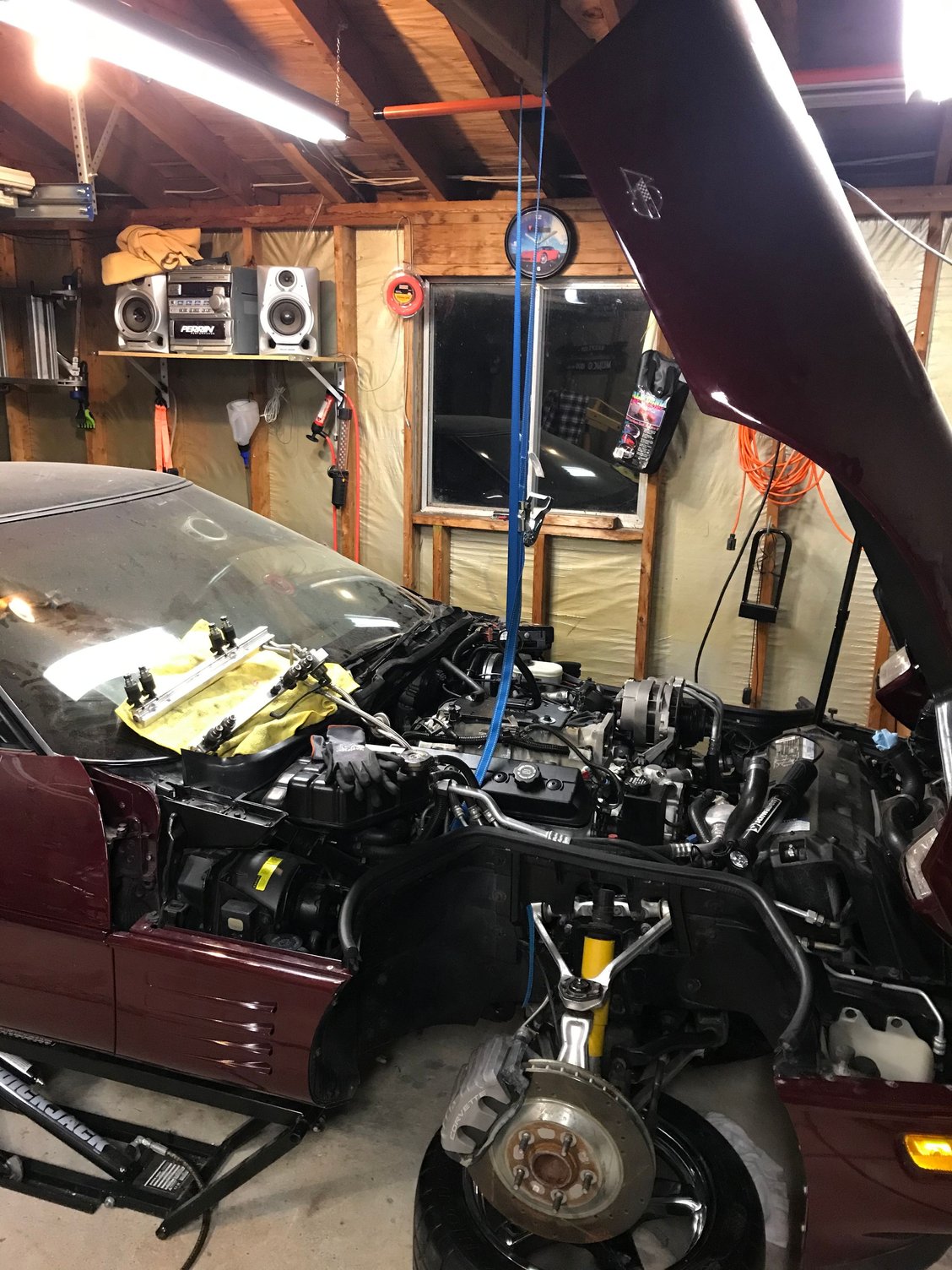

Took a bit of finessing, but it went in! About an hour with two of us working on it. IMO well with the work saved installing plugs and the manifolds inside the bay.
