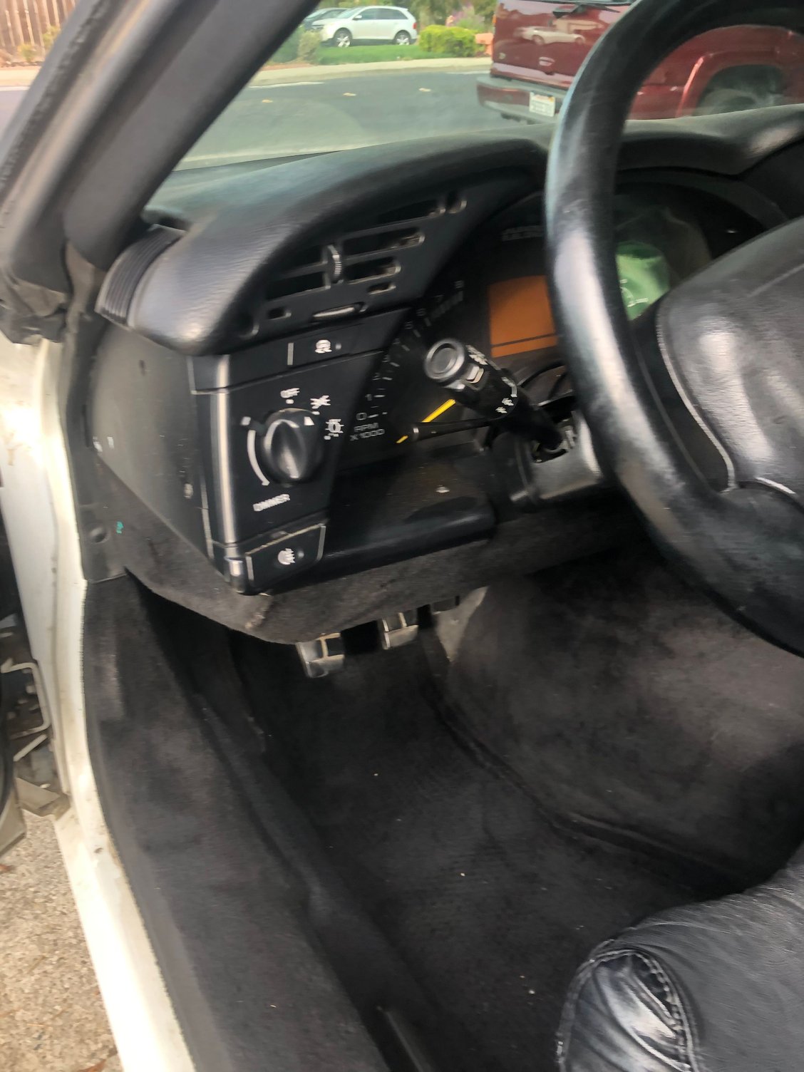

i have a few pictures of what is going on currently . My plan is to do a basic tuneup (COMPLETE) fluids flush, new fuel filter ... well, you’ll see the pics haha. Let me know what u guys think!!
