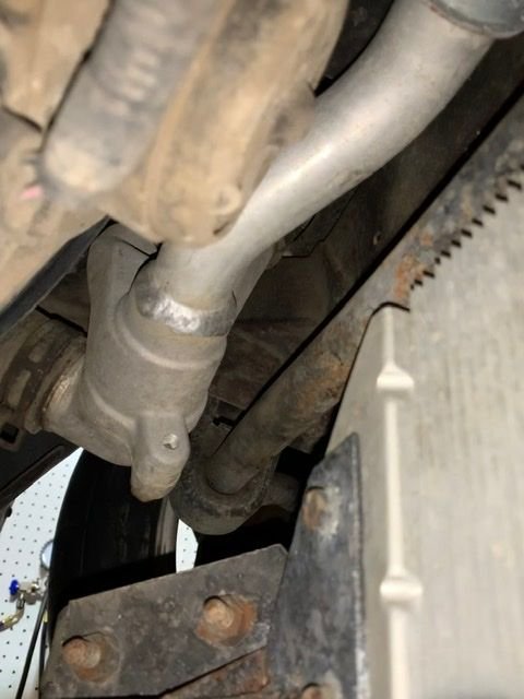

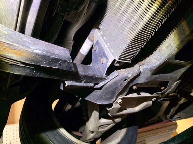

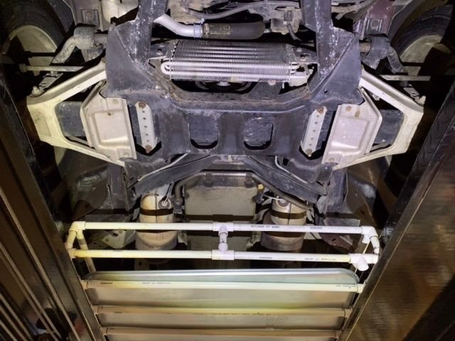

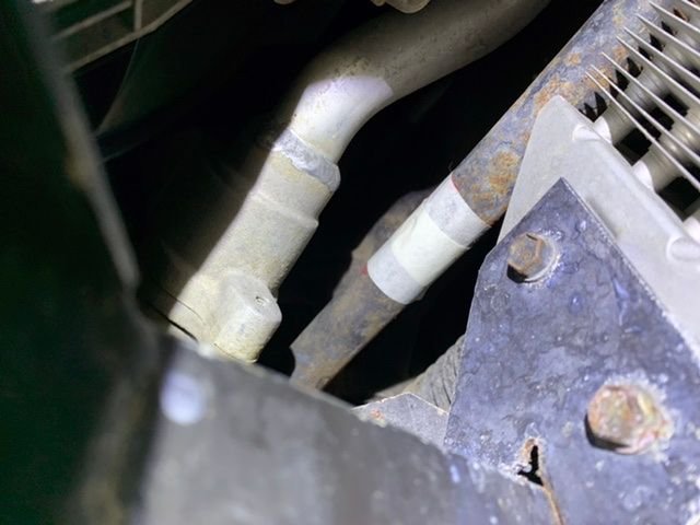

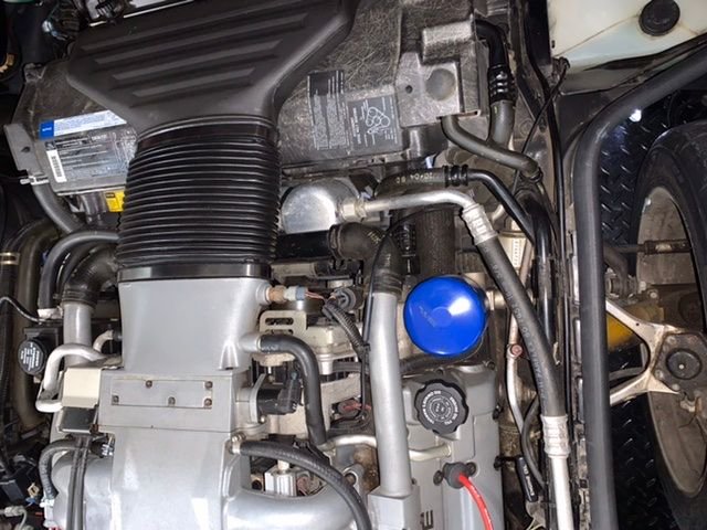

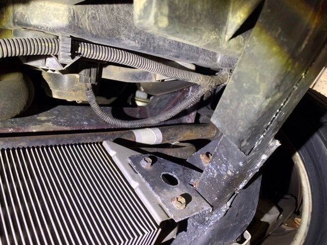

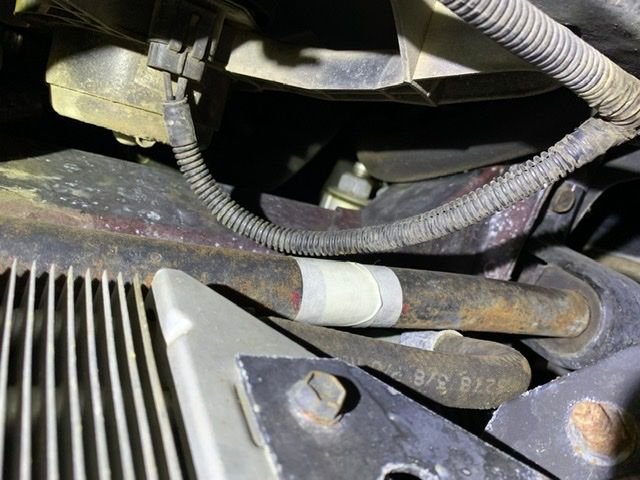

Following from my previous post, trying to upload pictures from a different platform...
First, a perspective of the underside of a ZR-1, showing the large power steering cooler and you can also get a glimpse of the external thermostat housing on the passenger side.
This view (below) of the passenger side first gave me pause about the clearance in front of the roll bar needed to install the damper bracket:
I measured 5” to 7” inboard of the roll bar brackets on either side and applied masking tape on the roll bar to show roughly where the damper brackets would end up.
First the passenger side, a wider perspective and then a closeup. Certainly tight of access but doable maybe with the right tools...
Access from the top (using the long extension method) is all but impossible on the passenger side due to how busy the engine bay is there:
The driver side is much easier of access to get the bracket on the roll bar, but also has a potentially significant wrinkle. There is a line leading to the PS cooler that is immediately aft of the roll bar and canted at an angle very similar to how the bracket is supposed to be oriented. My concern is that the damper rod, once installed, may rub against this line. Because it connects to rigid points on both sides (just out of view) that line is not very compliant at all and cannot be moved out of the way, as far as I can tell. As before, first the broad perspective and then the closeup...
Happy to get opinions on the doability of this kit on a C4 ZR-1!
