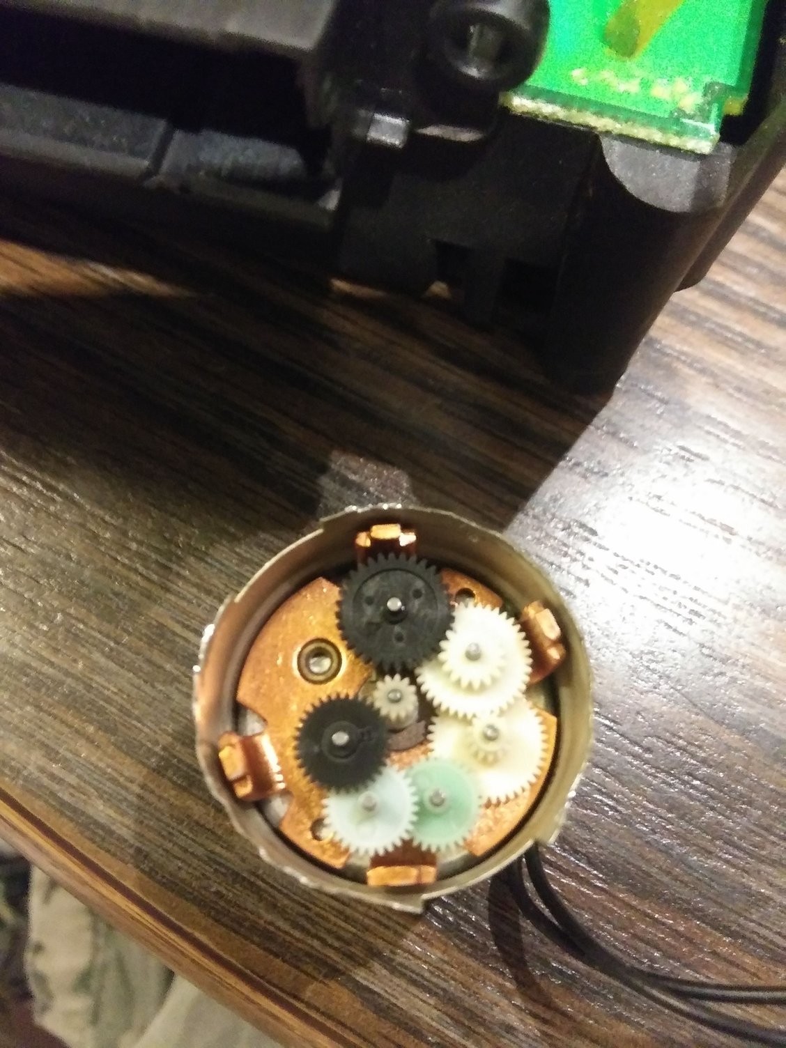

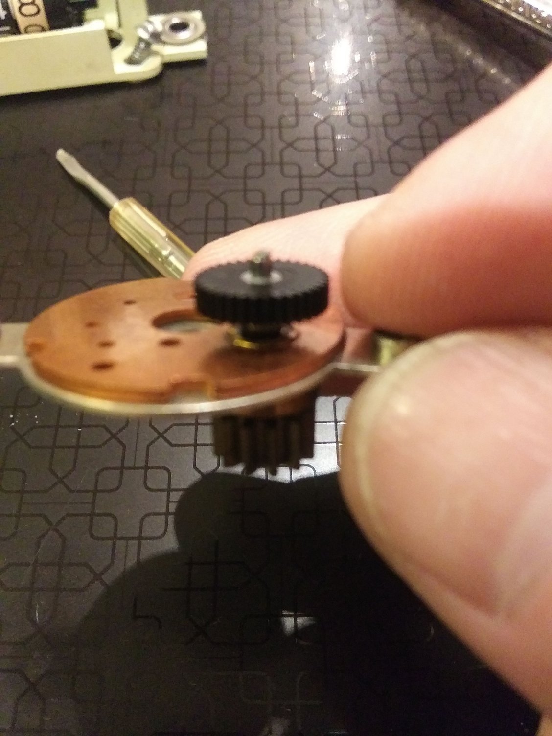

Ok well I went ahead and pulled the odometer and applied 9 volts from a 9 volt battery. Nothing. So i dug deeper and pulled the front of the motor apart. Theres several small gears inside. The motor felt stuck and wasnt moving at all. So I turned it with a small pair of pliars and got it unstuck. Now the motor moves a little but still doesnt spin. I dont know if the cluster sends it a different type of signal or what. But i put it back together and will try it out tomorrow.

So taking the electric motor apart and getting it to spin solved the problem. I used my phone with the Dakota Digital app to send a pulse signal to the cluster and the odometer rotated and advanced several tenths as I resent the test pulse. Problem solved! Hope this helps anyone with the odometer issue. Seems like the motor gets stuck with 35 years of grease drying up on it.

This thread is the best, had the same problem, opened up the motor, wiggled the main axle a bit, but it still got stuck, sprayed it with some electronics anti oxide. then it started working. And thanx to the picture earlier in the thread I managed to put it back together.
