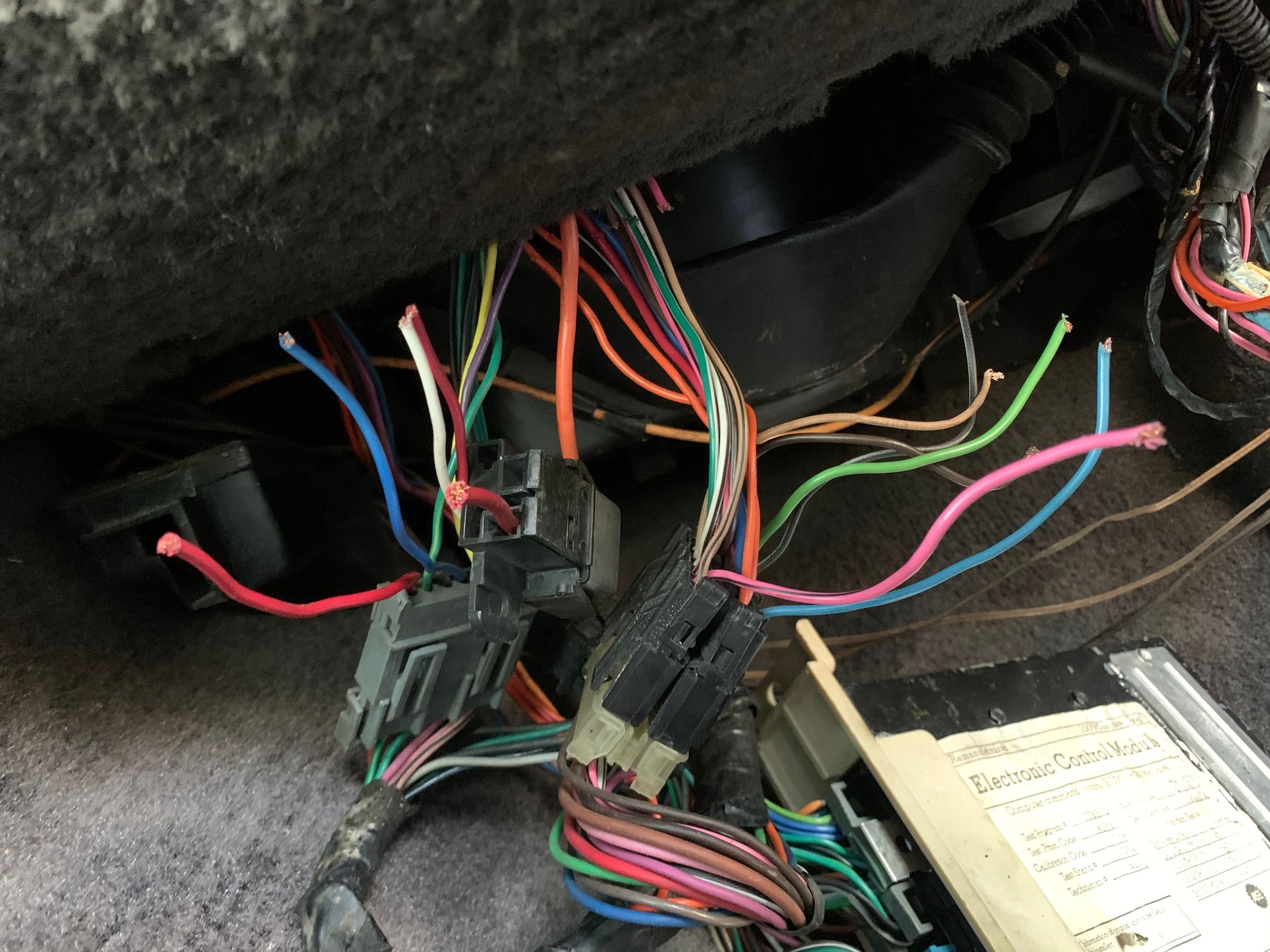

I have those 11 cables cut, is that why it did not start? I have to put them together and test.

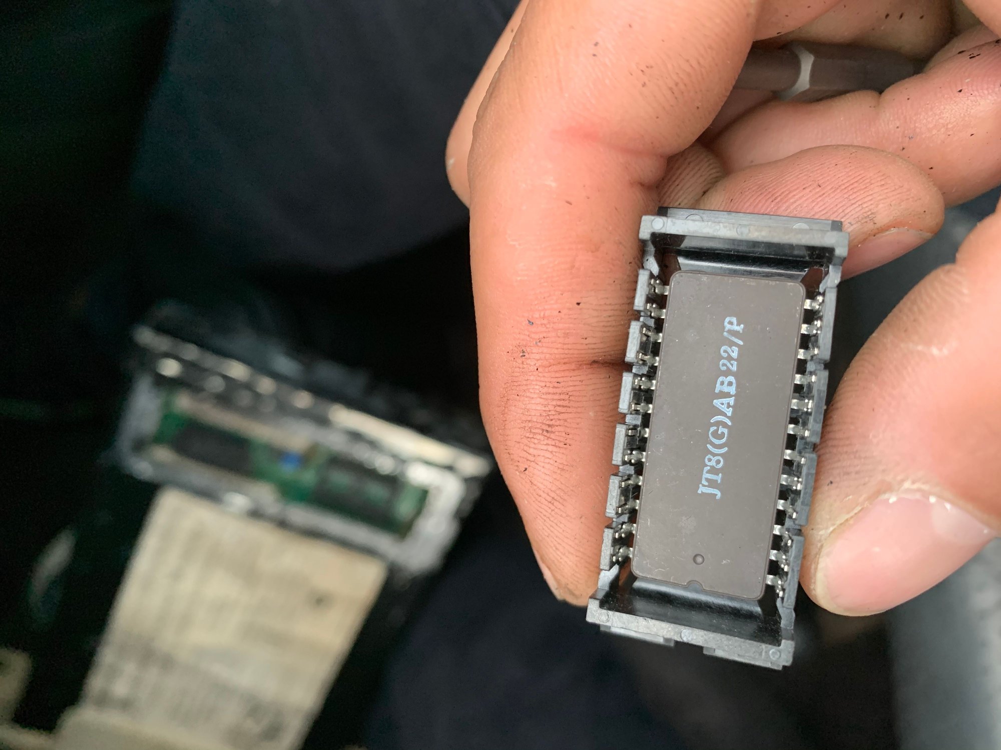

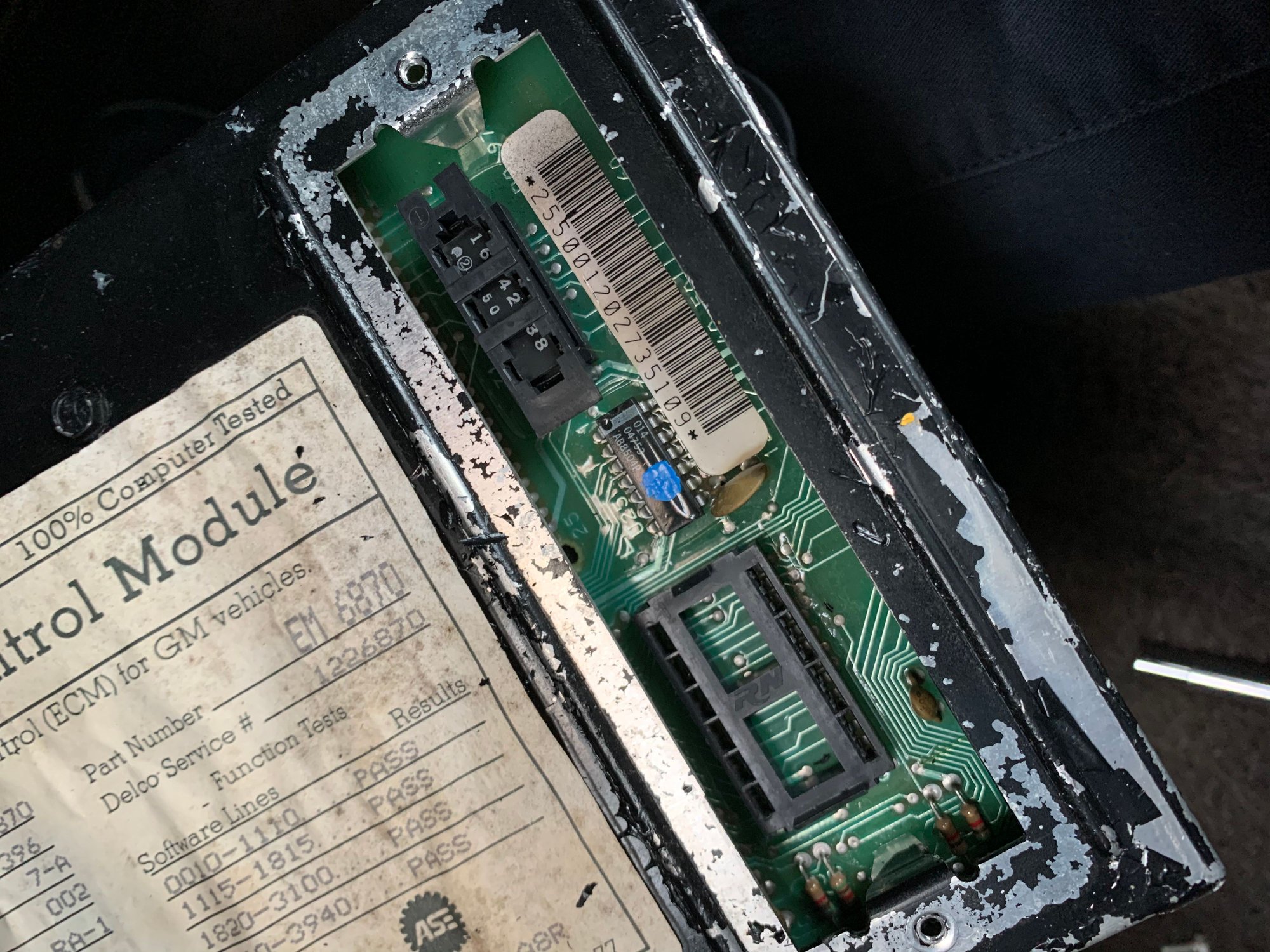

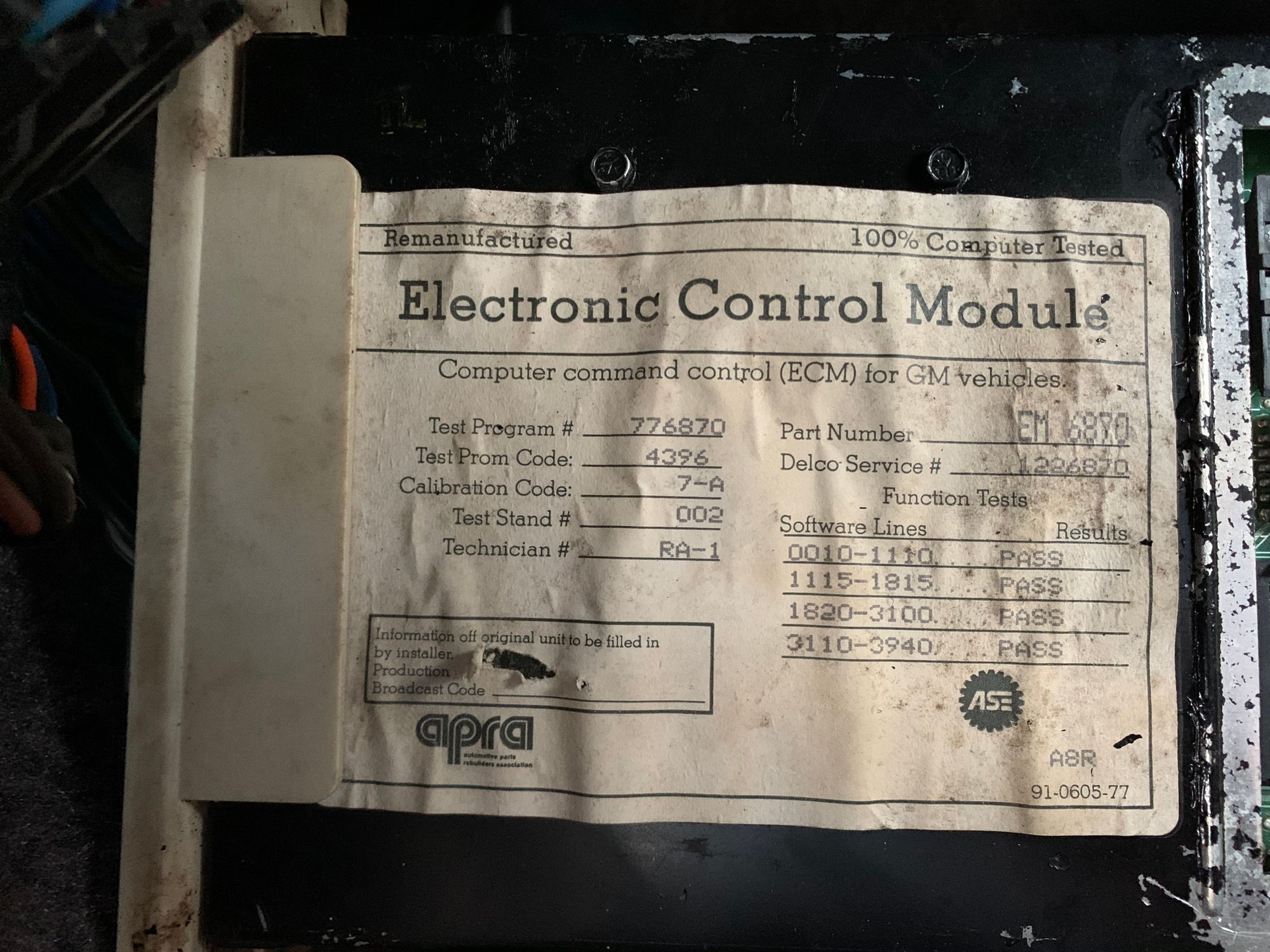

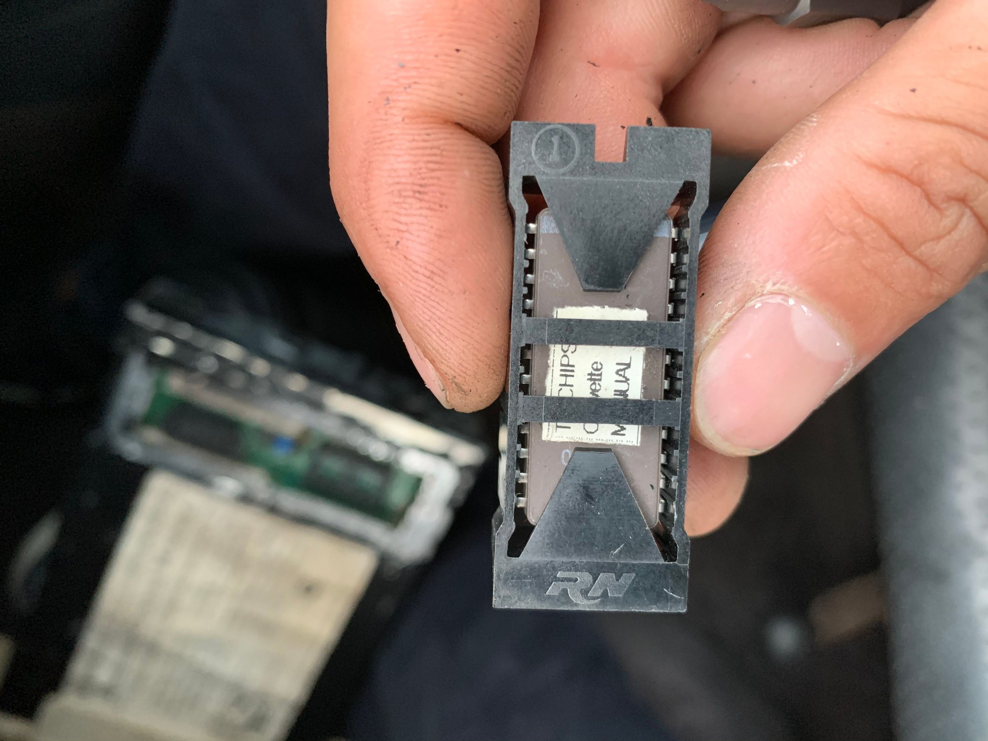

Is this chip the original?

IDK. The ECM is reman since the label says so. The EPROM, makes me think it is aftermarket or has been molested somehow. Others will chime in,.
