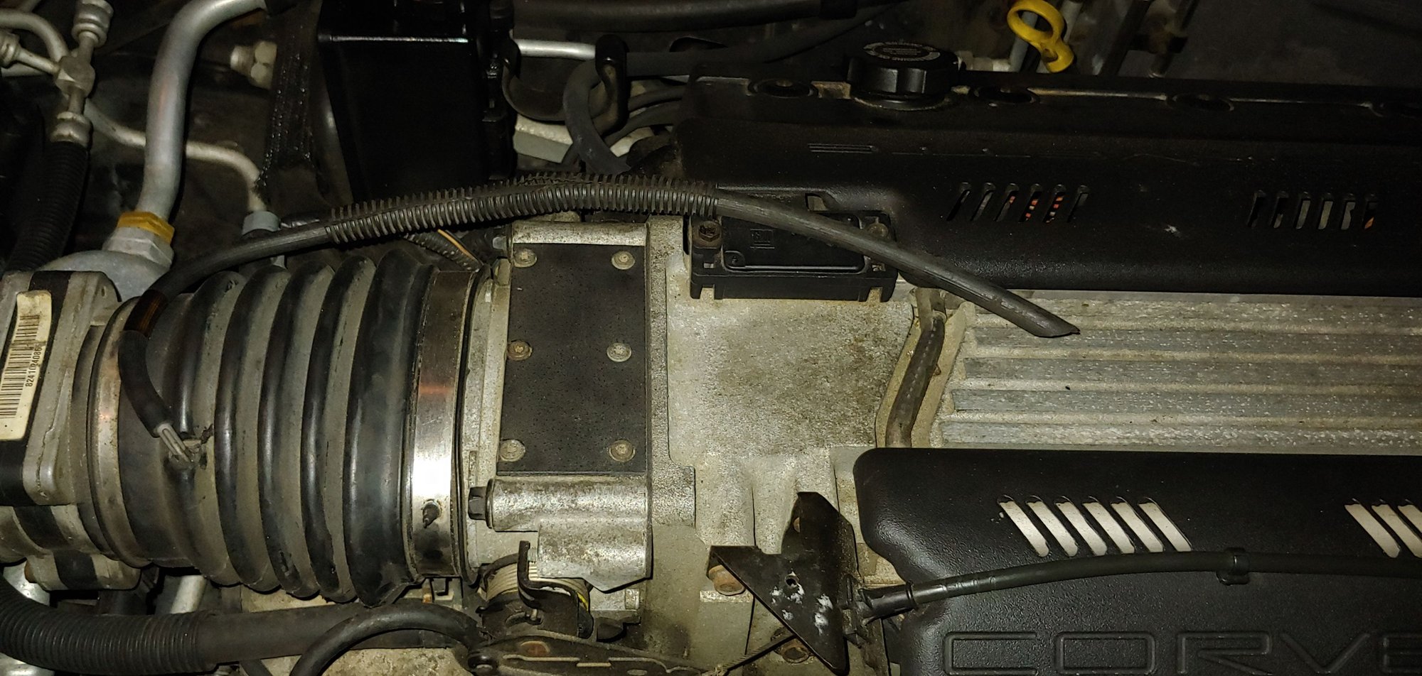

A couple questions:
​​​​​​1) in the attached picture: what is this hose coming off the intake before the MAF? Is it for water to drain? I kind of just pulled it up gently and realized it wasn't attached to anything.

The small hose attaches to.Opti Spark cap its part of the venting system.
