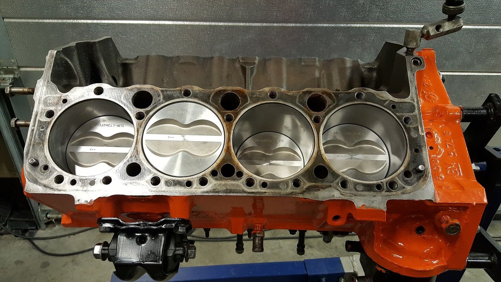

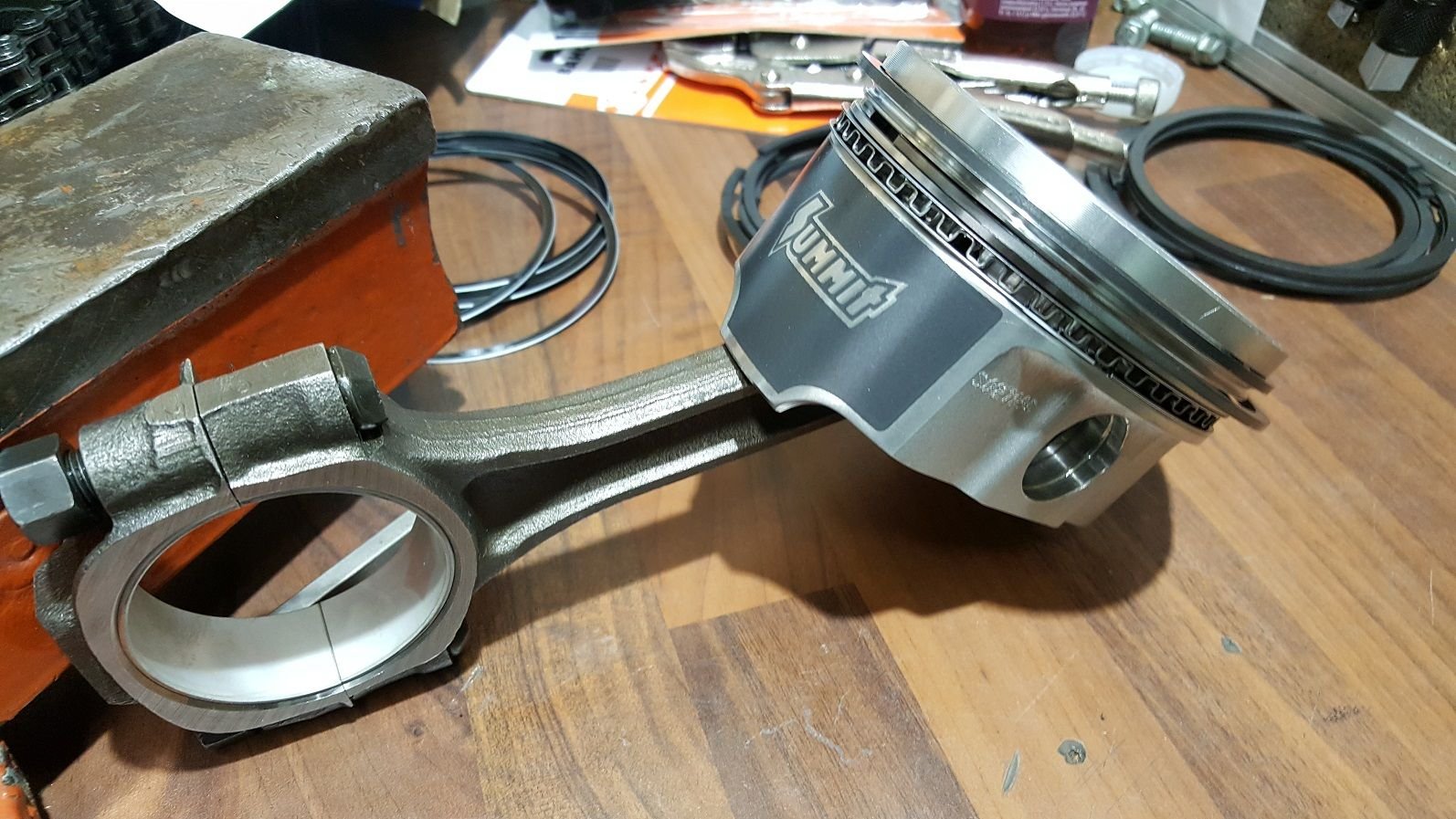

Now I am rebuilding my old L98 engine from which I blow the piston...
