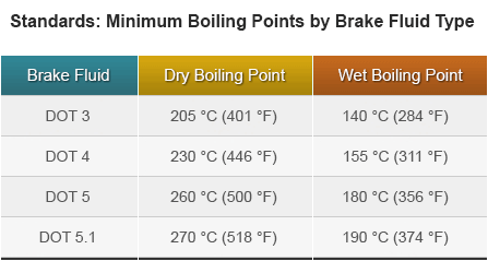

One of the other benefits of better fluid is the Wet Boiling point. As most people here are not changing their brake fluid often enough. It isn't 'life" of the car fluid.
According to the chart, 30 degree difference. But for what you would pay for it ($12.99 for a 12 oz can) vs ($9.99 for a 32 oz can), I suppose it is pretty spendy insurance for the people who choose to believe it is a sealed system and therefore doesn't need to be flushed.
Not sure what chart you are looking at.
But here is the spread between Dry/Wet.

Sorry, 40 degrees on dry. 45 on wet
