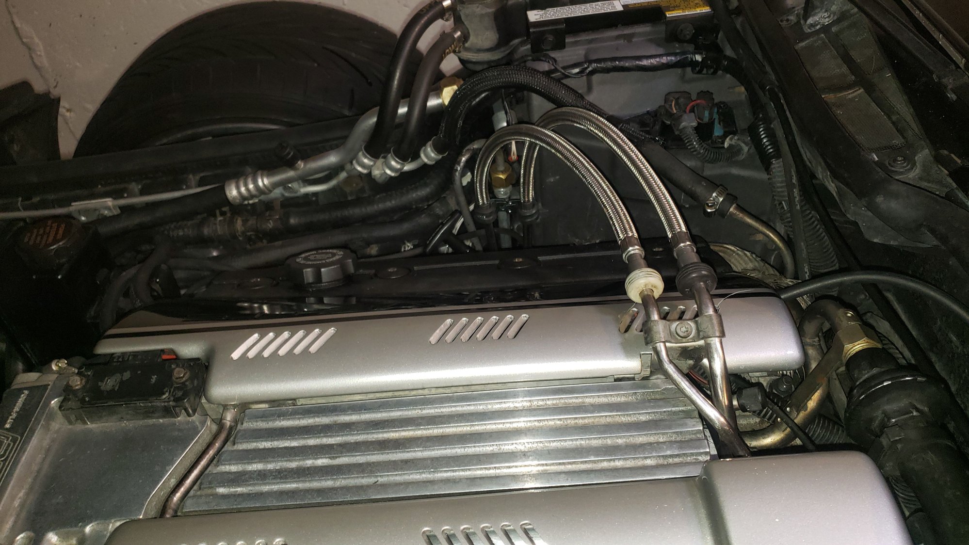

I am looking for the bolt that holds the the bracket so that the fuel lines get secured to the fire wall... my car is missing both the bracket and bolt and I would like to get these secured. Please let me know the bolt size and pitch because I can not find this information anywhere.
here's a picture of the hole I am looking for a bolt to fill

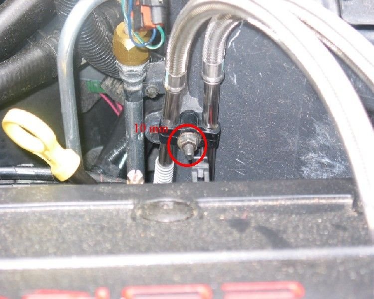

Sadly it looks like that used to be a stud but got torn out. Here's a photo someone took for a fuel filter replacement how-to:

Is there a way you can let me know the size and pitch of that stud

In the snapshot supplied in Post #2 the male thread is an M6X1. That doesn't have a direct correlation to what you might need to adapt something to the car. Your snapshot with the Adel clamps you chose I'd think there's certainly a more desirable choice. For a stud I'd think there's also several potential choices.
If someone had a late model salvage case the stud would likely be very easily removed.

I just want to know what threads into that hole so I can buy a bolt.... I plan on using the clamps I have now as all the wrecking yards that are local to me never seem to have any corvettes let alone C4s
