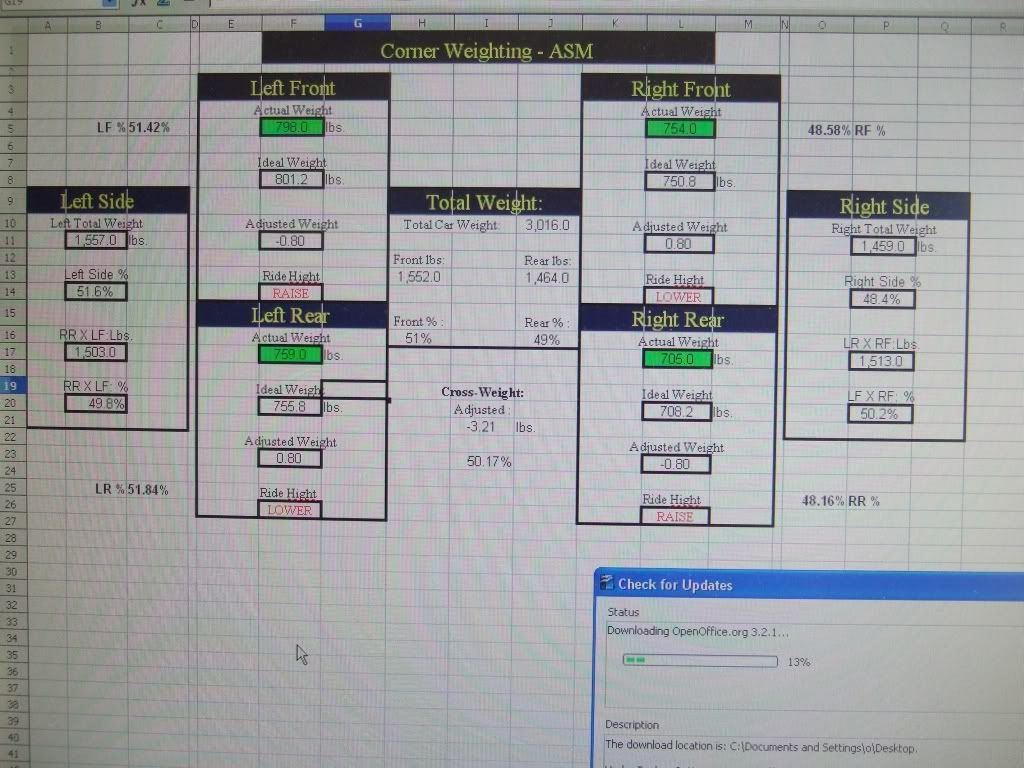

I’m at 3000lbs. Still have carpet,radio, power windows. Hollow bumpers, no heater or air. Pinto rack and pinion, 5 gallons of gas, 36lb battery. Chrome moly 6point cage, kirkey seats and a 12 bolt rear
