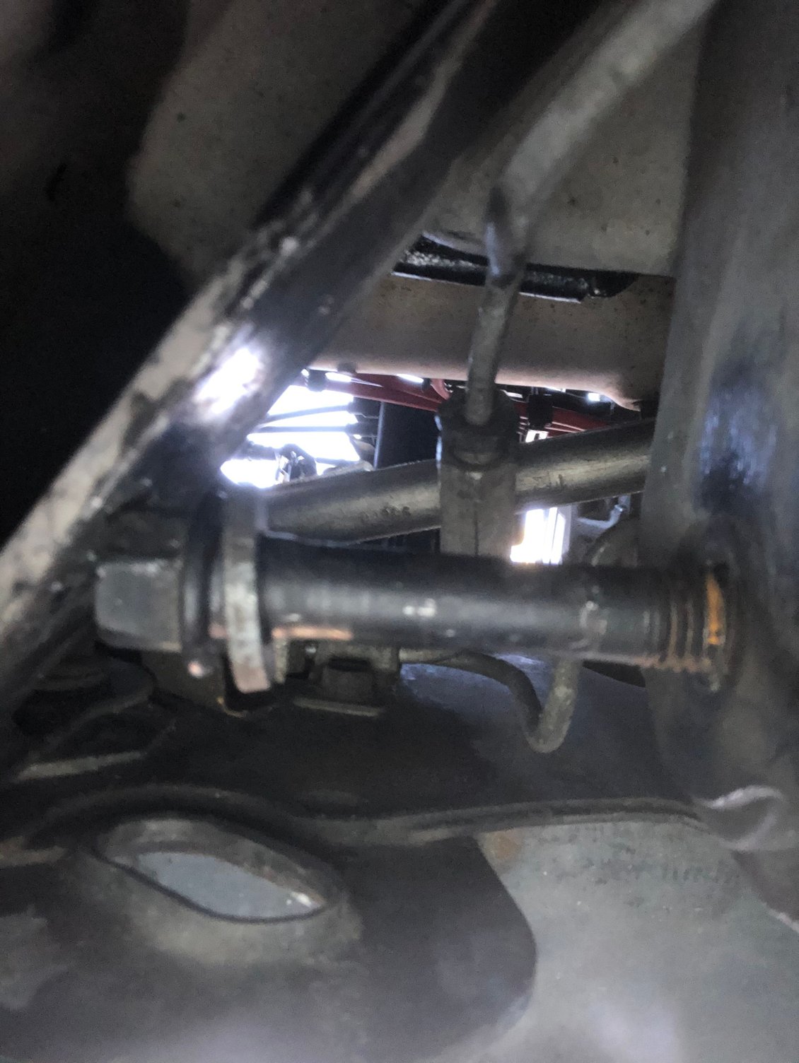

Removing control arms for ball joints bushings etc and this bolt doesn’t want come out. It butts up against the frame before it fully come out? WTH GM?

Remove the brace it is butting up against. It’s 4 Bolt’s and one nut.

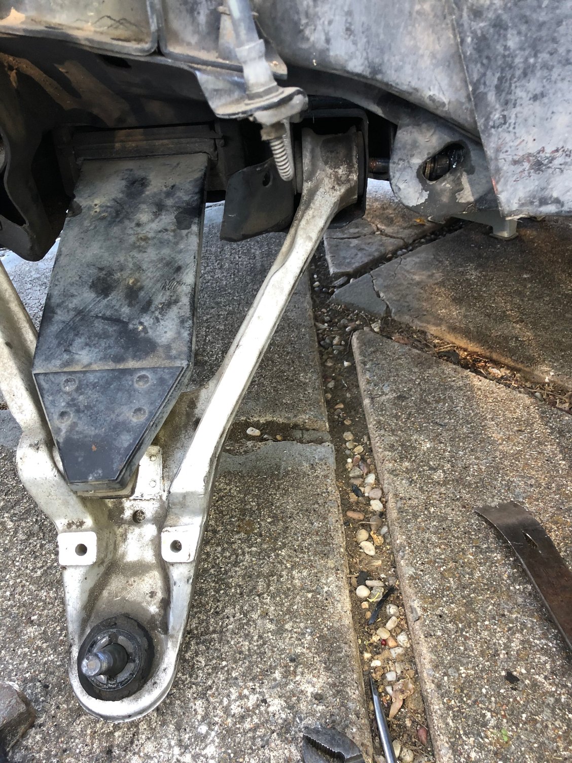

Thank you!!! Worked like a charm. I did support the engine even though the mounts are welded in. Can’t be too careful.

Engine isn't going to fall. No need for the additional support.
