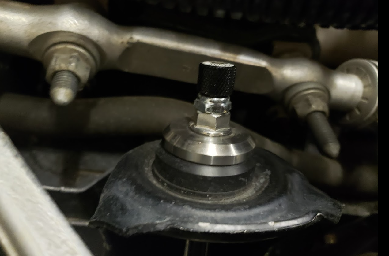

I am currently running the banski mounts and ridetech shocks. I had more of a challenge finding two nuts to lock the top of the front shock and fit under the adjustment ****. Tom at Banski was also very helpful when I had installation questions. Have fun. Go fast, be safe !
You could not use the two nuts that came with the shocks? What did you find that was not as thick? I had planned on using a nylalock nut.
But from what you posted there may not be enough room.
Thanks Hawkeye56
Thanks Hawkeye56
Hello Hawkeye. It's been a whole summer and I do not recall why I did not use the included nuts for the front shocks, might have been it did not appear to be quality hardware ?? Pic of where I ended up, not the cleanest solution but it's holding tight. Used a flanged hex nut and nyloc nut with blue loctite on everything. Sorry I do not have better info - or memory.
Cheers. -Steve

Hi Steve
Thank you for the picture, I now have an idea of how much length there is to use.
