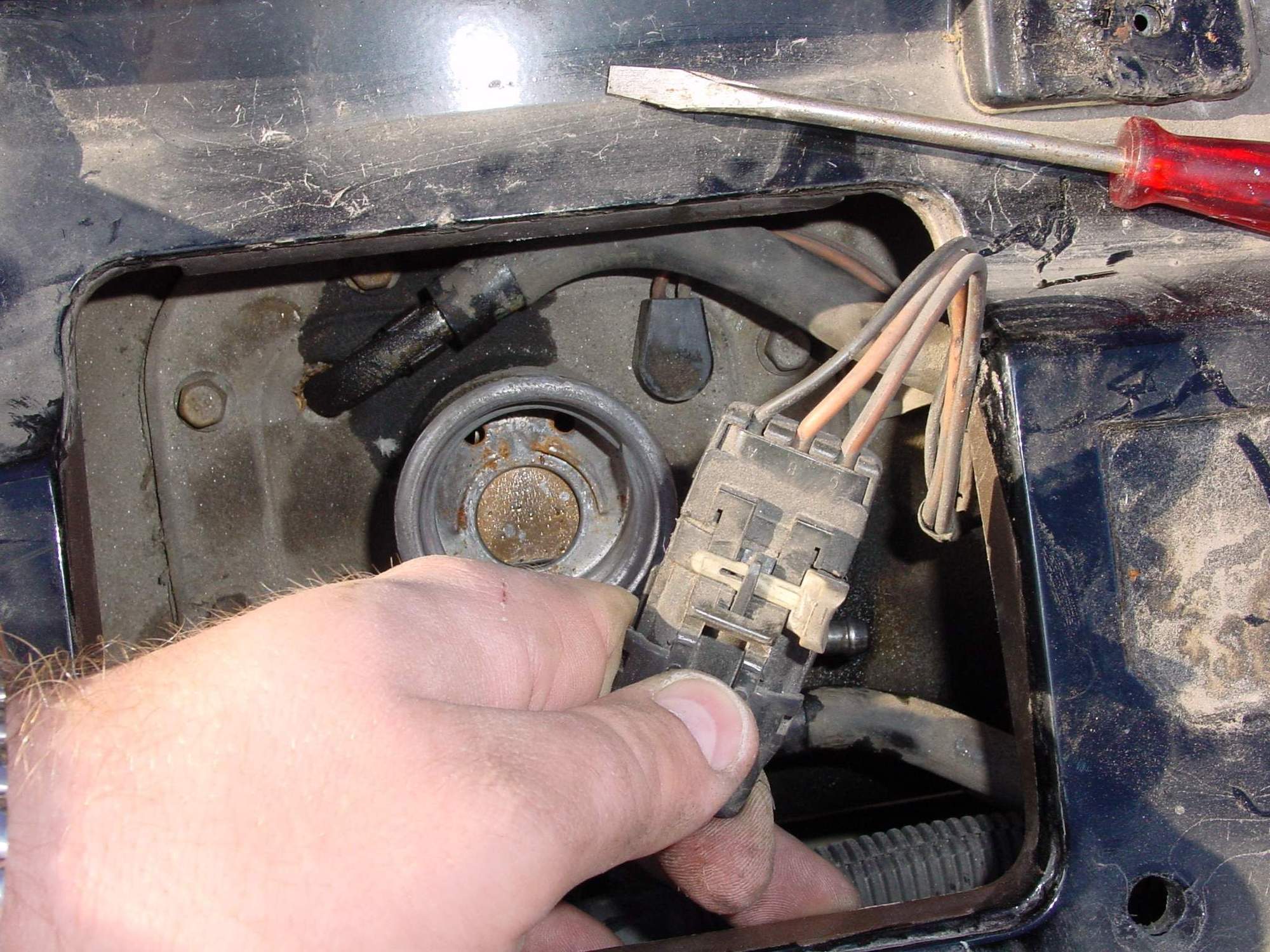

There is a check valve near the fuel pump that keeps fuel from backing out of the fuel line and into the tank.
That check valve is faulty.

That is also why I suspect faulty wiring.
To test the pump I used a separate 12v.
The connector at the pump, the mid pin, what is that?
Maybe it's visible at the schematic you attached, but I look on the mobile right now and its so small... 😂
I will check on the laptop later.
Cheers
/Stefan
Old Jan 14, 2021 | 05:21 AM
JoBy's Avatar
JoBy
Posts: 2,150
Likes: 304
From: Timra, Sweden
A = Ground
B = Fuel level sensor
C = Fuel pump
Old Jan 14, 2021 | 05:35 AM
Sac_197's Avatar
Sac_197
Joined: Oct 2020
Posts: 24
From: Gothenburg
Originally Posted by JoBy
A = Ground
C = Fuel pump
of course, stupid of me... 😂
Thank you! 👍
A friend of mine will help me to check the connections at the relay. If I don't remember wrong there are pins A to E?
I have to check which wires should go to which pin.
My limited "colour vision" made it problematic. 🙂
/Stefan
