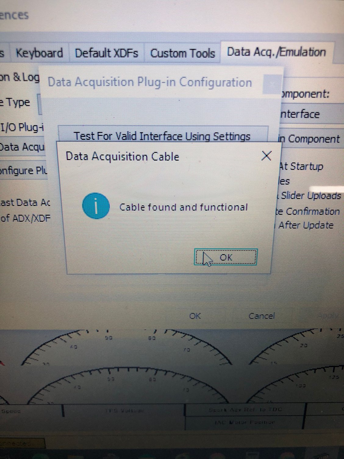

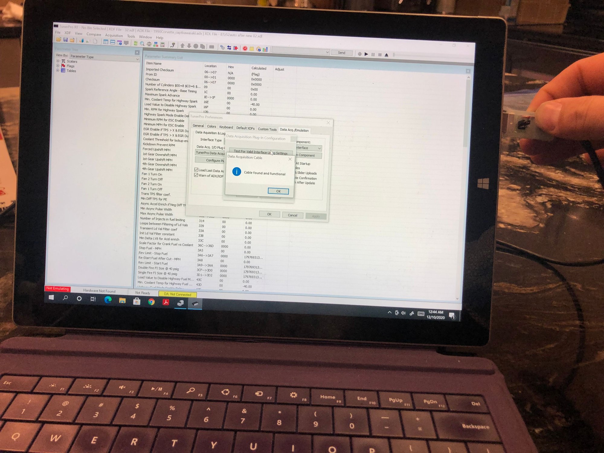

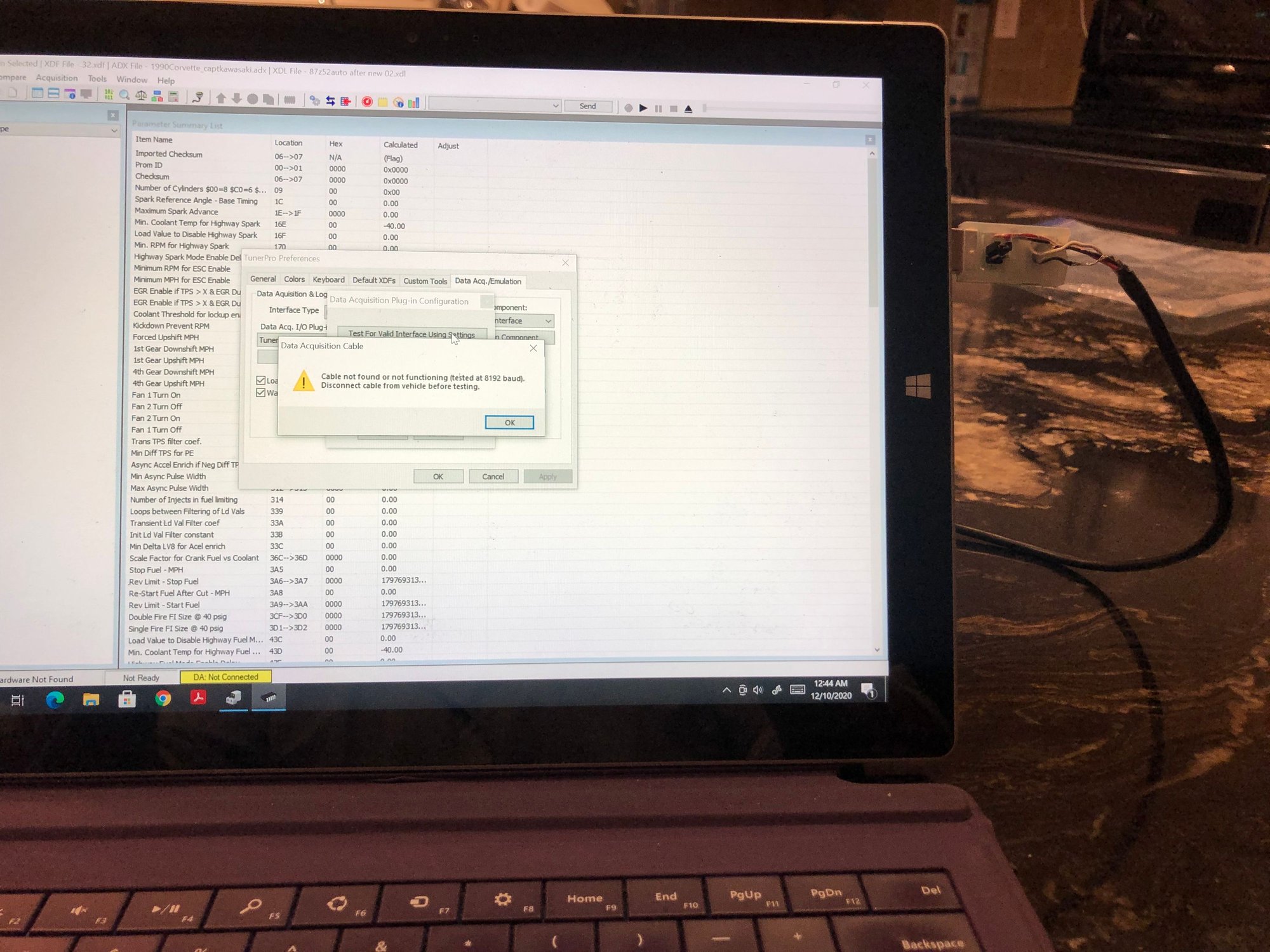

That said.....i did happen to stumble on what may have been the root cause. I scanned my 91 ZR1 tonight and it connected fine while i was holding the usb plug firmly squeezing btwn my thumb and pointer finger. when i released the pressure.....lost the connection!!

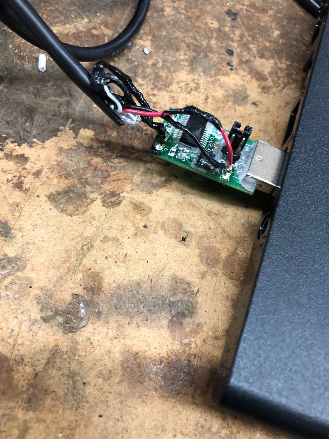

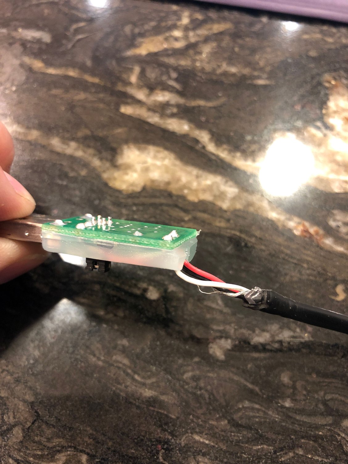

Ripped it apart and i believe i have cold solder issues on the mini usb board. pics attached. can now recreate the passed test for valid connection everytime while applying pressure.
will report back tomorrow. thnx guys.
no squuze equal fail.
squeezeing gives positive connection test
i believe the issue is the two solder points on the right hand side of board here.

i am not entirely sure which was the offending solder/chip but in the end i had to reflow the entire board using a heatgun while squeazing it in the vice and it now gives me a positive cable communications test everytime.
i found if i squeezed the board it would communicate. i gently squeezed the boar in a vice, then reflowed it all with a heatgun. seems to be fixed for now. this cable is from aldlcable.com and has been used about ten times.
