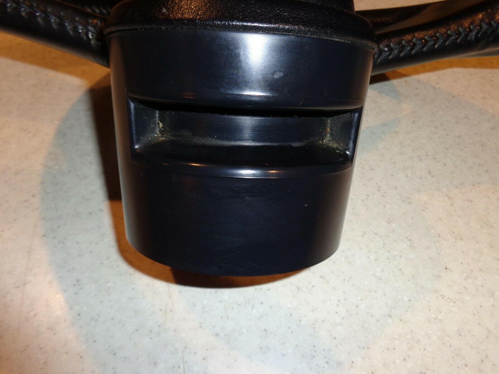

Hello and thank you all for responding. and yes it is the steering wheel that I want to peplace.. From what I have read the 84-89 steering wheels are the same. I am looking for some used oem wheels for sale that I what to buy as a replacement for mine. The one pictured is from an 89 and looks the same but it does mot have a cutout for my telescoping lever.

Tilt - telescoping column was standard on 84-89 Corvettes. Not an option.
Where did you find the wheel that has that cover?

Just to follow up, I don’t think you are seeing it from the proper angle. You are looking basically straight on to the recessed area, and the cut out section for the level comes from the steering wheel side which is obscured.
