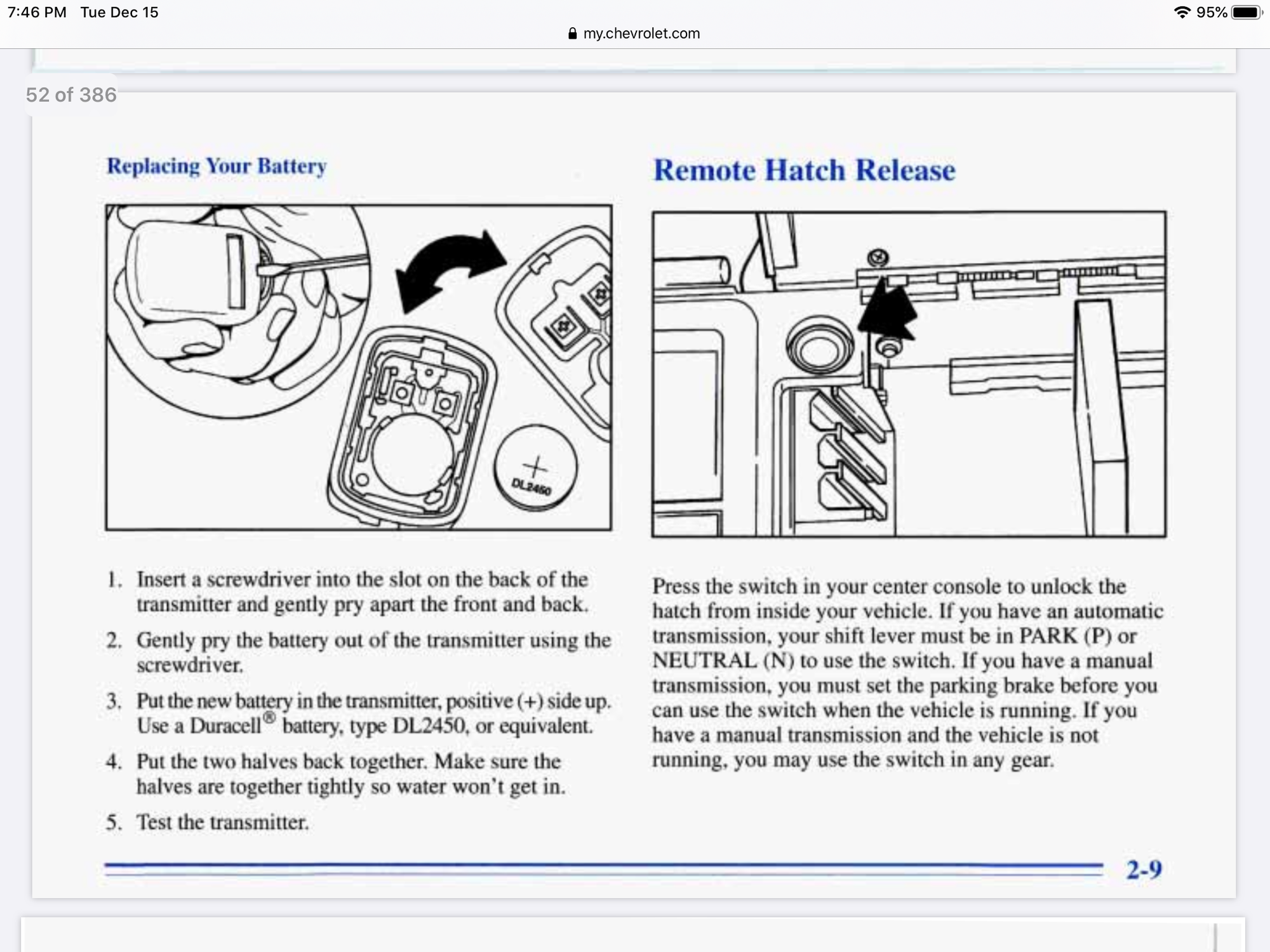

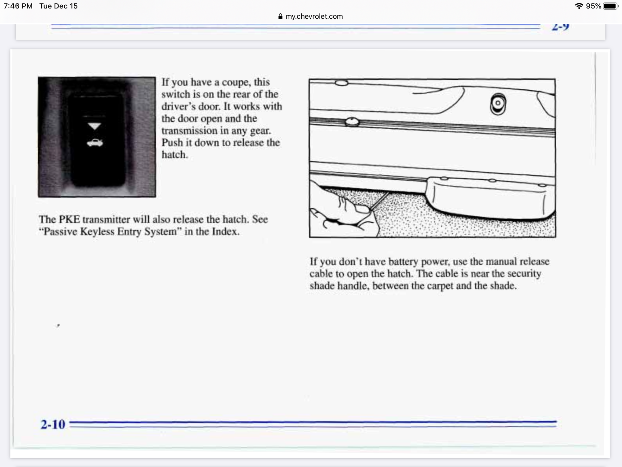

Check the rear of your driver side door. This is the 96 owners manual. My 96 had one.

Eh? 96 has it. pappy72 showed it. And here it is on my 96.

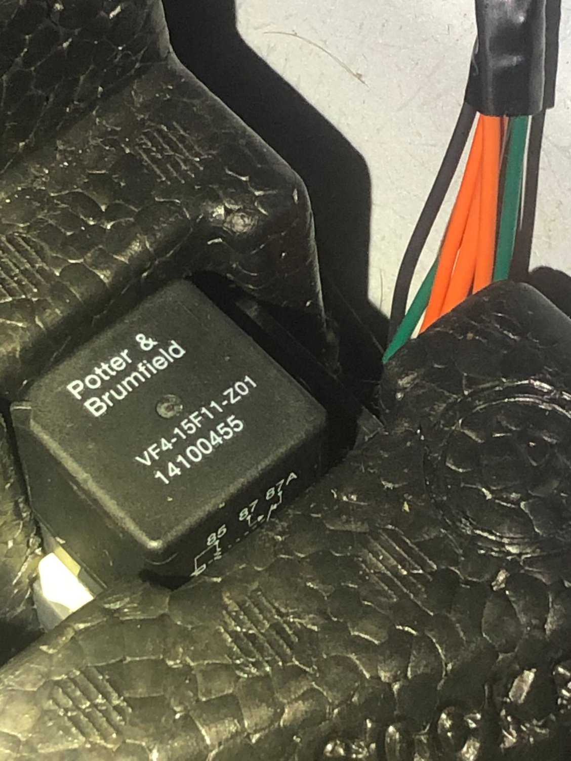

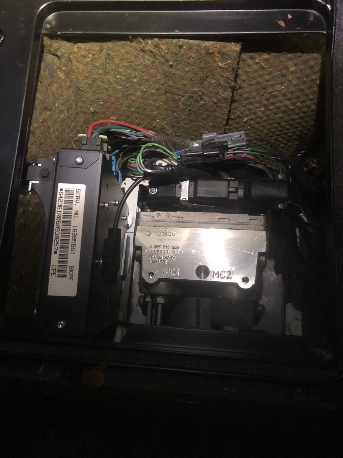

so I feel very foolish. I looked on the side of my door and voila!! The hatch button was there. First dozen attempts, nothing happens. No clicking, nothing. I jump in the car to do something and upon getting out, I clicked the door button again.. BOOM!! I worked!! It worked for about 5 minutes, before stopping. All the meanwhile the center console switch never worked again. The cube that I thought was the relay, must’ve not been it since it was removed while the hatch was working for that little bit. So now I’m back to square one. I removed the center console, checked and cleaned the connections going into the center console switch, and am debating on removing the door panel to clean that switch since I’m not the biggest fan of door panel removal. I feel as if there is a short somewhere, or...? I have no idea.
This is under the plastic compartment, behind passenger seat. This is not the relay I’m assuming since when I removed it, it worked miraculously for about 5 minutes.
This is under the screwed compartment, behind driver seat. I don’t see any sort of relay in here, nor do I even kow what that device is.

The components behind the drivers seat is part of the ABS system. The relay behind the passenger seat may be related to the audio system. (just a guess)
IIRC, the hatch switch on the door will only work for a short period of time after the drivers door is first opened.
