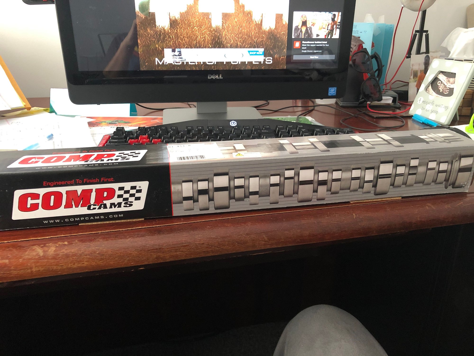

Hastings moly rings, clevite 77 bearings, stock bottom end, stone honed cylinder walls, comp cams XM284HR .547/.547 230/236, L29 heads ski jump smoothed, short turn radius work, valve seats are in good shape, so lapped valves, comp .300 rotator eliminators, pac-1220 valvesprings with 10 degree titanium retainers and locks, and new hardened stock length pushrods with the stock non adjustable valvetrain, Holley oval port efi single plane intake, 300 lph in tank pump, Siemens Deka 80 lb. injectors, Edelbrock 4150 throttlebody, pro-comp reverse flow aluminum short water pump, stock c4 corvette accessory brackets.

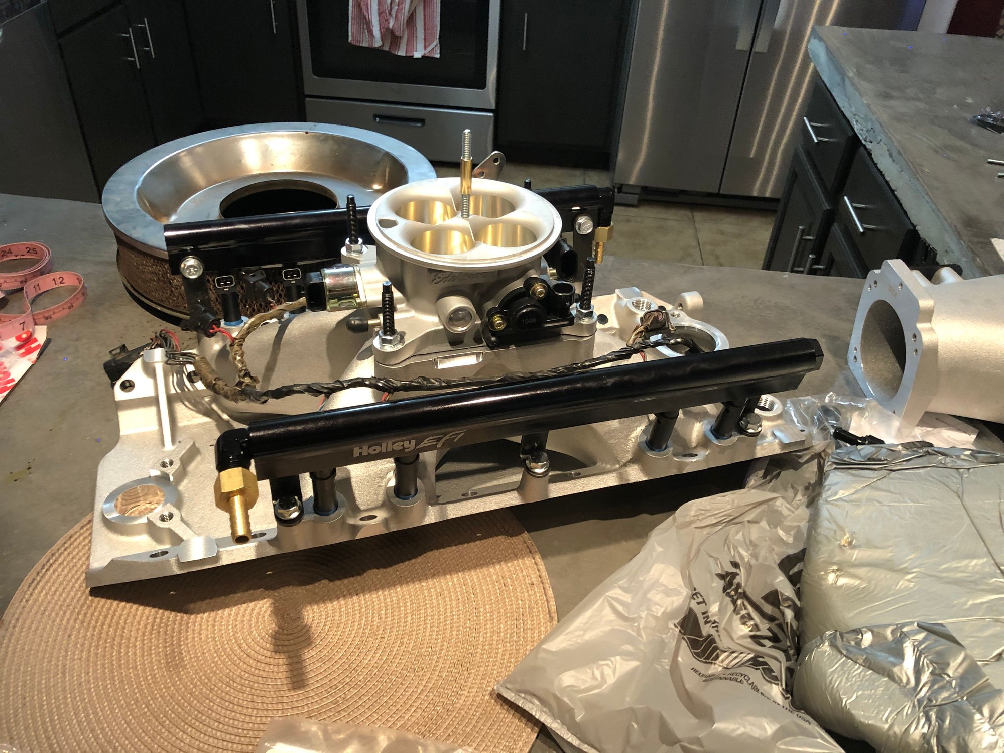

thats what is being built currently. After I recover from that financially, I would like to put a single summit racing s475 on it and run 10 lbs of boost (hence the reason for the 80 lb. injectors)
Intake mocked up on my kitchen counter. My wife was a big fan of this maneuver.

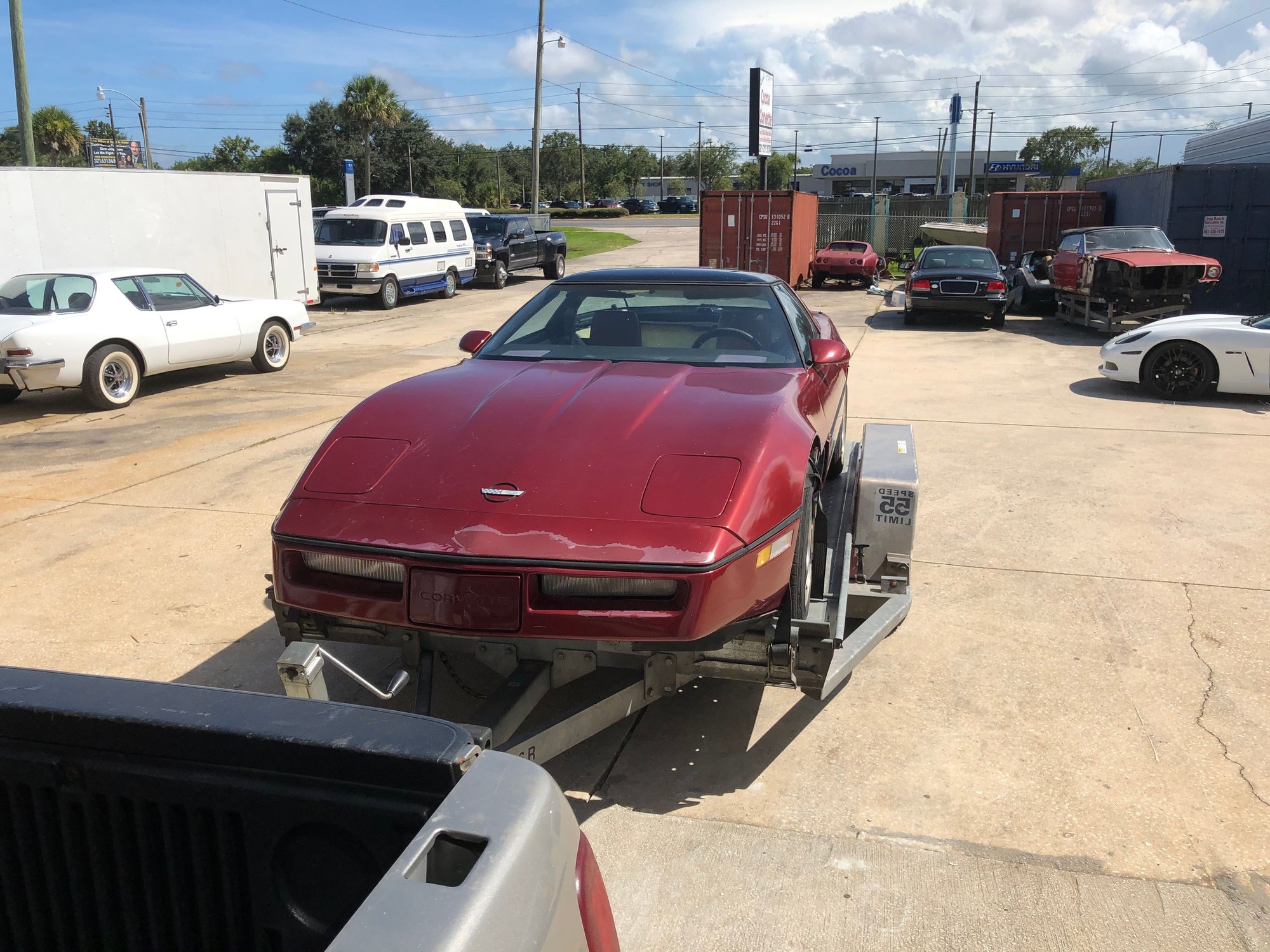

Me (in the green) and my buddy yanking the subject 454 out of my 84 SS (its getting a 468 all forged main and head studded edelbrock headed .612 lift Firebreather)

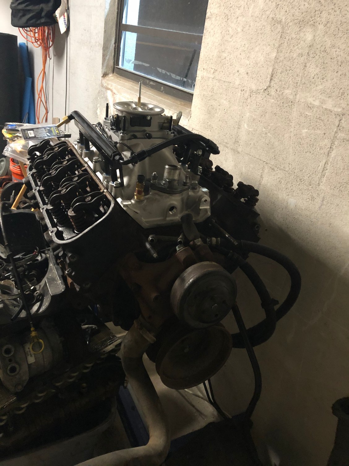

On the stand getting ready for the rebuild
The Corvette is a fiberglass Vessel, now with a mercruiser 7.4 in it, its only fitting the cam be a marine cam.
Cam specs

Mocked up

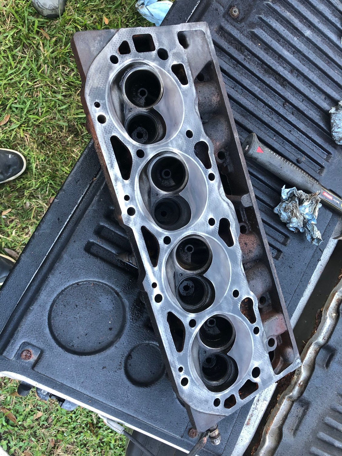

Head stripped bare

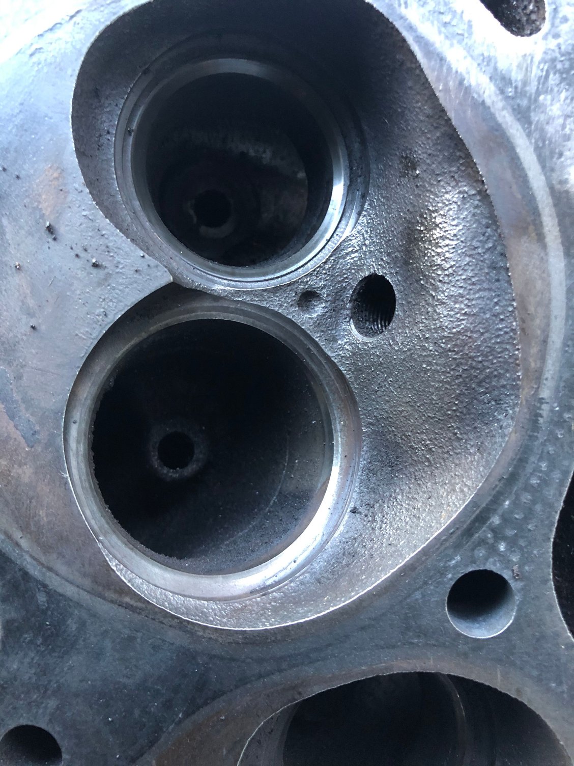

Dirty piston before
Dirty piston after
Dirty heads before
Ew

That's a baby cam for a 454. Though the marine grind comps work really well for whatever reason... nice fat powerband... I have a marine grind in mine. I like.

Its bigger than the cam that comes with the Zz454/502, and its right at the limit of ptv clearance, guide/seal to retainer clearance, and the stock heads really wouldn’t benefit from more cam.
I picked this cam for longevity, the ability to use the factory valvetrain, and it will work pretty well with low boost (under 14 psi)
pre turbo, with a good tune, this combination should be good for a very honest 425 horsepower and 510 ft lbs of torque at the crank.

For now, I’m using slightly touched up 1996-2000 Vortec heads, they have closed chambers, and a “ski jump” to promote tumbling. I’ll keep my eye out for some decent heads, but I want to try to do this as cheaply as possible for the sake of argument.
when I originally installed this setup in my monte carlo, the stock L29 intake is really just a marine intake, and it uses the mercruiser/ramjet common rail fuel injector, which is a huge pita. I think I spent a month having to drive around with a tool box, and had to stop in numerous parking lots, remove the upper intake and mess with the fuel rail because it kept alternating between having a massive vacuum leak because one of the injectors wasn’t seated all the way, and having a massive fuel leak because the fuel rail divorced itself from the injector.
the Edelbrock 4150 throttlebody plugs right in to all of the stock gm harness plugs, so thats a plus, it has an onboard map sensor that can be swapped out for a higher bar map sensor.
i actually consider the fuel system to be more conventional because it uses a standard multi point port per cylinder layout with one fuel rail per bank. Ultimately this motor will see boost, so I wanted something easily serviceable and tuneable.
according to my research, that setup will also clear a stock c4 hood, although I am still working out a filter method for it. I suspect it will be breathing directly through a x&n round air filter lid that is fastened directly to the top of it. Its not ideal but I bet it would work.
