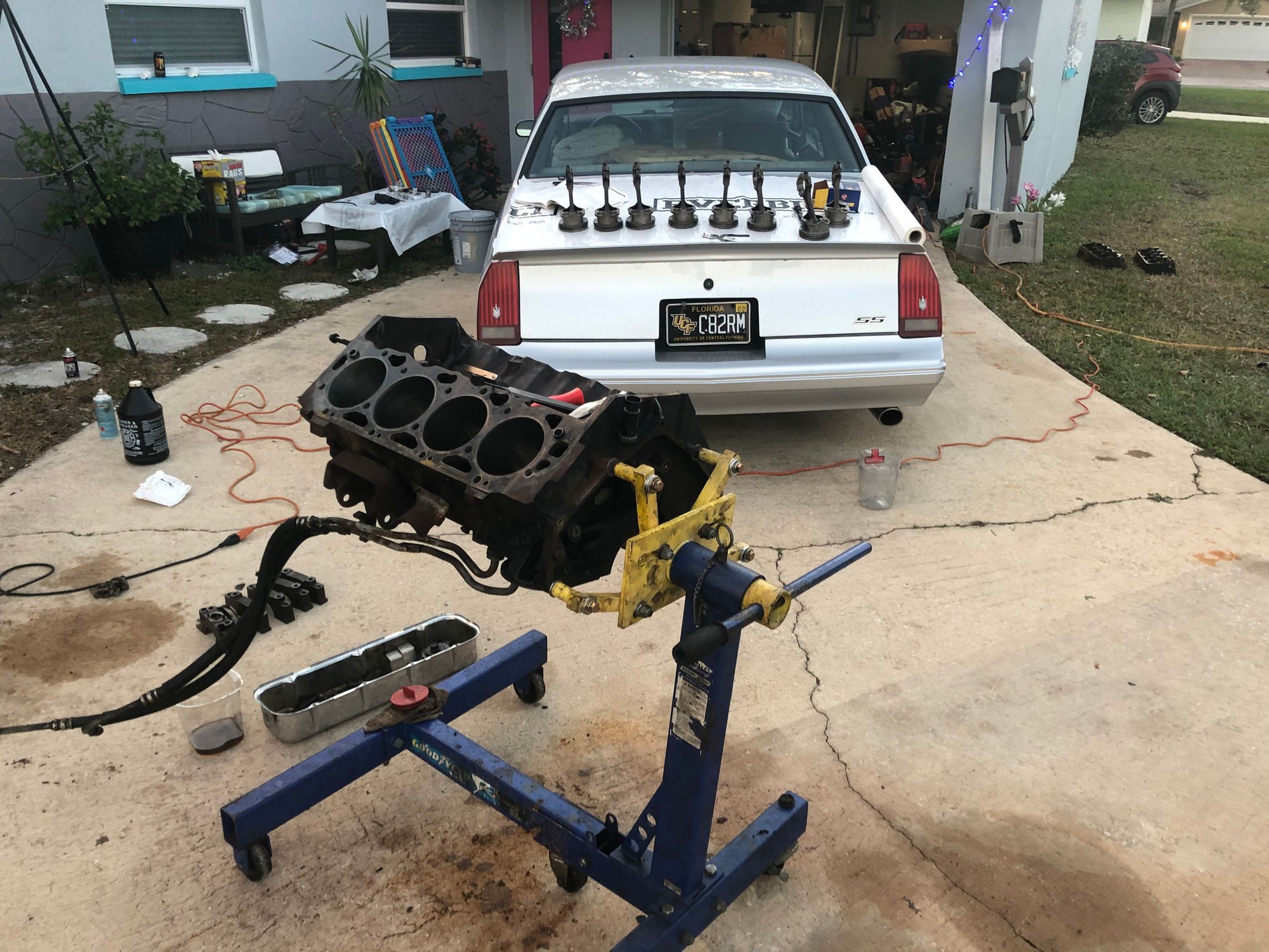

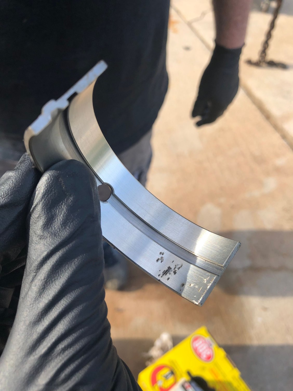

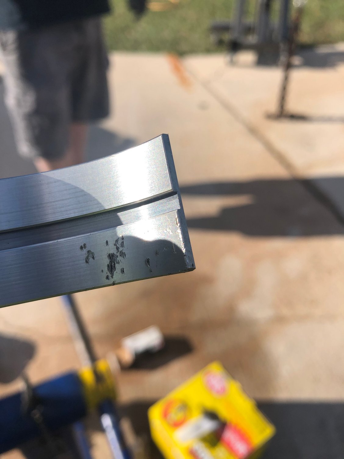

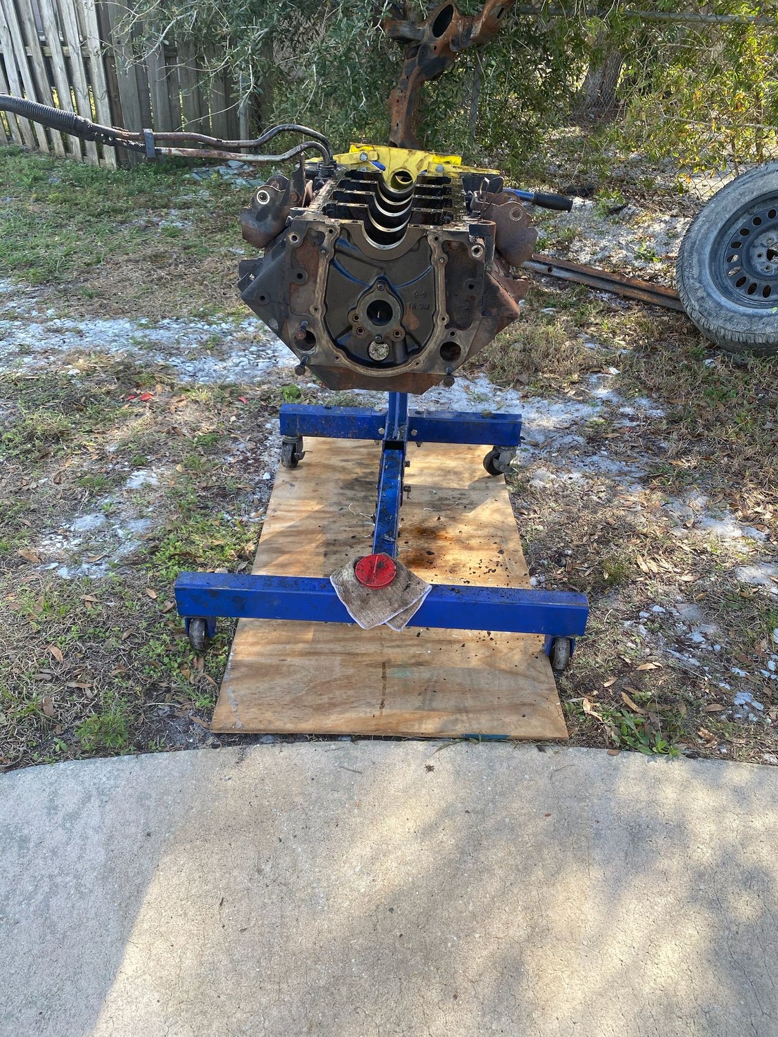

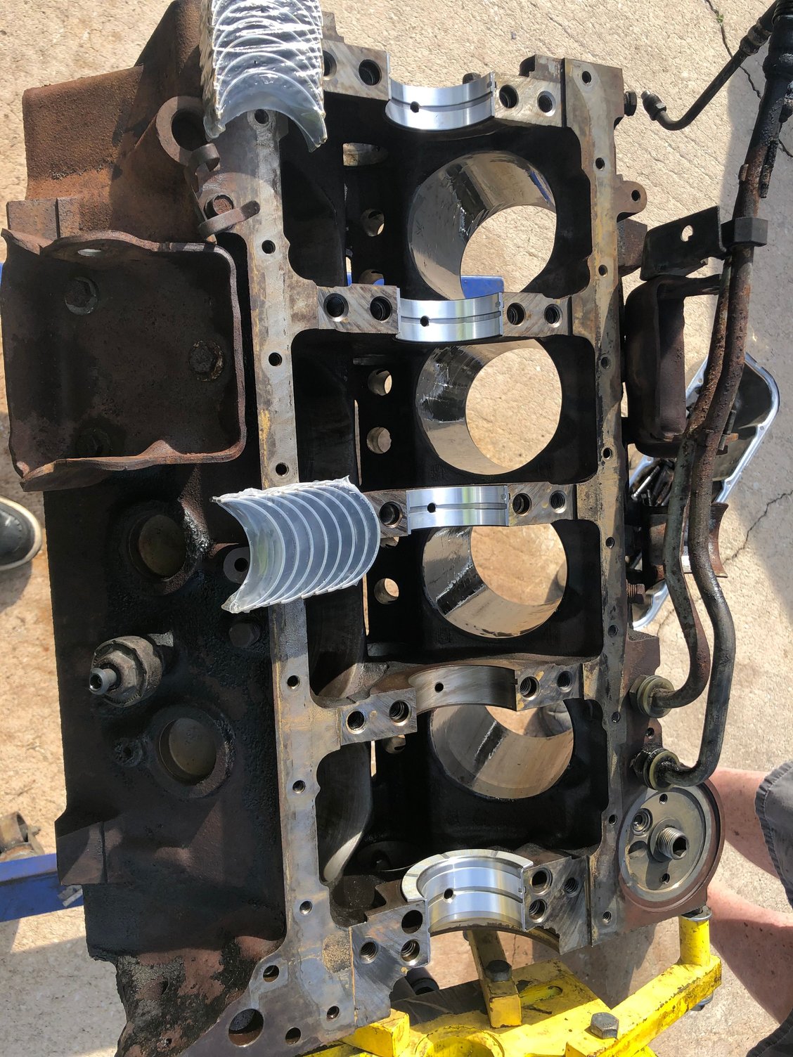

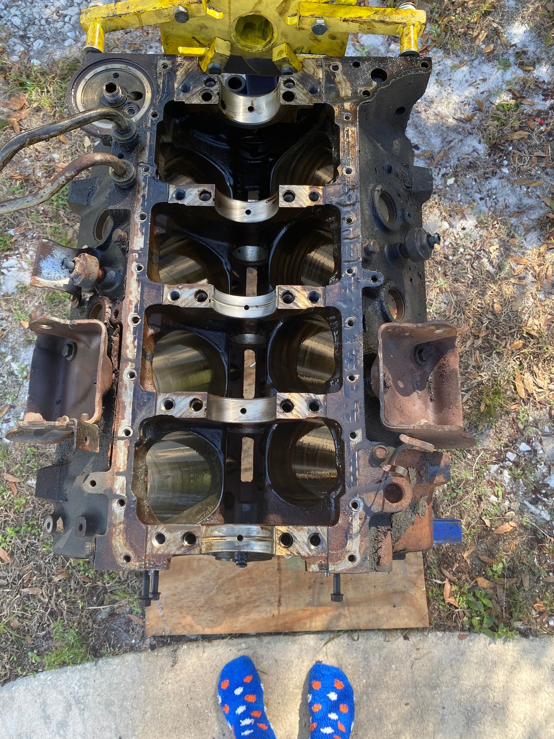

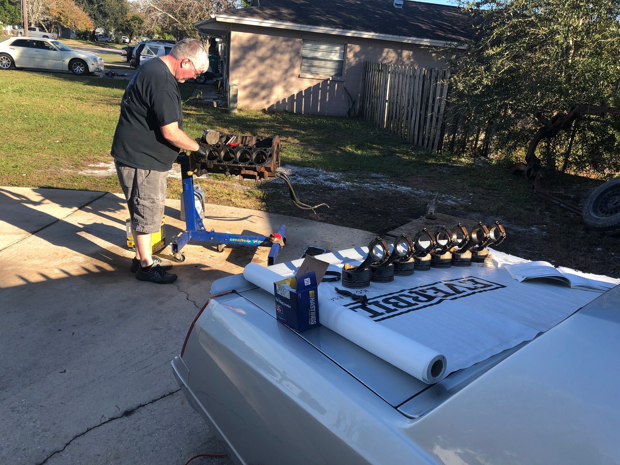

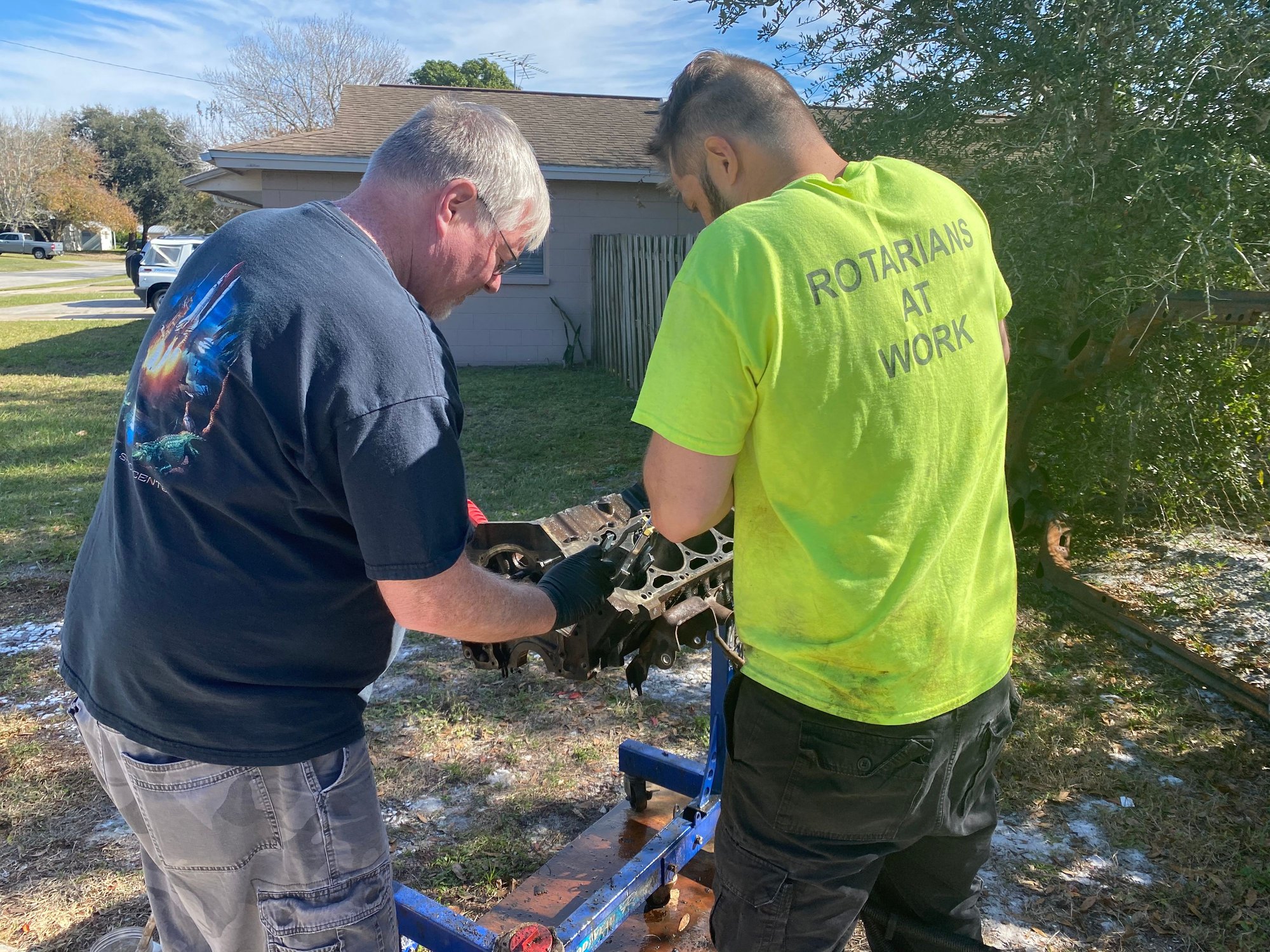

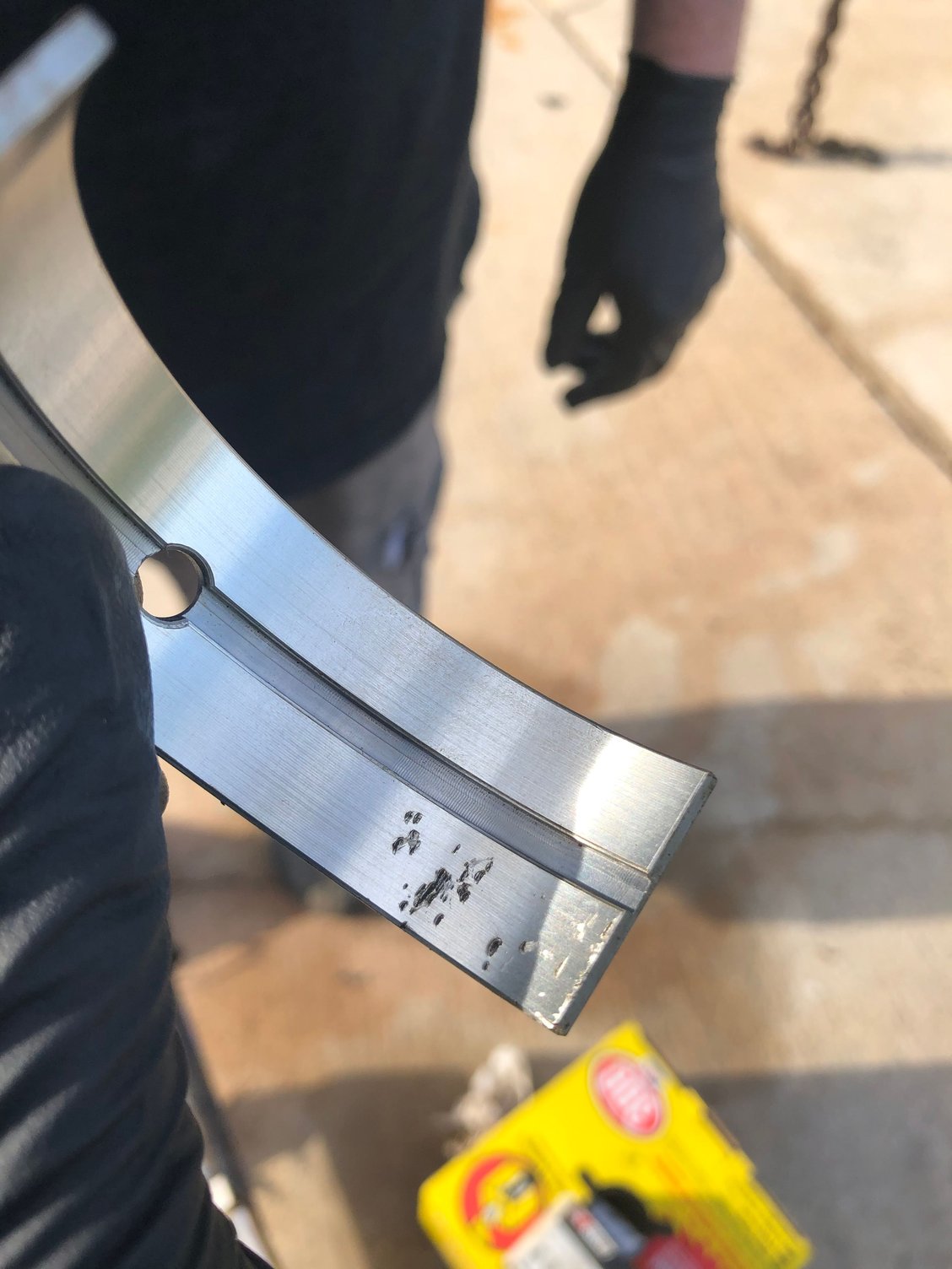

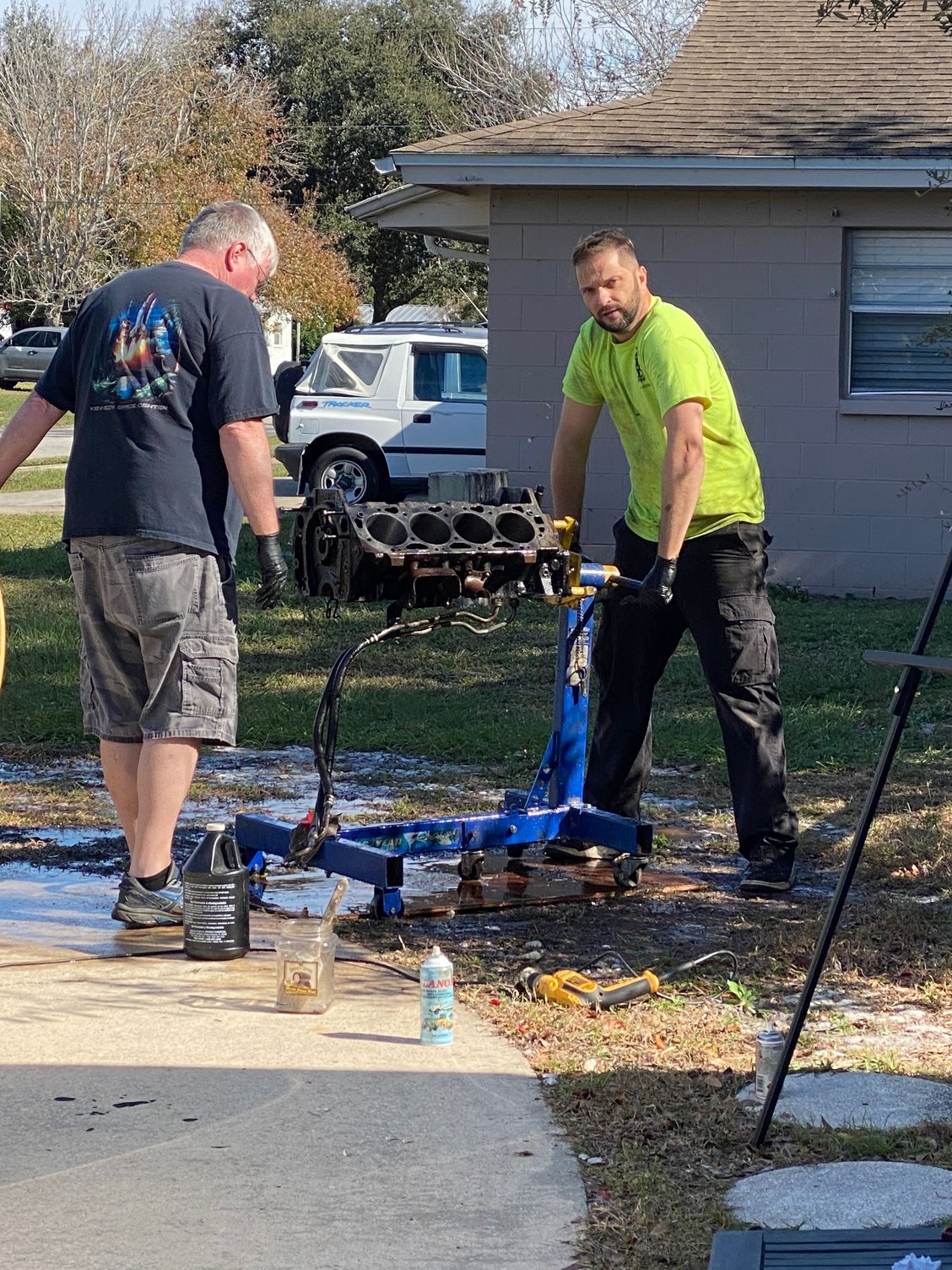

Made alot of progress today thanks to the excellent assistance of the invincible Jimmie Jacobs. Finished teardown, cleaned the block. Honed the cylinders, got almost a factory looking crosshatch pattern, although the number one cylinder looked like it was having an issue with heat that was causing some side loading. If This engine wasn’t nicknamed “Stopgap,” i would have sent this out for a .030 bore, and we unfortunately got sidelined by new part out of the box failures. King bearings are garbage. I typically use Clevite in all of my builds, but I tried King on the advice of a buddy, and you can see in the pictures, one of the brand new bearings was total trash.
Also I ordered 2 sets of 8 count valvespring rotator eliminators, and got 1 8 count and 1 7 count.
We gapped our rings, installed our piston rings, and finished the valvespring upgrade on one of the heads.

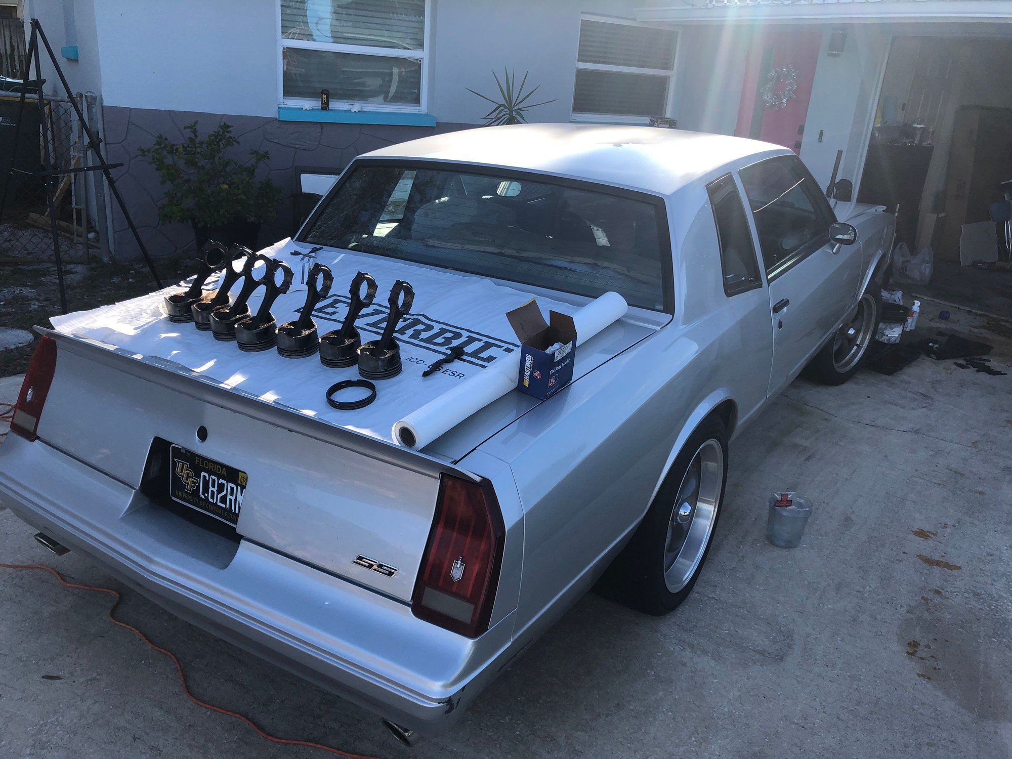

Haha thanks! Its our first house, and we got it at such a great price we literally couldn’t walk away from the deal, we basically had 40% equity in it the day we bought it, and we only put about 10% down, so thats really going to help out fiscally down the road.
unfortunately it only has a 1 car garage, which has to fit the wife’s baby wagon, and a foldaway home gym deal, a washer and dryer, hvac, and we’ve been super efficient with shelving, and utilizing the attic as much as possible, but theres still really no room for working on things in there
I do love that monte though. Its my third one. Its an efi 454 4l80e, 8.5” gn rear car. It needs the drivetrain put back in, and I was working on suspension brakes and interior.

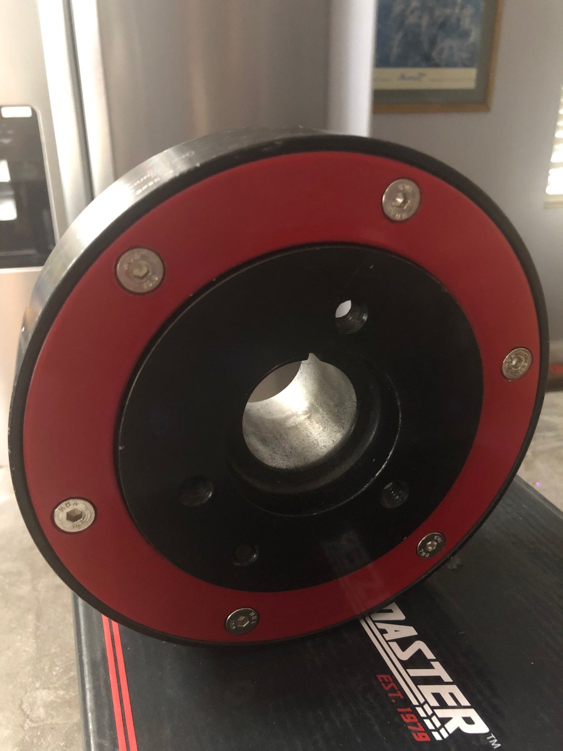

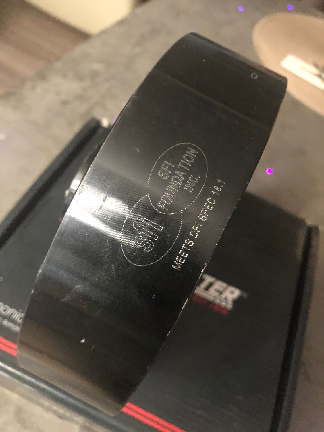

otherwise, a brand new sfi certified external balance gen vi 6.75” balancer arrived today, so I won’t have to cut the crossmember to clear the balancer.
