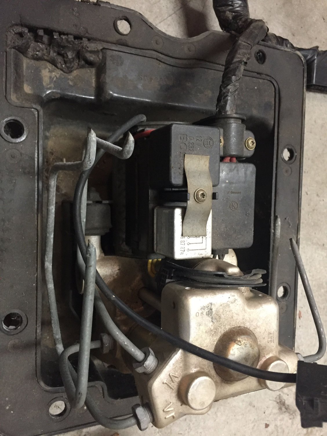

Happy New Year to everyone.On my 89 4 spd. The anti lock light was on in the information center. I ordered and received the four prong rely that sits on the pump motor. On YouTube is a video about the anti lock light coming on and a relay that powers the anti lock control module. That relay has two red wires on it. Does anyone know where it is in the car? Is it now available?
I have TurnerPro RT It does the codes but I do not think it does Anti Lock brakes. Do I need the diagnostic tool to do this? Is there a substitute I can use?

86-89 is off board diagnostics. You need the Kent Moore tool to perform the scans.
The relays are mounted on top of the ABS pump.

Is that the only relay. That is the one I replaced. Someone on FB sent me a CF thread about the ABS light. It is very thorough. I think I am going to look at the wheel sensors for dirt. Oddly enough this started just as I was planning on changing the rear wheel bearings. One of the bearings was very dusty. That may be the culprit. Thank you all
