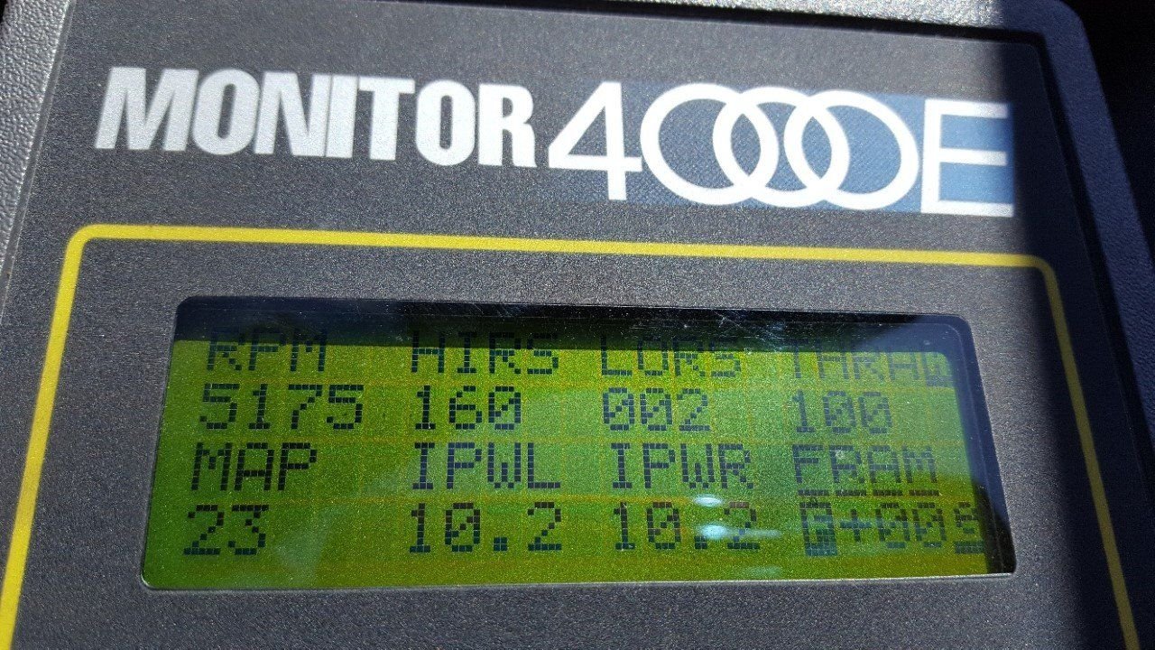

You need a scan tool that has a data stream function (a good scan tool, basically). Or some kind of way to interface w/the ECM, using a laptop or phone/AP. Anyway, you need to buy, borrow or befriend someone with the electronics required to let you data stream. It will let you SEE what the ECM/engine is doing. Here is a pic of me running data stream on my scan tool so I could watch my opti (among other things) while the car was running:
....and here is a vid of the same problem.
See how you can see everything functioning? I think that is where you're "at". If you actually do have spark when it stalls, you do have fuel, your injectors are firing, and you truly have no vacuum leaks....then you need to look into the operation of the sensors and actuators so that you can see what is not doing what it should be.
