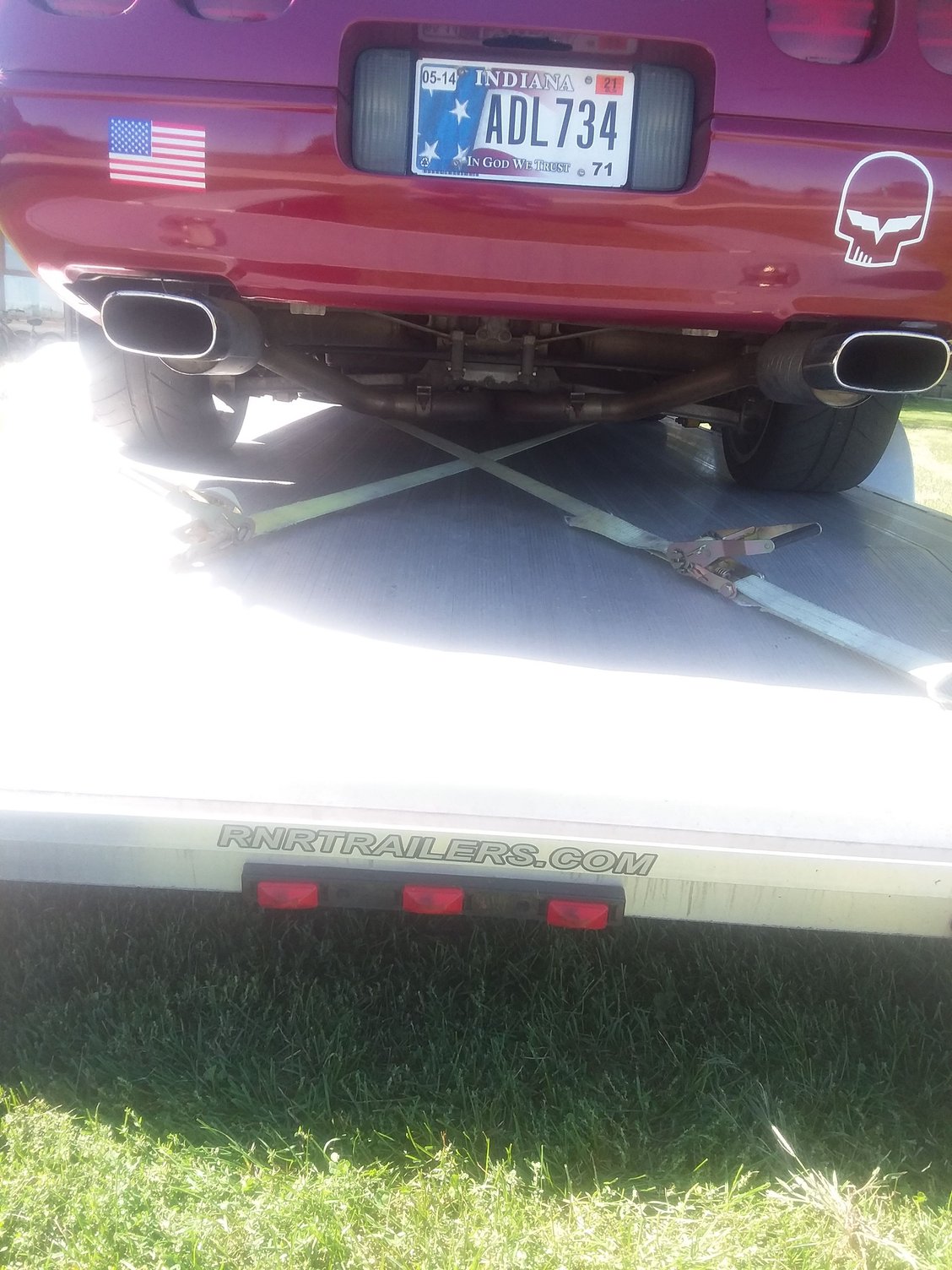

Originally Posted by vettehardt
Here is what i do..... I have to cross the straps.
Found a pick of the crossed straps. Sorry it was a very sunny day so lots of glare off of the trailer.
Originally Posted by ihatebarkingdogs
How do you get the strap from the frame tie point to the ring on the trailer? The tire is in the way of the straight-line trajectory. (I don't see rings on the trailer in a position where a trajectory from the frame tie point is possible). How can the guy with the trailer above use the frame tie downs unless he adds rings directly in front and to the rear of the frame tie points?
Originally Posted by Tom400CFI
EASY. Cross the straps.
BIngo. Cross the straps.

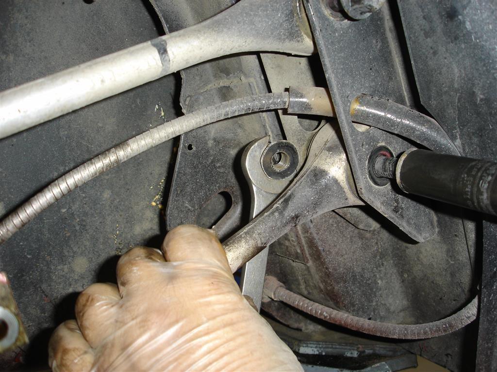

Partsgarage is right; not HOOKS, but "Hook receivers". They're right behind the lower control arm in the front (see that oval hole in that ear that's protruding down, just to the left of the rear LCA bolt head in this pic?:
