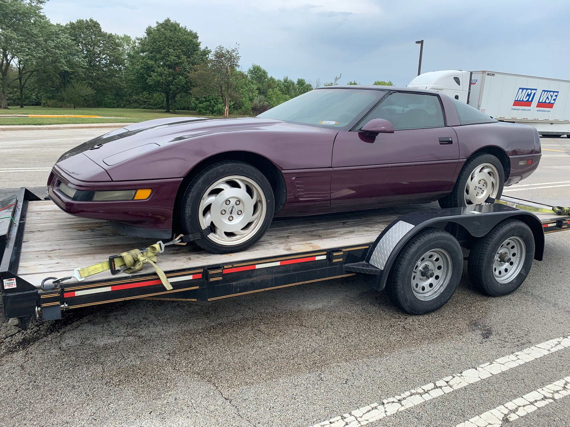

I have just bought my 3rd C4. I will be picking it up with my enclosed trailer. I was wondering if this type of tiedown strap will fit through a stock 94 non-ZR1 wheel? it looks like it will. Any other hints to Tie it down for a 6hr trip?

I was worried about the same thing but a standard ring goes through the spoke easily. Here how I've done it on an open trailer.

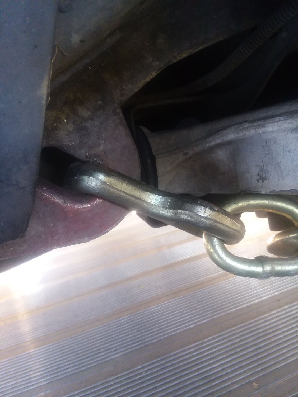

I have always used the T hook fittings in the frame rails to secure any car on a trailer. YMMV.
Ditto. You don't really have to use the actual T-hooks if you can't find them easily/quickly. I used quick-links (I forget the size) through the holes in front and rear. You might be able to use anchor shackles, too. The two big advantages are that you prevent the chassis from moving around while towing this way, and you don't risk any marks on the wheels. This is how the factory ties the cars down for transport, so it seems like the best way to do it.

The factory installed the special brackets for hooks on the frame, front and rear. "Nuff said."

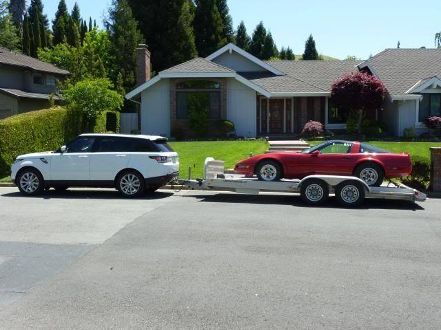

Originally Posted by ihatebarkingdogs
The factory tie points are intended to be used with commercial auto transport equipment or railroad auto-racks that have winches positioned directly below the frame tie down points. the intended trajectory is straight down. Most hobbyist trailers don't have suitable anchors for use with the frame tie downs.

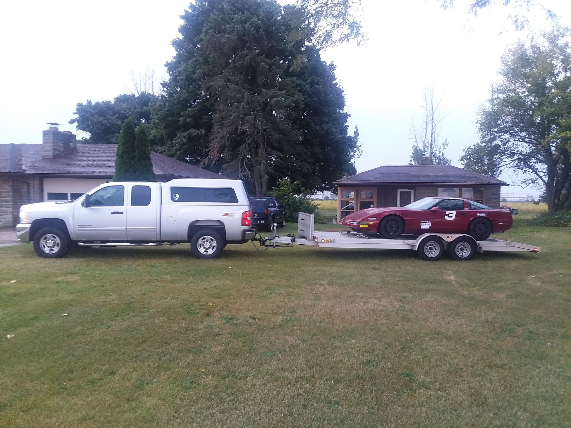

Any of you guys advocating the use of the factory frame tie-points tell me this:
In the pics above (they are both the same trailer, different cars), How do you get the strap from the frame tie point to the ring on the trailer? The tire is in the way of the straight-line trajectory. (I don't see rings on the trailer in a position where a trajectory from the frame tie point is possible). How can the guy with the trailer above use the frame tie downs unless he adds rings directly in front and to the rear of the frame tie points?
Having trailered my C4s about 50,000 miles over 15 years without so much as a scratch, I like the wheel straps for the trailer pictured. The only thing I see is that the wheel straps induce side loading on the steering rack (fronts) and the toe link (rear). While not ideal, this is probably not a big deal. For an open trailer, it looks pretty good to me. BWTFDIK.
I have an enclosed trailer. Because of my yard storage limitations, it is only a 96" wide trailer. The fenders are inside the box, about 5" above floor level. It is pretty much impossible to access the frame tie points with the car in the trailer, because it is impossible to lay beside it and reach the points. I'm a little guy and I can't do it.
Three guys here have said "use the frame tie points". Sure, it makes sense. But I'm curious. How many of you have actually used them successfully with a typical hobbyist trailer and equipment?
I do it each and every time I trailer anything. A wooden deck trailer is not ideal for auto transport, that is why you should have something like this.
Easy access from underneath to any frame tiedown point.
You didn't answer my question. How does the guy with the trailer in the pics use the frame tie points?
That is a nice trailer in your pic (obviously not your trailer), and ideal for auto work. It would be nice to have a perfect trailer for every task. But most of us can only own one trailer, mostly from being practical about storage. So the trailer we choose is a compromise. Most of the cars I haul must go in enclosed trailers. (They are not beaters or race cars). Much of my post was in regards to tieing-down to the frame points in an enclosed trailer. Very difficult if not impossible, with most equipment.
How does the guy without the right equipment do the job ? Ask him, as obviously I don't know.
I drive everything I own (that is the entire purpose of a car) so I can't comment on tiedowns in an enclosed trailer. I agree that it would be very difficult (if not impossible) to get under a car in one, but maybe attach the T hooks while the car is outside the trailer and then use ratchet straps once inside.
EASY. Cross the straps.

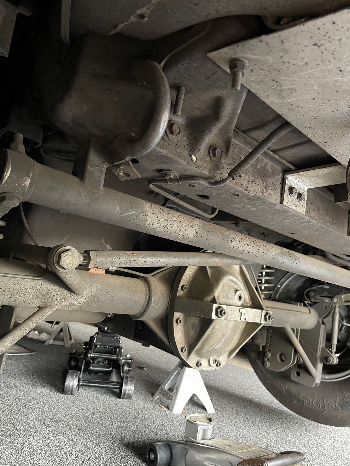

Here is what i do. I use the t-hooks in the factory tie down locations. The front i have no issues with. The rears, because of the locations of the anchor points on the trailer, I have to cross the straps. I ran without crossing for quite a while, but that put pressure on the shocks and popped the bottom of the shock off of the bushing (pics below show not crossed). If my anchor points were 8-10 inches inboard than where they are now, I could run them straight like shown in pics.
My dad has an enclosed trailer to tow his 90 ZR-1. He uses the through the wheel method in the rear. He uses a strap around the sway bar to tie down the front.
Rear tie down point
Front tie down point
Shock popped off of bushing. Pressure from straps pushed on the shock. I got the bushing back into the shock and then used some large washers to try to prevent this from happening in future.
