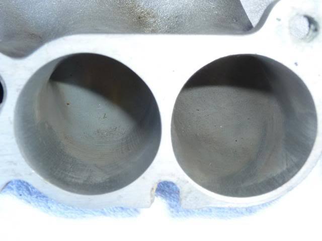

I just called Extrude Hone in SoCal. They want 800 to extrude hone a SuperRam. Here are pictures of mine.

Mine looks the same. I bought it already honed.

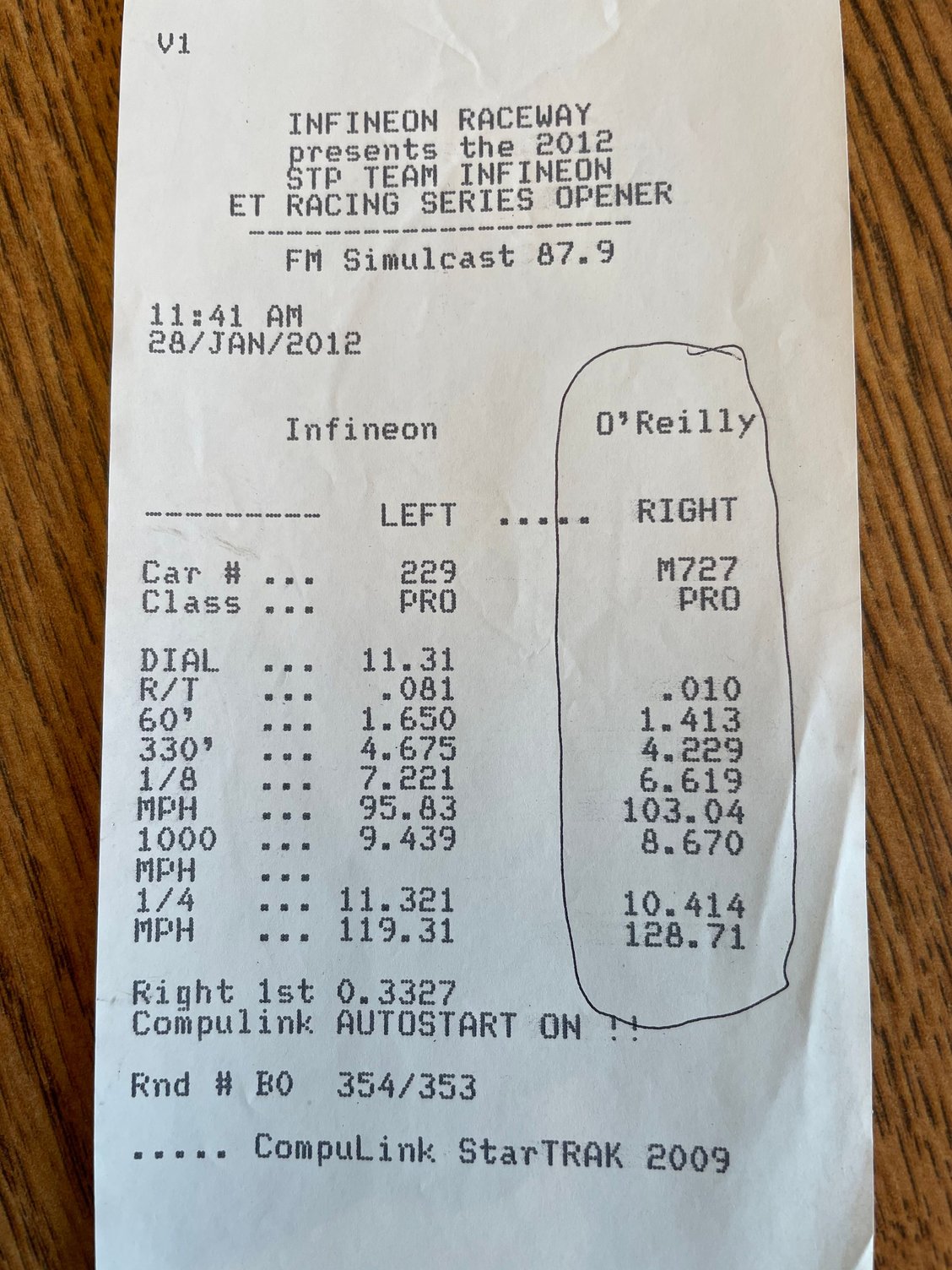

I posted this timeslip on a previous post. 9 years ago, I ran an extrude honed SuperRam on a fresh 406. These things can move.

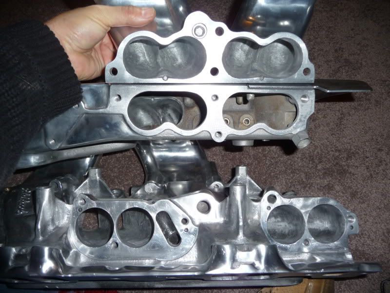

11 years ago, I ported the crap out of my 383 intake. It took hours and hours and hours and hours. It didn't help that I didn't have air tools!
The picture below gives you an idea of how much I did. My point is, after all that porting, I would have chosen Extrude honing given the chance for a "do-over". It's not because I don't think I did a good job. It's a combination of two things:
1) It was a lot of damn work that I would NOT be excited to do again.
2) No matter how good hand-porting is, FORCING abrasive material through ports seems the better option. By default, it's going to remove material at the "pinch-points" (tightest bends) and remove it evenly throughout the ports. In a way, you can think of it as a trillion years of abrasive air erosion in the ports...making it bigger and bigger.
Plus, as shown, the results can be impressive.
