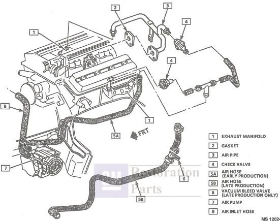

I have a 92 6 speed I need help with. I am trying to get info on a part (I think) that I might be missing. On the driver-side of the air intake filter housing, there seems to be a hose connection. In that same area is a small blower. I think there is suppose to be a hose connecting the two. Am I right about that assumption?

This help from a 95 LT1

Thanks, I think it is hose #8.
