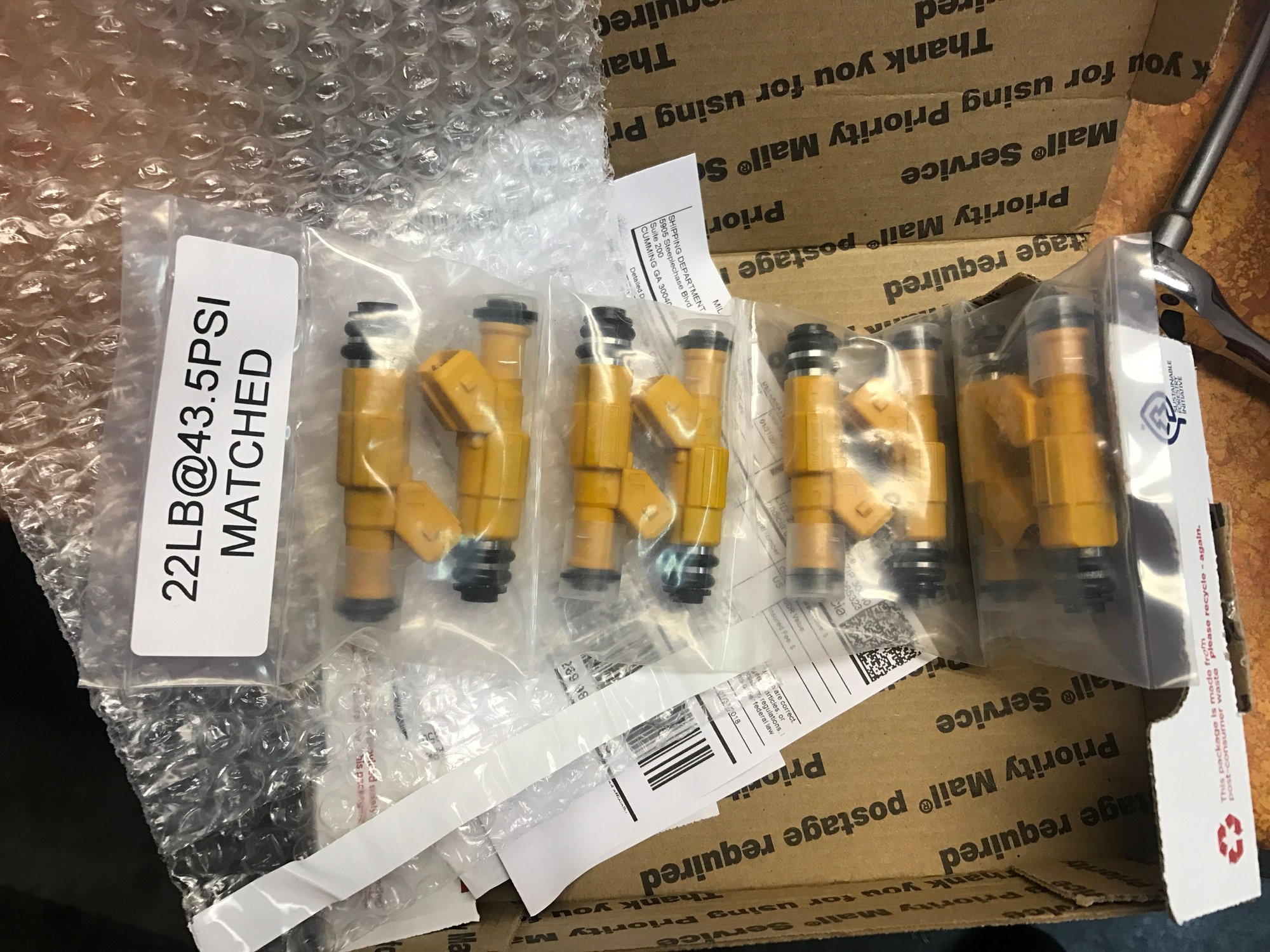

Nice work Ian. That was some good diagnosis.
As far as replacing injectors, depends on what your plan for the car is. If you are keeping it and plan on driving it all summer, yes i would change them. They are cheap, a set of remanned ones from john at fuel injector connection are very cheap. i put them in my 8) and it made a very big difference.
that said, the work, while easy, is long and arduous the first time. maybe its because i have an issue where if im pulling something apart i have to refurbish it. so i take much longer.

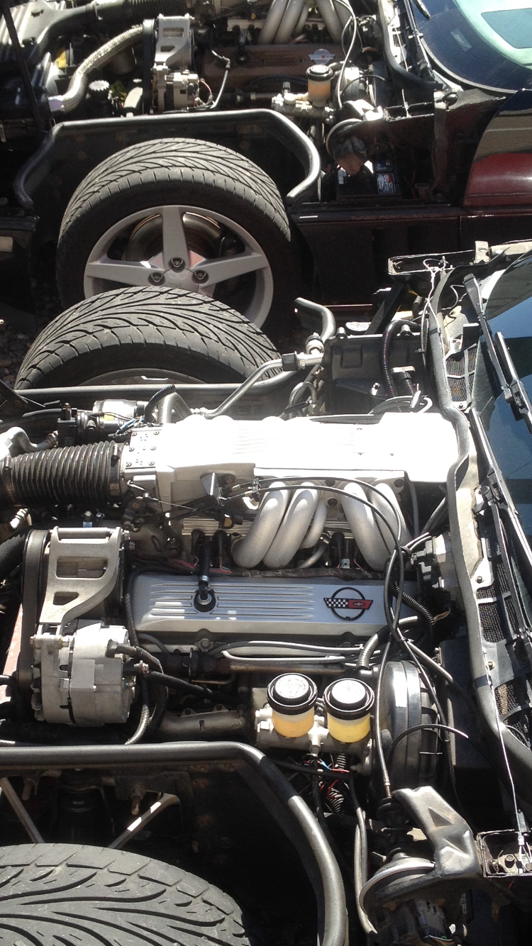

here is my 86 with new injectors. i cleaned/refurbed everything else while doing this.
Wow, looks like new...

Nice work it looks clean, did you repaint the valve covers?
I'm going to end up changing out the injectors I mind as well clean the motor up aswell.

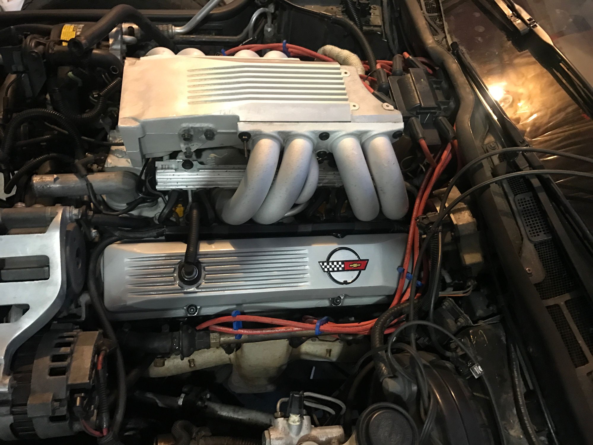

yep. refurbing vc’s to look that good is actually pretty easy if u do it right. mostly time for chemical to strip off paint. inside a tupperware with lid, under a plastic bag used like a blanket. several reapplications of stripper right overtop of all the lifted paint. several! i use the strongest brand i can find.
then i pressure wash them off (local wand wash fine if dont have).
then i sand the remaining paint flat with no lifting edges, there will be lots left surprisingly.
then i wipe with isopropyl alcahol and paper towel, not rags
then i lay sheets of tinfoil on the bbq or oven rack and i bake them at 250 for 15min. then more isopropyl alchahol wiping to remove the oil that always seeps out during baking of the ultra rough casting.
then i a high temp crack fill primer, mist coat.
then i use “aluminum” duplicolor high temp paint
then i use a can of 2k clear and i go EASY so i dont create runs.
also, sounds crazy but i heat the underside of the badge with a heatgun and pry it off, use a combo of small kids paint brushes and toothpicks to restore the color to the badge, then i 2k clear that with the vc’s.
to reapply badge i 80 grit the badge mount area to create tooth, and jb weld it on.
ive skipped the baking before.......and my paint bubbled. lots of debate about the baking being required or not. i never skip it.
done this three times.
for the tpi, simply use eagle1 etching aluminum brightner. if you are in canada its called alumabrite at napa. u have to ask for it.
do not, not, not, waste any time on the tpi without this (or other brand) of aluminum brightner. do not paint the tpi. dont skip out on the intake manifold! your intake manifold bolts will likely be seeping coolant at the rear anyway. here is my 86 finished.

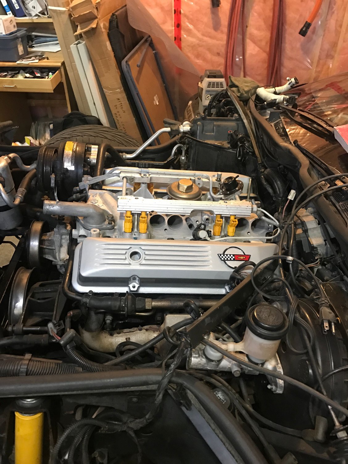

the 86 4+3
the 85 auto
cant find pics of the 87.
the rest of the underhood is just scrub and clean. i dislike this part. but its good as i typicaly find a few “about to fail and leave you on the side of the road” i wrap my looms in magic wrap. it has an appearance of factory loom wrap and with a 10-5% overlap it sticks to itself nice.
i usually push my black fastners into a cardboard box as i go then dust coat them with semi gloss (satin) black tremclad. just a light mist coat. look new.
i had more time in those days. whatever you do, enjoy the process and share the process!
the crevaces on concave depressions in the manifold will come clean. use the etcher. slight and i mean slight agitation helps. even the worst pitted ones come out great.
