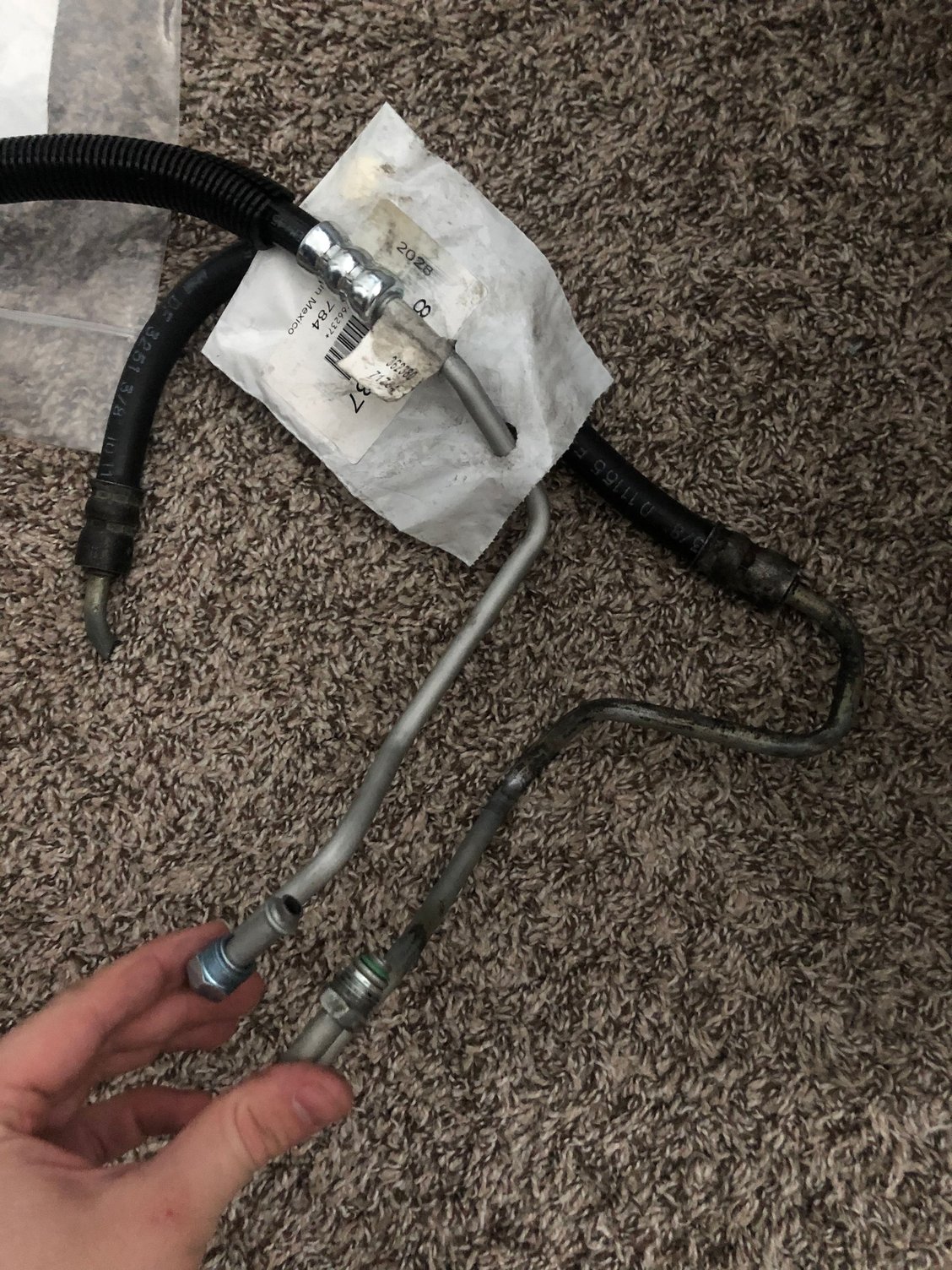

I know this is a common issue, but I can't find the solution.
So my 96 lt4 was spewing fluid like everyone else's did. I tried fixing it myself but ended up stripping the bottom bolt and got too mad at the project. I took it to a shop but we are having troubles finding the correct oem replacement. I bought the one that every site said would fit, but when comparing it to what was already on there, it's missing a u-bend that seems vital in avoiding the serpentine belt. I've compared it with other year model hoses but nothing seems to line up. I'm going to attach the picture to this thread. Anyone know what part this is? I am debating a steel braided cable but those are a bit pricey and I'm already not happy with myself having to pay a mechanic. Any advice is appreciated!
left new, right old

Your old hose appears to be for a late model LT5

I had this exact issue. You will never get that new one to fit.

I even looked at the 1995 lt5 motor ps hose and it still isn't quite the same. It has the u-bend but the rest of it is different

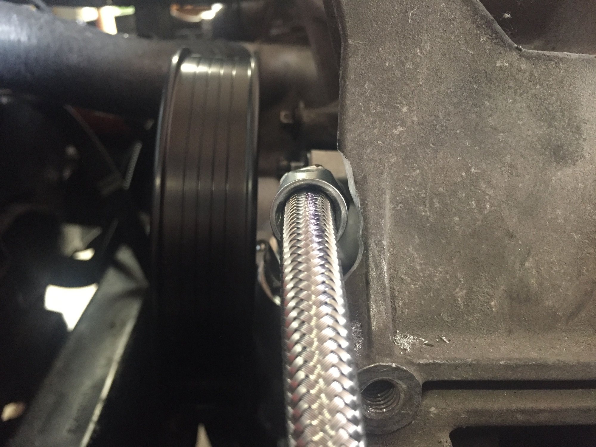

Do you know if there is a way to use the drm cable but not run it through the belt? is there an attachment or a way to thread it around the belt instead of through?

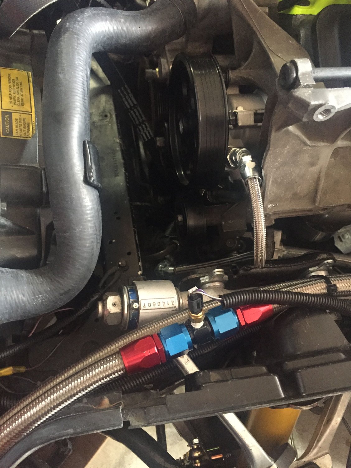

It gets tight in that area. I ground down the alternator bracket and cut a little pocket to allow the hose to fit through. But I also don’t have to worry about running an AC compressor.
