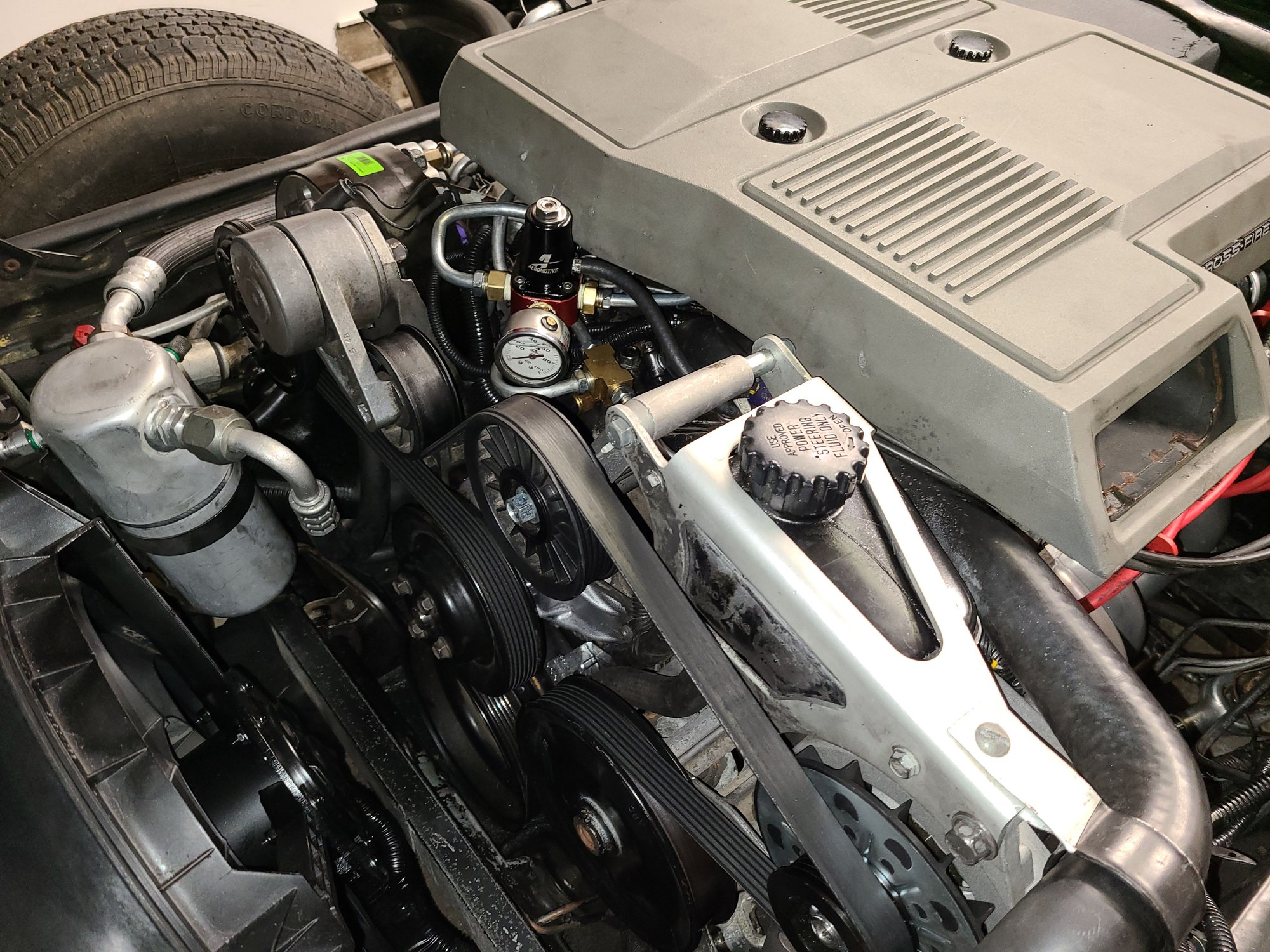

I used the pulley off a 94 c1500 with no AC and the belt for a 96 with no a/c it... worked nice....
All the tubes can be removed and the pipes going into the manifold can be capped with a standard NPT cap. I did other things so I removed it entirely. If you pull the front accessory drive all the parts can be easily removed. I boxed mine as if I ever want to go back I can.
P/N for belt: 5060870 dayco
​P/N for pulley: 34152 dorman
