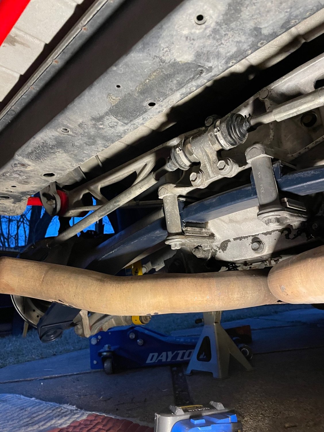

Based on the composite dog bones visible in the pic I'm guessing your car is a '96? Can I ask where you found poly bushings to fit the composite bones? When I did mine they were not available, only for the cast aluminum ones.....

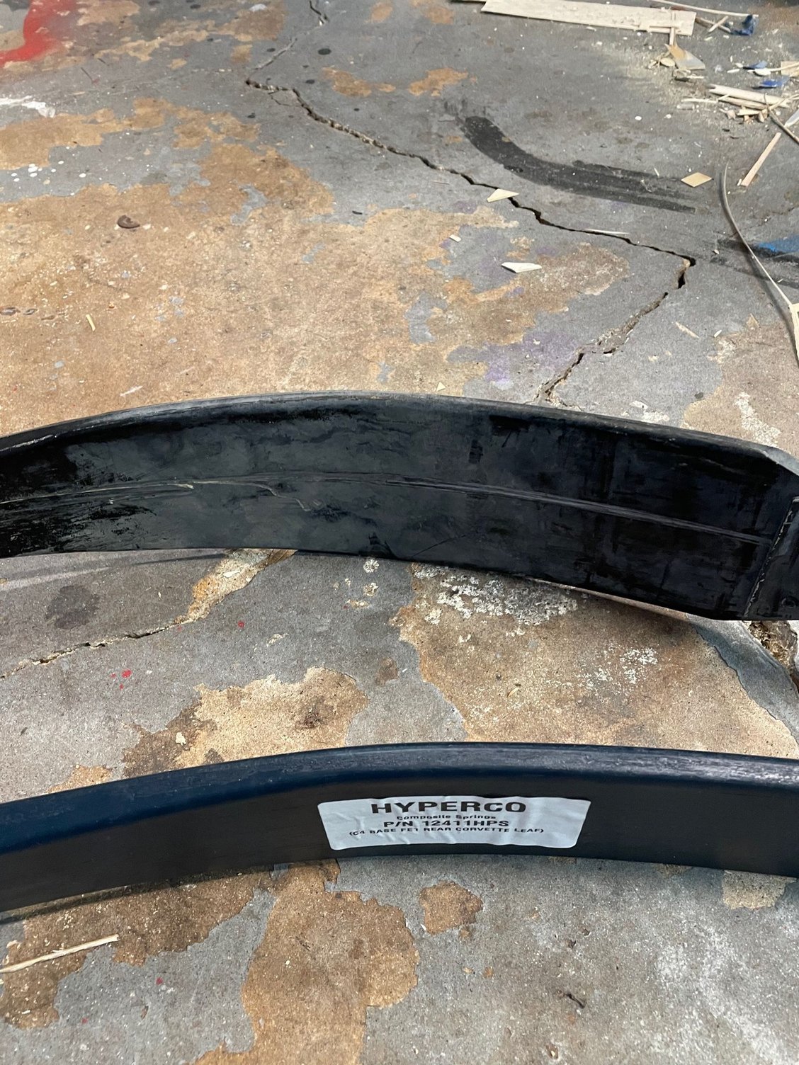

I installed a new leaf spring. I opted to go with the #218 FE1 spring. My car came with that or so it says it did. The ride is noticeably better. It is still firm like it should be and you can feel every crack in the road but it's not so bouncy. It used to be like riding in a minitruck. Also it feels as though the rear is more firmly planted on the ground. With the old spring it felt like I could snap the back end loose anytime. Now it takes effort to get the back tires loose.
The install was very easy. About 45 minutes total.
Then I decided to take out all of the none adjustable rear end pieces that had newly installed Poly bushings on them and re-grease them. I didn't have anymore of the grease from the company where I bought the suspension kit but it says on their website Marine grease is a good substitute. Typical grease doesn't stick to polyurethane and will easily go away after some drive time. The Marine grease is much more sticky like the stuff that came with the kit. I got some and applied it very liberally on the parts. The suspension is now totally quiet. It's like a different car.
The spring was not a cheap part at $519 through Ecklers and the shipping was killer too at $132. But the code took off 10% so that helps. Even at that price I am happy with the results and makes the car much more enjoyable.
New Spring on the bottom.
The original spring is way wider than the new one. The old one also had a split on the bottom. It doesn't go all the way through the sping.

Your old spring looks damaged, and it appears to have been a much softer rate than the new one, judging from its thickness and much greater arch. So you may have been hitting the bump stops with it, and the new one is doing a better job keeping you off of them. At any rate, I'm glad you got a fix.
