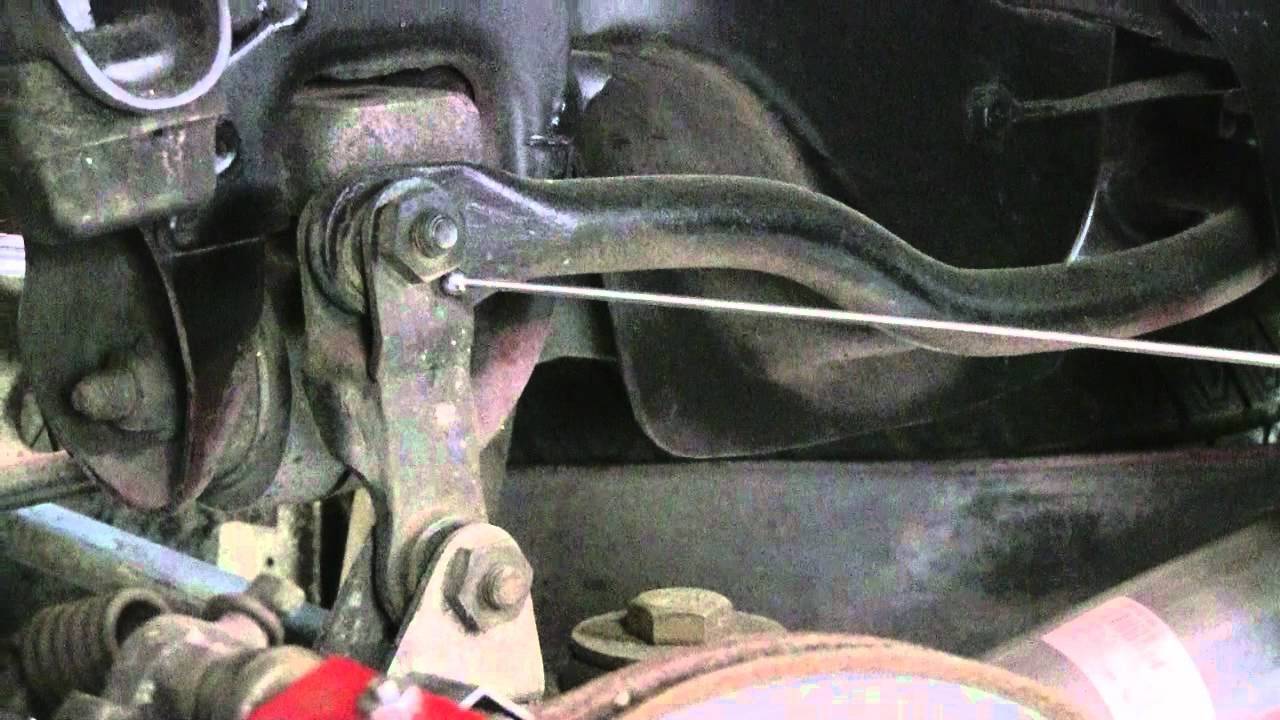

Here is a pic of the rear sway bar.

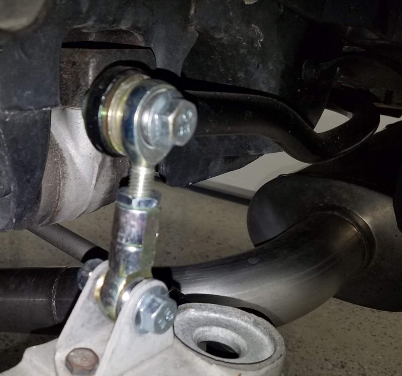

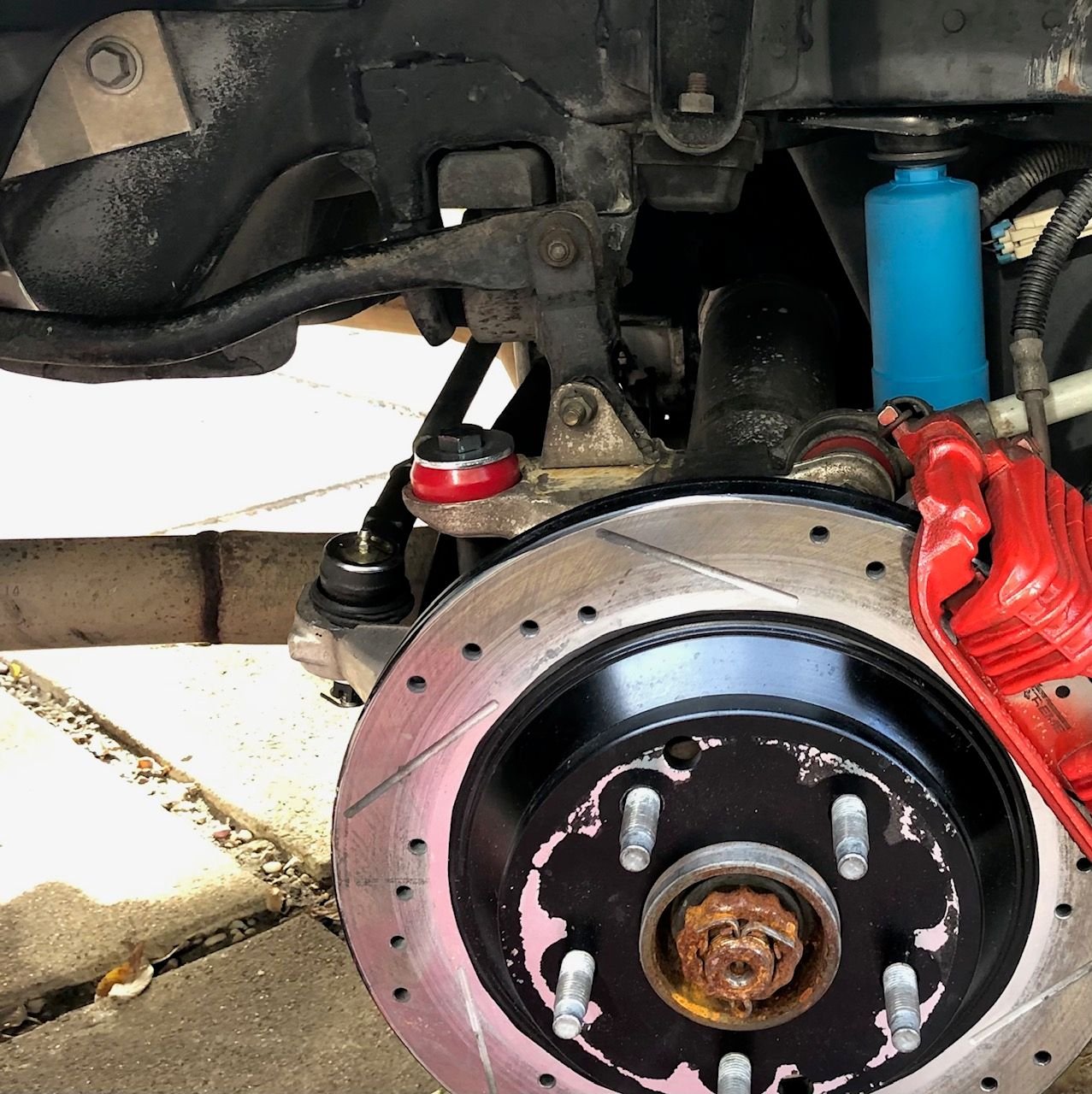

If all your bushings are urethane, then it doesn't matter whether the suspension is loaded when you tighten down the bolts that capture the bushings. The inner sleeve is supposed to rotate inside the urethane. The need to load it before tightening only applies to stock rubber bushings, because they are bonded to the inner and outer sleeves and work by twisting the rubber inside the sleeves. It's possible that rear urethane bushings is making the ride harsh. They do cause binding because they don't properly allow off-axis movement like the rear suspension links require. However, I seriously doubt they'd add so much bind that they'd cause the ride problems you're describing. I'm also sure it's not alignment or wheel balance or the shocks.
I think ChumpVette called it. It's hard to tell from your pic, but I'm pretty sure your rear sway bar is upside down. It has to do with the clearance between the frame and arms, not the center portion of the bar. The arms have kinks in them, and that kink needs to be facing down so the bar clears the frame. If you put it in upside down, it will fit while on the jacks, but when you set the car down the frame will be sitting on the arms and you will have exactly zero compression travel. That makes for an bad ride! You can probably guess how I know about this...
You can jack up the rear and pull a wheel off. Does the bend in the middle of the arm go up or down? Are there witness marks on the arm where it's hitting the frame? That will tell you what you need to know. Also, below are three pics of how it should be installed. If the bar is upside down, the bar will hit the shiny aluminum-looking piece above the swaybar arm in the third photo.

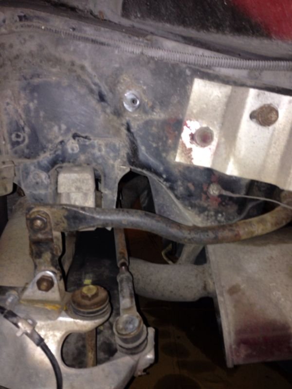

Here is a pic of the sway bar before I took it off. I matched this pic when I re-installed it.
If it looks like the pic you posted, then it's correct and shouldn't be hitting anything. I don't see any reason that the bushing changes should add that much to ride harshness - maybe a little, but not tons. Lowering 1" should not be a problem, but do verify you aren't sitting on the bump stops.
