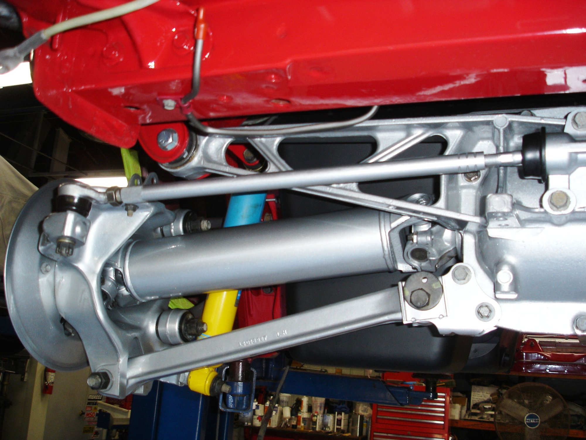

I will use this pic as reference,I had a clunking in the rear for a year before I found out what it was. It was the lower shock mount (it is the larger aluminum nut) that was loose. I put an arrow to check yours.

I don't think the whole stock assembly is available new.
The simple fix is to replace the rod ends, all four. The ones you have has greese zerks but seem very dry.
As they don't have dust boots they need some new greese at some interval to push dirt out or they will wear out sooner.

..... Nothing wrong with the rod ends ... they are spherical bearings and will rotate like they are doing in your video .....
..... How are the u-joints ? .....

I agree with C409, rod ends rotate around their spheres like that even when new. The proper test is for longitudinal play. You can grab the tire from the front and rear edges, halfway up. Try to rotate the tire around its vertical axis, like you are trying to "steer" the rear tire. It should have zero play in this direction. If you detect slop, then you need to replace the joint(s). Most likely those are off-the-shelf rod ends. You should be able to see a brand and part number on each, and you can get them from a million places. At the very worst, you can measure and order new ones of the same dimensions.
I also agree with check out the halfshaft U-joints. Those not only drive the wheels but also serve as the upper lateral control arm. They are important! I've also seen people say that if the teflon-coated washer behind the wheel bearing wears too much, it can allow noise.
