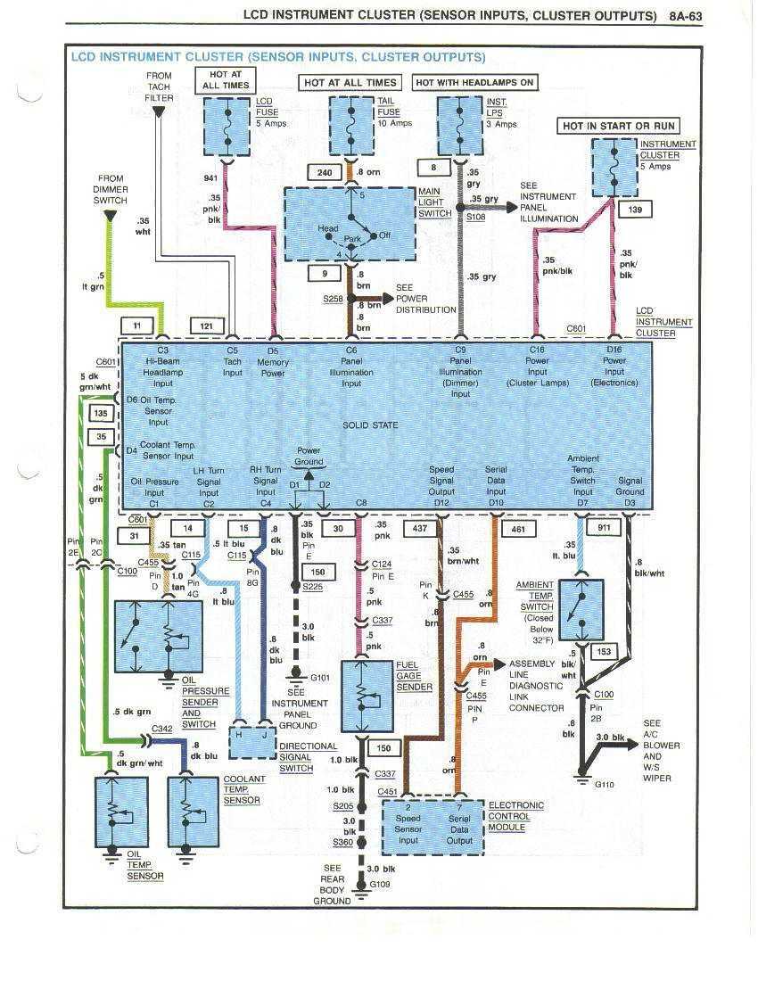

Since I’ve owned my car, the dash lights do not work. I went to Batee months ago and replaced the dash lights myself hoping something would work. Yesterday out of the blue, they started working and have been on for 2 days and now are no longer there. Where is the ground that affects the dash? It’s extremely frustrating and I’m out of options on what the problem is. I’m not technically savvy enough to understand so please dumb down the terminology for me. Thanks!

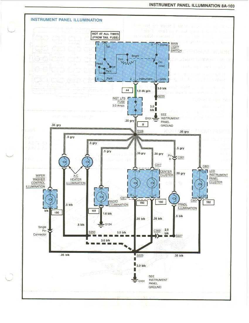

Here are some schematics.
When the dash is dark, do you have slight glow from turn indicators and high beam indicator? It is quite common with a bad internal gound connection between the two circuit boards and then the ground current finds another way thru those indicator lights.

it doesn’t glow when not in use. Before I replaced the dash lights, the screen would glitch and disappear at times but since I’ve replaced them, that problem has gone away. The turn signals light up when I use them and I think the high beams do as well. Only problem is the dash lighting up. Sorry I’m not electronic savvy. Where can I find the ground for the dash on an 84? Is it under the foot well on the drivers side? I’m debating if it is easier to send the car to someone who knows all about wiring and electronics instead of doing it myself because I’m very lost

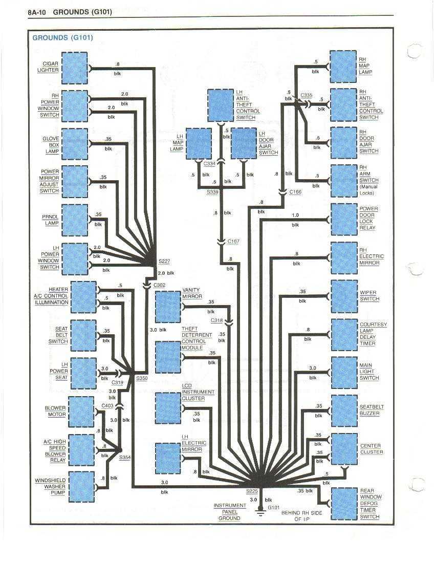

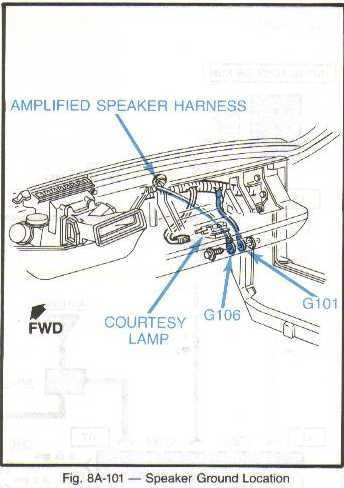

Sorry I didn’t take too good a look at your graph. Is G101 behind the breadbox?

The ground is near the door hinge on the side, but is is a comman ground for almost everithing. You shoudl have more issues than the instrument cluster if that was the problem.
