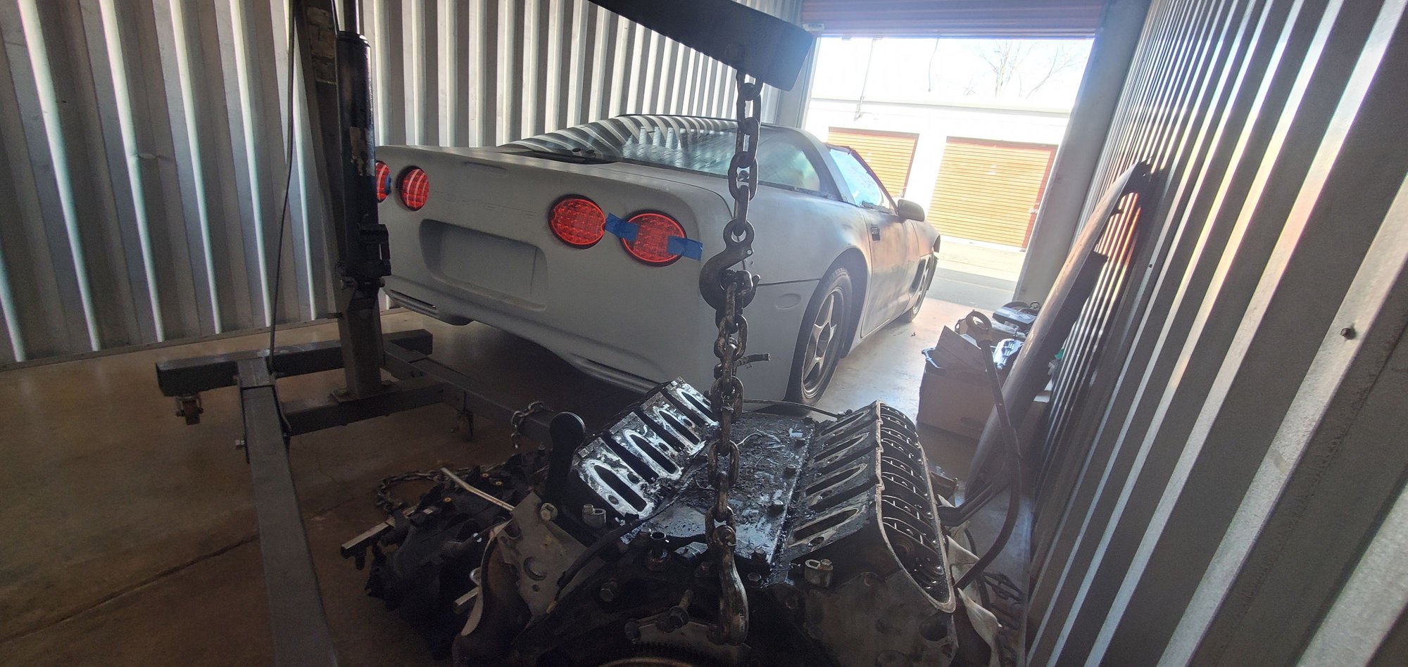

Hey all,
I got tired of having an L98 that occasionally ran but normally didn't due to electrical gremlins. I've spent the last few months researching and collecting the required parts to get my swap up and running over the course of a month. Here it is as it sits, the global situation means I no longer have access to a shop after hours as I once did, so found myself a roomy storage unit. PO started but never finished a C5 body kit, and the car now has an 84 front bumper as it should but I'm not sure how I feel about the door panels and vents just yet, I do like the look of the C5 rear bumper. Don't mind the gaps, all the body panels were thrown on with a couple of bolts, apparently, AAA won't let you tow project cars.
A Bit About the Swap Motor:
I decided to go with an L59, the iron block flex-fuel variant of the 5.3L, mine happens to be a Gen 3.5, a Gen3 Block with the beefy Gen 4 rods and floating pistons. I know lots of people on the forum don't like seeing iron blocks in a Vette because of no weight savings, but I got this engine complete with harness, PCM and a toasted trans for less than $200 and it looks like it was rebuilt in the near past. I was initially planning on just putting it in the Vette and working towards getting it running and driving but decided to do a reseal, high volume oil pump with stock relief spring, somewhat mild cam, PAC1218s, and a trunnion upgrade, oh and a very thorough degreasing and clean up job. These mods get me close to 350RWHP and low 300's for torque to the wheel(based on dyno numbers with a 4l60), which puts me about even with what the L98 made torque-wise and a little boost to HP, it is peakier than the l98 but that power is usable from 2200-6800RPM. I'll be keeping the truck intake for this build, low-end torque means a lot more to me than high-end power and it is a sacrifice I am willing to make, that said, the intake will be ported and I'll be using a 95mm TB. My intake choice does mean the hood will need to be cowled, I've 3D scanned my hood and designed a bolt-on cowl that I'll be 3D printing and glassing, just waiting on getting the motor in and getting final height measurements, once I know it fits I'll also be making it available on Thingiverse, as well as an LS swap air box, but that's a WIP since I can't even get mine off. My end goal for this car is to eventually boost it and get it to 600RWHP, but it'll be a while before that happens, for now I'm focused on getting to drive it.
The real work begins tomorrow, the hood, and front and rear bumpers will be coming off, and the engine pull will begin. I'll have more pictures tommorow!

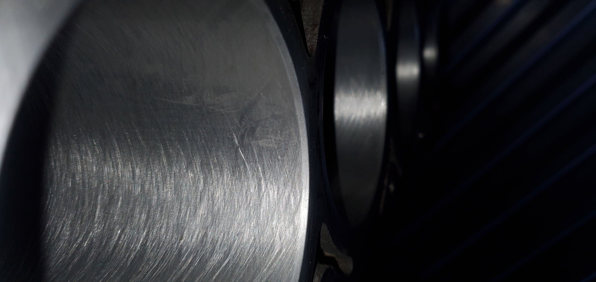

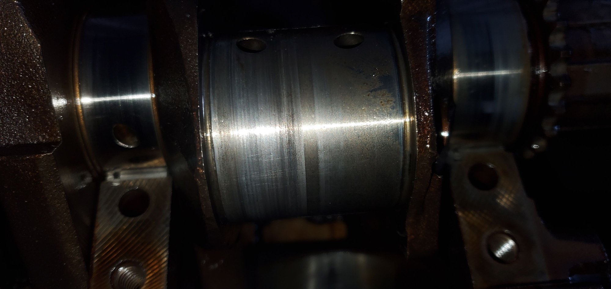

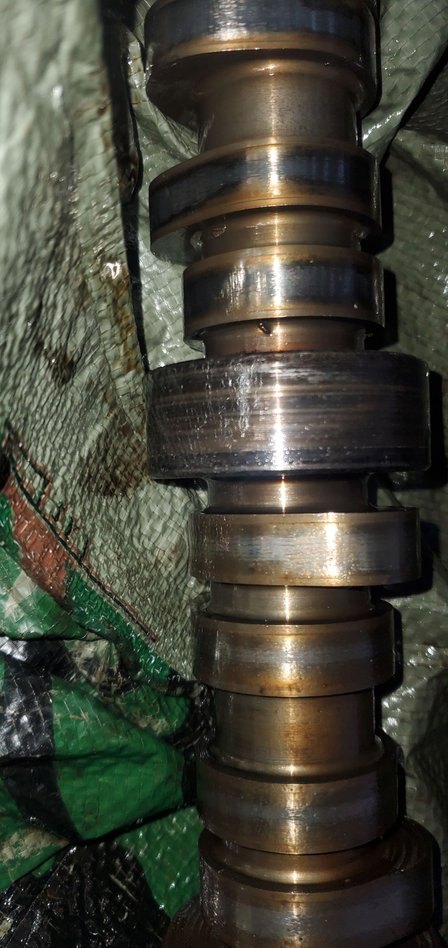

No progress pictures today, what was supposed to be a 30-minute cam swap turned into a whole day project of pulling the motor apart, the number 3 cam bearing somehow shrunk 40 thou and welded itself to the stock cam. Block didn't look damaged so I have some Durabond bearings on the way, hopefully the bearing didn't chew up the block, otherwise I'll have to have the block bored to match the diameter of the number 1 and 5 bearings. Very clear signs of oil starvation in the bottom end, but lifters, crank, and cam lobes somehow made it out alive and look perfect. At this point the motor has been stripped down to the block, I'm still unsure if the block will be going to the one machine shop we have in the area(which means extraordinary prices) or if I'm gonna install the cam bearings myself, I found a 3D printable install and removal tool so may give it a shot.
Phobos, the 8707 looks pretty similar to the sloppy stage 2 which is what I was planning on putting into this motor, it seems they're pretty close but the 8707 is higher lift.

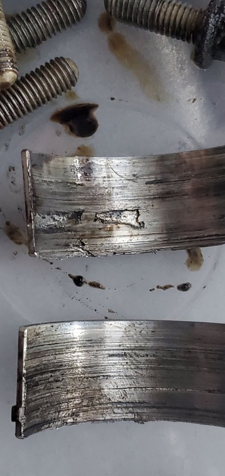

Here are some pics of the carnage:
Number 2 rod bearing, the only bad one, all the others looked like they could be reused. I have a King rod + main bearing set also on the way.
Apart from some discoloration, the crank has no scratches that I can feel with my nail, it'll get a polish and should be good to go, the bearing halves were actually fused together and had to be pried apart.
Number 3 cam journal, had to remove the crank and use a screwdriver and hammer to beat the bearing off, got into the rhythm of hit, turn 90*, hit, weirdly enough, cam journal also doesn't feel all that bad and could probably be used, it'll be joining my wall of shame with the cam bearing.

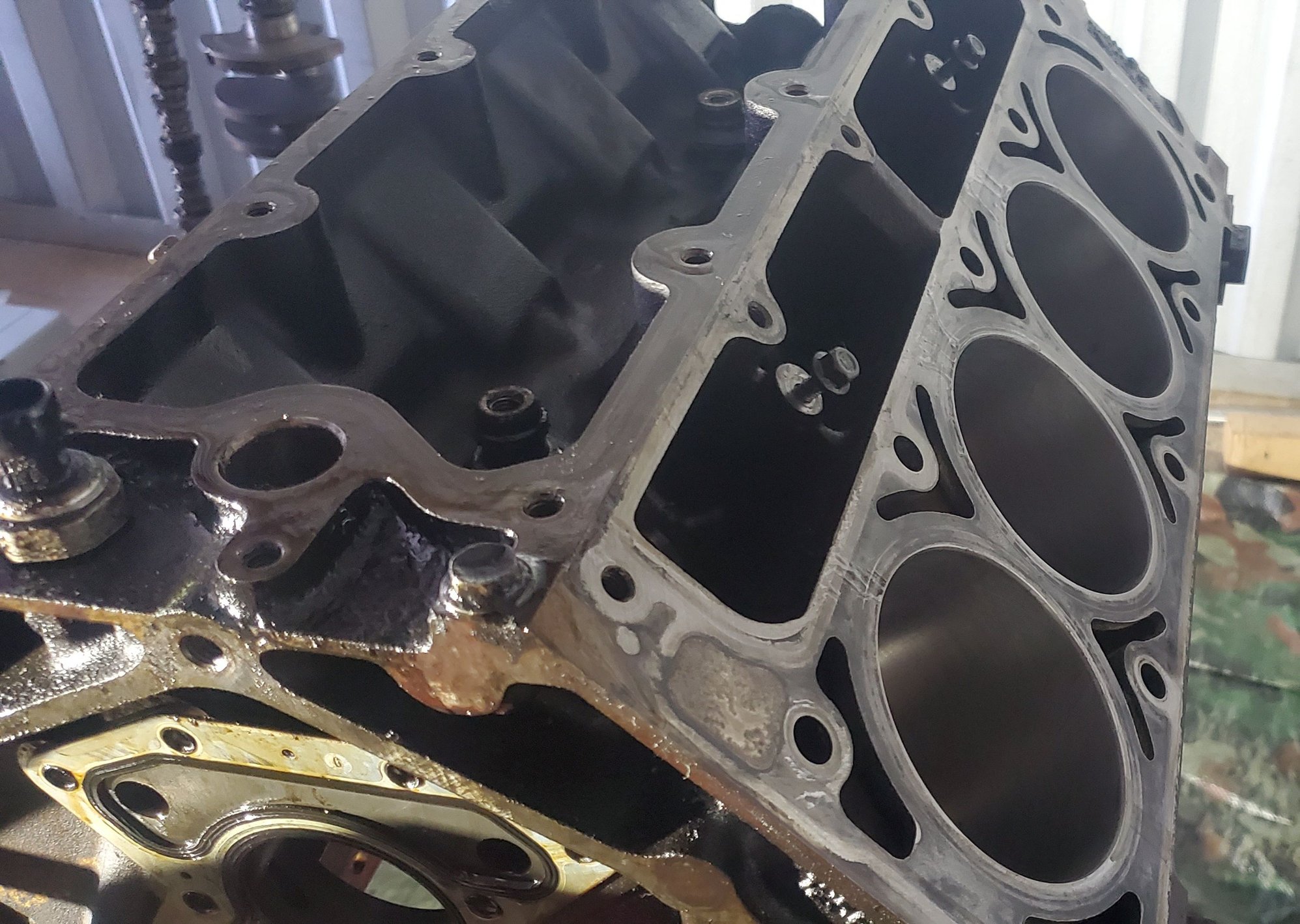

I hate to be the bearer of bad news but if that engine underwent oil starvation that destroyed some of the bearings, its very, very likely that little metal particles are spread all through the oil gallies and are inside the lifters. If you want the rebuild to last your going to have to proabbly get the whole thing hot tanked and get new lifters bearings etc. Otherwise your going to run a real risk of having your rebuilt motor take dump.
You could also just get another cheap pull out motor and roll the dice that its going to be in better shape, but don't just put new bearing etc... in that motor without cleaning it out and replacing the lifters that's just asking for trouble.

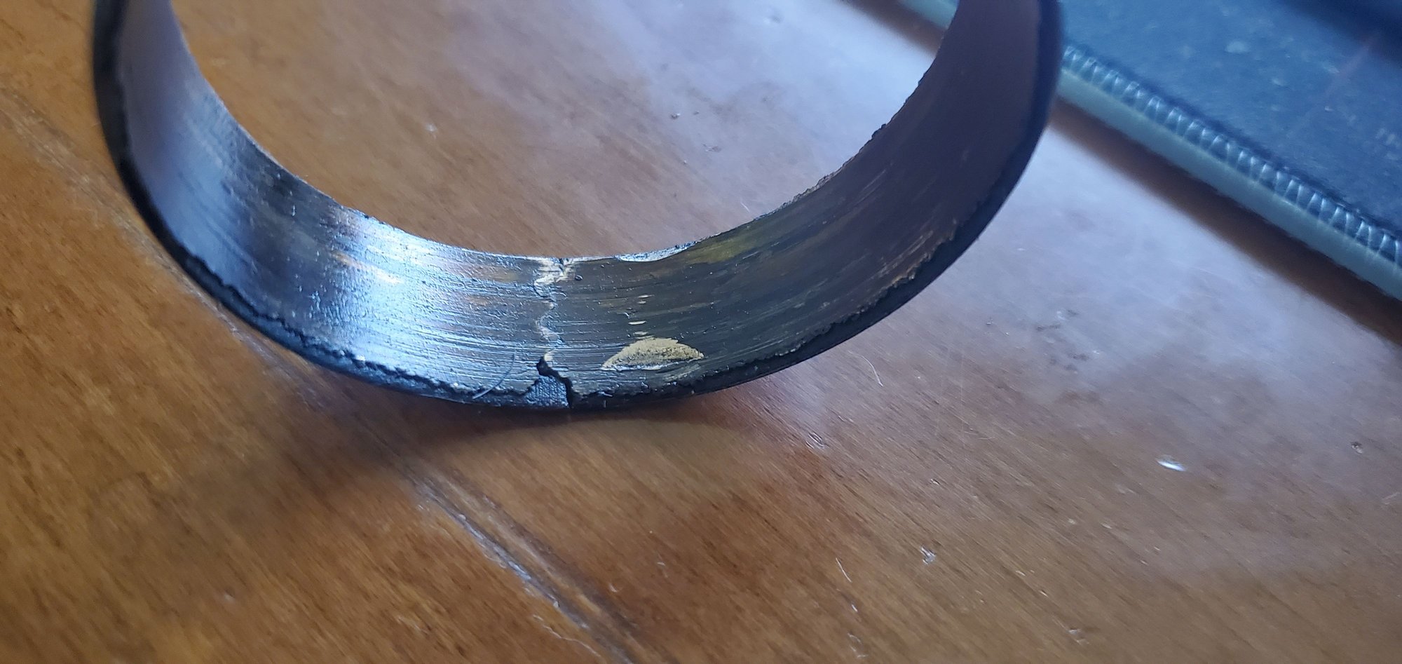

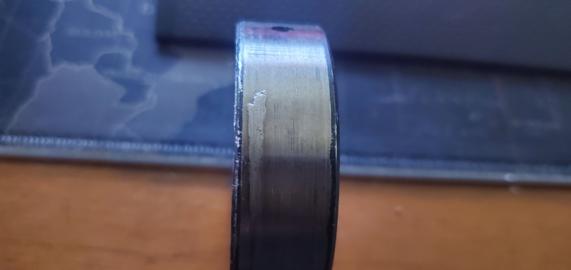

I hear you, machine shop quoted me $250 for hot tank and cam bearing R&R, which I will be doing assuming the durabond bearings don't just slide through the number three bearing housing.

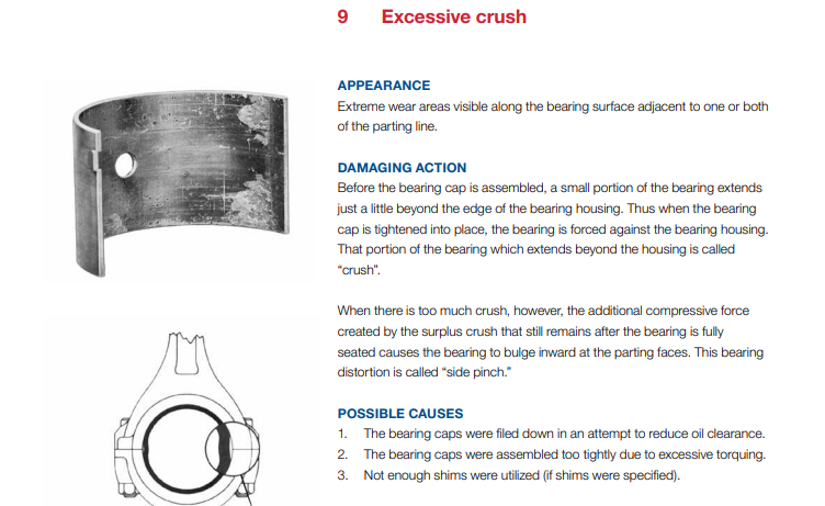

I'm not sure this was a case of oil starvation anymore, in the end, it really looks like a really bad rebuild where the failed rod and cam bearings weren't installed correctly. I thought all the "tearing" in the bearing was from where the bearing had fused to the crank, but looking at the back of the bearings, there's no bluing or heavy discoloration, hell there is barely any on the face of the bearing. Showed the pictures to my friends and they agreed, as did the Mahle engine bearing guide, here are the excerpts:
There is lots of metal migration from where the two halves meet, and this is the only bearing that looked like that, the number one main had hints of cold start damage, which is pretty common since it is the furthest away from the oil supply, but the rest of the bearings I'd feel very confident in reusing. The motor also has LS2 lifter trays and what look like brand new LS7 lifters in an early model year 05 Yukon (NCSA shows the VIN at 2004) which means it was definitely torn into, the lifter area does not have the hump of the later engines that fit the LS2 trays, the tell-all I believe is this:
That hit mark on the bearing surface should have resulted in a raised edge, measuring with my micrometer, it is almost perfectly even with the bearing surface in front of it.
On the outside of the bearing starting at that mark on the inside is this scar, I'm surprised I didn't notice this earlier and piece two and two together, I was pretty bummed about the situation so that probably clouded my thoughts.
Luckily I have the last oil filter from the engine, its a blue can of death STP filter, my personal experience with those filter is they drop oil pressure by 10 or so pounds. I rechecked the oil I drained from it, and while it was black, there were no shinies or metal particles in it or the pan.

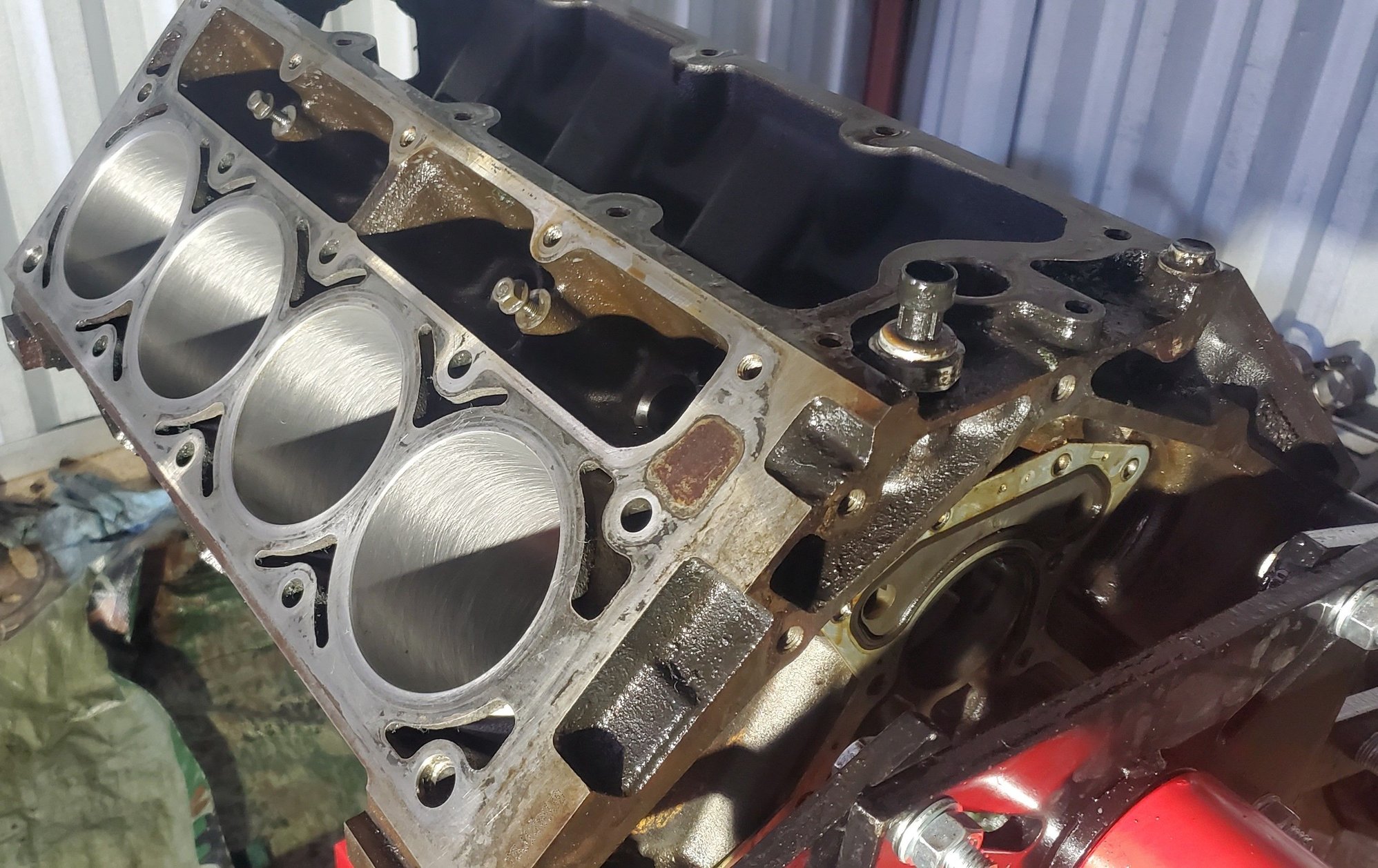

Parts are starting to come in, I have my rod, main, and cam bearings here and dear God did that number 3 bearing shrink, it's a difference I can feel holding them next to each other in one hand, don't even need to measure. Talked to a few machine shops not quite in the area and got some tips on installation, A few recommended some sort of bearing retainer so I got some Loctite 603, I don't think it will be needed but it's cheap insurance and peace of mind. I decided to just go ahead and call it an overhaul and ordered rings and coated flat top pistons, I'll be ball honing the cylinders since the crosshatch is just barely visible and I want to make sure the new rings seat well. Looks like the first 500 miles of this LS build are gonna be slooowwww.

Yesterday was pretty uneventful, I removed all the old cam bearings and practiced reinstalling them so I wouldn't mess up my new set. Unfortunately the first bearing I went to put in(#5) didn't go too smoothly, I am using an expanding bearing installer, and had two of the retaining bands on, one on the inner expander and one on the outer. Not quite sure how it happened, but the inner band somehow walked itself out from the setup and the outer die shrank as I was hammering the bearing in, not a pretty sight. Thankfully, the bearings are cheap so I still come out almost $100 less than the machine shop quote. I had to leave after that because of an emergency at home so Saturday was a waste. Today on the other hand I spent a couple of hours cleaning up the block, I ran a soapy water mix and then a water/lye mix through the oil galleys to hopefully remove any contamination and dissolve any aluminum-bearing shards that could be in there. I captured all the water from the soapy water run and rand it through a coffee filter to see if there were any metallic bits, and thankfully there weren't so I'm gonna go ahead and run the LS7 lifters I removed from the motor. Also got to flex hone the cylinders before my 3-hour engine work time limit ran out (9.5 total hours spent in the storage unit today, it's getting cozy), I didn't realize how glazed they were until after the first cylinder was honed, I ended up only doing 20 strokes per cylinder since the only available hone is a bit oversize, I am gonna rehone them all with 10 or so strokes since looking at the pictures the pattern seems a little too flat.
The flat-top pistons come in tomorrow, rings come in Tuesday and the head studs came in today, which means next weekend is final assembly weekend and hopefully a mock-up install by Sunday night. I can't work on the Vette on weekdays because of my work schedule, but the heads, rockers, and valve springs came home with me today, so hopefully, I can sneak them in sometime during the week.
