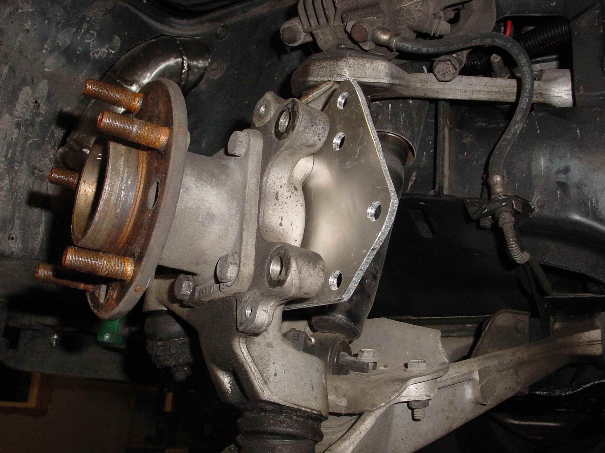

1985-1987 use the same geometry and will bolt on. 1986-1987 has the ABS sensor.
This is my 1984 and I think that there is enough meat to bore them out.
I made my own adapter that also use the hub bolts. This is with the prototype adapter. I made the real one from thicker aluminum.
