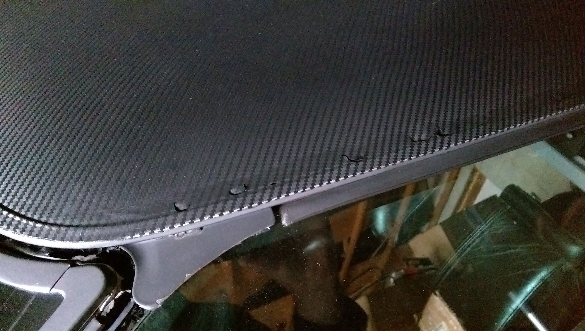

I'm going to vinyl wrap my top and trying to decide on the outside border. Initially leaning to trimming the vinyl flush to the junction where the glass meets the inside border of the metal frame. The other option is to wrap the frame too. Any experienced wrapper opinion?

Wrap to the inside border of the metal frame do not wrap the frame. I made the mistake to wrap the frame and it eventually started cracking at that lip joint due to the space / void left underneath where the frame joins the glass.

Thanks, that's the experience I needed.

added picture for reference
