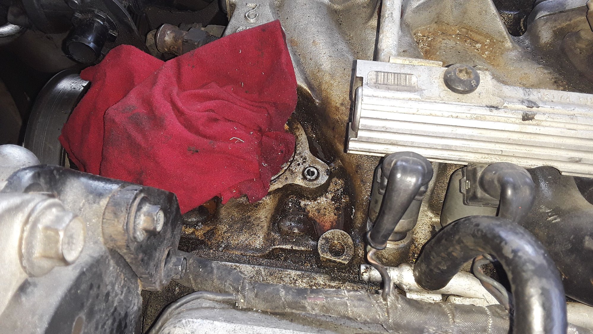

Ok I have a nice pilot hole completely through. Felt it come through the bottom. Should I tap this out for a 1/4-20 or continue enlarging and try to easy out it? I have everything to do whatever. Here's a picture.

id tap that hole and use a smaller diameter bolt with a washer.

thats not true. what I would do is tap the hole, screw in a screw, slide a nut over it from the top, weld it all together, remove the original stud.
but in your case, tap that pilot hole, use smaller bolt.
That's what I'll do. Thanks.

I'd want it back to stock, so I'd get that thing out of there. But....it'll probably work like that.

It's over. Broke the tap. I'm done. Scraping it.

No ones fault but my own. I took my time but just went one little turn too far. It's was done too. Had more than enough thread. Though I have been, as they say no use crying over spilled milk. Thanks again everyone.

A long shot, but can you back the tap out with needle nose pliers? Stick the tips in opposing open tap spaces.

I've made a mess of it trying to drill into it. Not sure if it can be salvaged.

Take the manifold off and see if there is a machine shop in your area that can EDM it.
