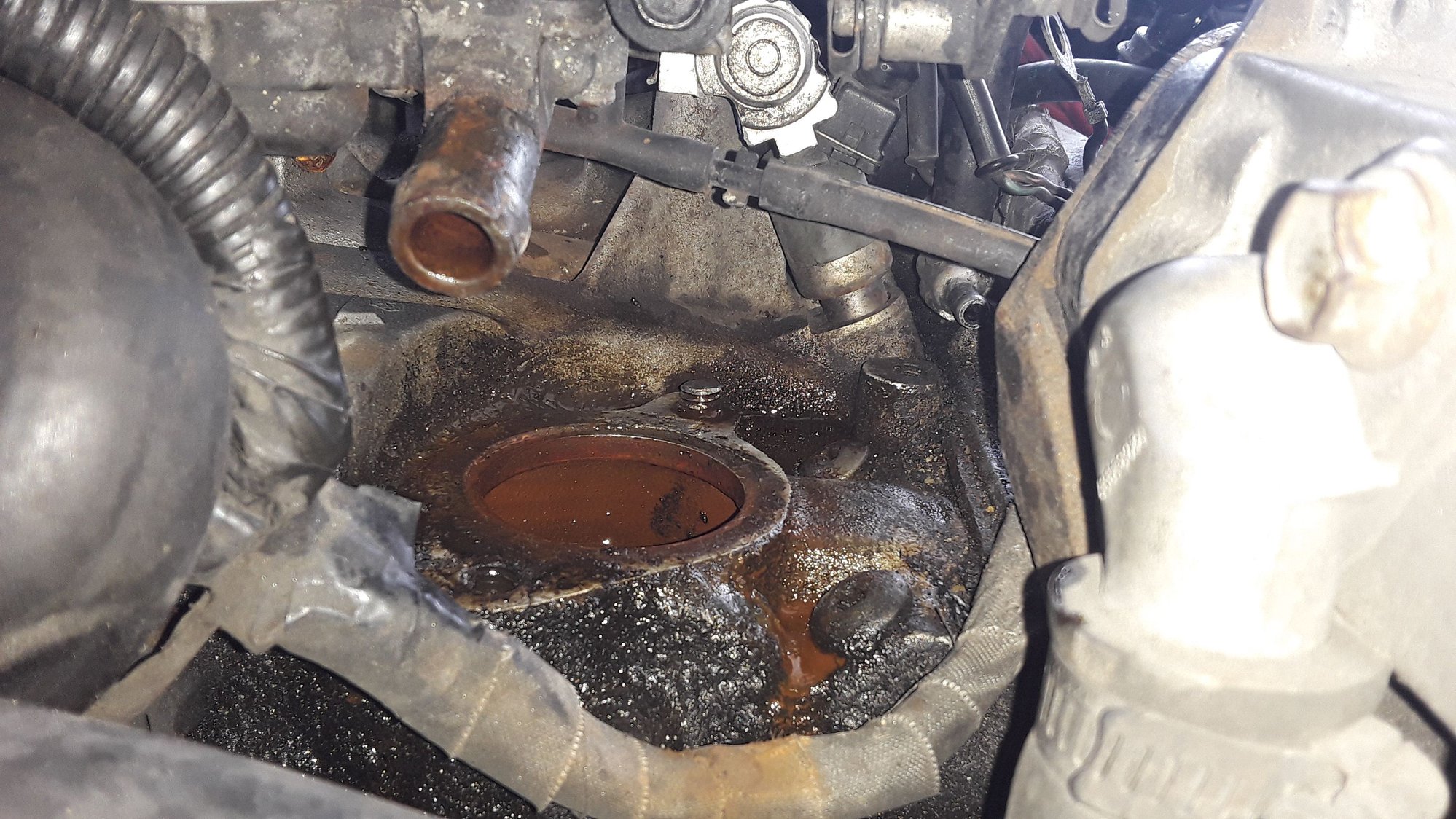

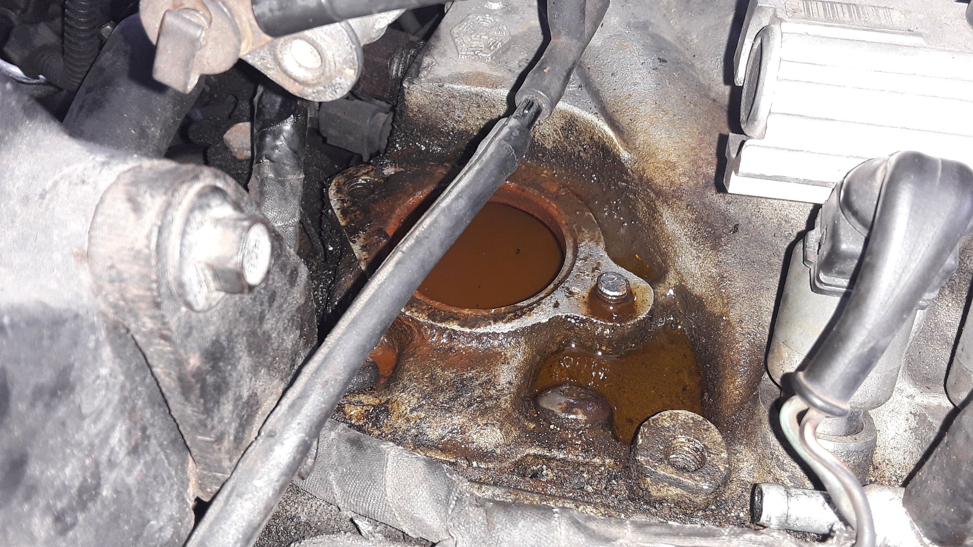

Noticed a damp spot under my 85 Z51 today. After checking I found it was the thermostat housing gasket. Of course one of the bolts snapped. Seems like corrosion from steel to aluminum contact. Looking for any advice to avoid removing the intake. Removing the plenum is about as far as I want to take it. Have about a quarter inch exposed with good threads. I have some ideas other than helicoil. Wondering what you can offer. TIA.

Try welding a nut onto the stud. Ive done that with exhaust bolts on aluminum heads with good success.

I would heat the AL with a Micro Torch ( Harbor FRT) and hit it with CRC Freeze-off. Hit the bolt with a brass bunch and repeat the heat cycle - freeze-off . I would do it a few times and use 2 thin nuts jammed together on the stud to take it out.
Use FREEZER Aluminum foil to block the heat from other parts. (it's thicker)
Last case is to drill and tap. Likely one bolt size larger.

This works. It works every time. Heat works, welding a nut on, to give you soemthing to to turn it with, also works. Earlier tonight, I removed 4 broken off exhaust manifold bolts from a Chevy truck at work, with aluminum heads. I welded nuts on all of 'em, and then threaded them out of the heads. It works.
If you don't have access to a welder, giver 'er hell with a pair of vice grips, and HEAT the intake around the bolt hole, with a propane torch. HEAT it. HEAT works. Use HEAT and the bolt will come out. HEAT.

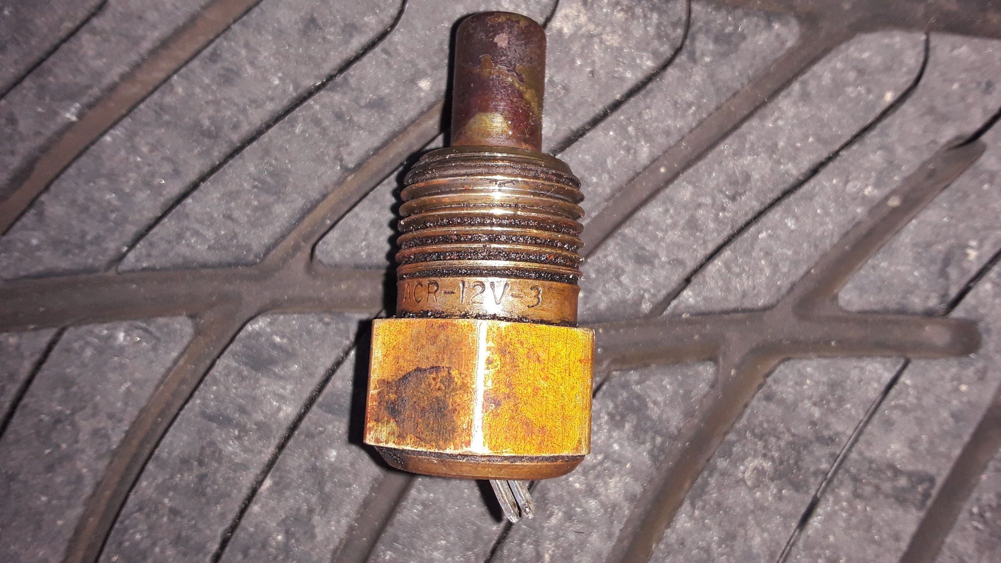

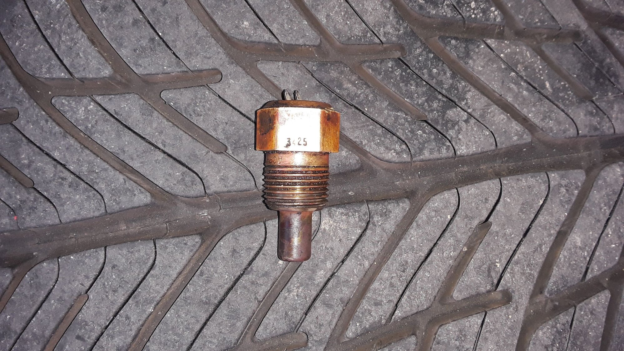

Well I just don't have a torch that is going to be sufficiently to it up. Probably going to install a helicoil. In the mean time I managed to break a switch/sensor and I'm not sure which type it is. Check my FSM but still can't figure it out. It's the one in front directly under the throttle coolant hose fitting. 3/4 diameter, 2 wire. Here's a couple of pics.

joe thats the coolant temp sensor. cheap.
i strongly, STRONGLY, STTTRROOONNGGLLYYY advise that you find a guy with a mig welder to come weld a nut onto the stud.
dont drill it and heli it. $50 and im sure there is a guy local who will do that for you.
