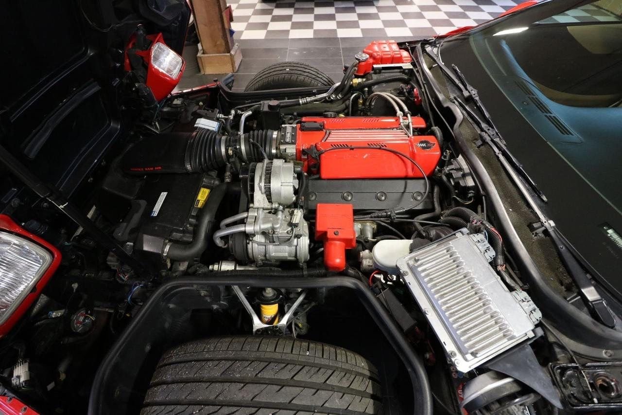

Hello, I want to know if this is good upgrades done on a 96 corvette and if it’s reliable for the engine.
ENGINE:
lt4 hot cam
1.6 roller rockers and comp cam chrome moly pushrod
52mm BBK throttle house
electric water pump
gm high performance cam chain kit (lt4)
adjustable fuel pressure regulator
smaller underdrive pulley
ported maf sensor
vortex rammer cold intake
big mouth on the intake
extra oil cooler for automatic transmission
new cooler
new ac cooler
new ignition cables
bigger spreaders 30 l/s
headers tpis long ceramic coated
lt4 knock module in the ecm
CHASSI:
c5 brakes Baer extreme kit
z06 chrome wheels with Avon tires
Koni adjustable Schock absorbers
coarser anti roll bares with polyurethane bushings
All bushings on polyurethane bushings
Rear polyurethane bushings
New gearing to 3.73 from 3.07

First, please tell us how you plan to use the car and what your goals are. We can't really answer your questions without that info. The only thing I can tell you for sure not to do is the regular hard poly rear bushings. They will introduce bind because the links all have to move in more than one axis. They are fine for the front suspension and swaybars, though.
Others can chime in, but I think some things you listed that will make little or no difference are"
52mm throttle body
ported MAF
Vortex rammer cold intake and big mouth
Not sure if you need the bigger injectors with just the Hot Cam upgrade.
As far as I know, changing the knock module doesn't do anything for performance.

I’m planing to drive the car in the summer when I’m free but not as a daily driver. And I wasn’t clear whit the thread, the car has already the upgrades, I’m planing to buy it but I’m not sure if it’s good with all that upgrades and if it’s reliable.

Okay, I don't see anything that would make it unreliable. The underdrive pulley might mean it doesn't charge well at idle (I'm not sure). I'm also not sure how reliable that electric water pump is. I wouldn't pay a premium for the car just because it has those upgrades, either. The cam, gears, and headers will add to the acceleration fun. The Konis are nice shocks and their adjustability can help you get a nice ride or a stiffer, more performance-oriented ride. The rear poly bushings won't make the car unreliable, but they do create a bit of non-linear oversteer due to bind. They just aren't a good idea for these cars, but they aren't something you should rush out and change, either. By the way, if these are not regular stiff urethane but are instead the more pliable, purple SuperPro bushings, then that's good.

I agree with Matt. I'm doing a build on my '96, so I've done my research
52mm TB, no...might affect driveability (why I'm sticking with the stock 48mm)
I don't think you need an adjustable fuel regulator. From what I understand the pcm controls it on a '96
no on the under drive pulley
I wouldn't mess with the MAF and the air intake is a waste of money on a '96(very good flowing system)
With the money you'll save by not getting the parts above, I'd get a torque converter and the pcm tuned or dyno tuned. Oh I forgot spend a bit more and get Superpro bushing kit(somewhere between rubber and poly bushings)
Another good avenue for your build is to contact Lloyd Elliott, he is the LT1/LT4 guy in the know. He can guide you with a possible custom cam, tell you if you need the 30lbs injectors and recommend a stall on the TC (the high end units = yank or vigilante = $900+)
**I guess I should've read the post better....but you can get ideas from some of the info**

It depends on the mods and how much the PCM and sensors can account for the changes. If it's heavily modified it won't really run at all. The one you asked about is not heavily modified. I'm sure it runs. The question would be whether it's getting all the potential out of these mods. I believe I've seen others say that the hot cam by itself does not require tuning. The headers by themselves or in combination with the hot cam probably don't, either. The one change that would make me wonder is the different injectors. But like I said, if it runs well and isn't setting any trouble codes then it's probably okay.

This is the one, the dealer guy said it’s have about 400hp

I think 400hp at the crank with those mods is very optimistic. It might - might - have 350hp at the crank on a really good day. You can always put something back to stock. Except the suspension bushings: you can't buy stock rubber ones anymore, but you can always get SuperPro which are similar.
