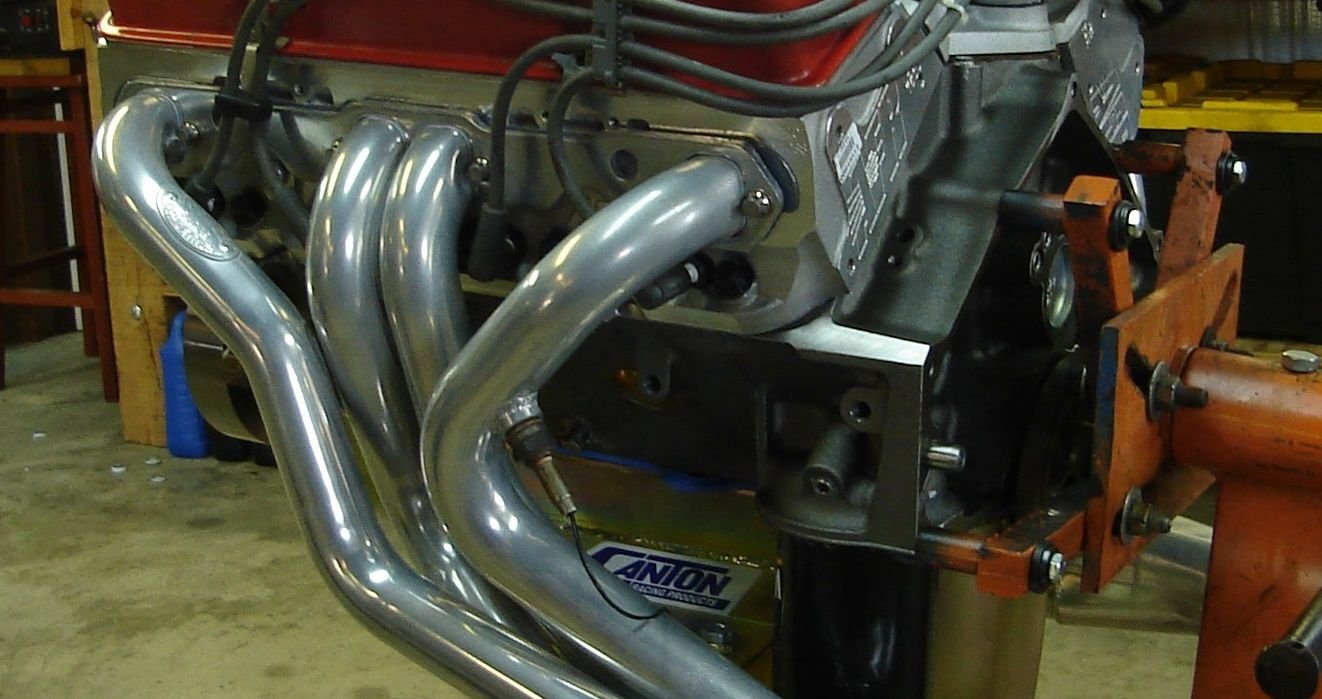

2151-1 hooker... great plug access,, one O2 bung

Why is the O2 bung in the #7 pipe? How does that measure all the left side? Looks like they "ghettoed" it on
